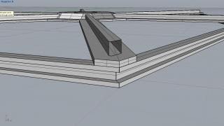

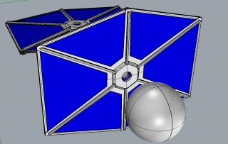

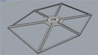

In the meantime, I decided to continue research on my TIE wings. Rob, (dsp5500) kinda nudged me to use Rhino for cad drawing. I'd been having a tough time using AutoCAD. Anyway, so for the past 6 hours I forced myself to learn Rhino. Here is my progress so far. I'm building all the plain surfaces, including the different Plastruct beams.
Below is my first 3D drawing ever! I'm quickly realizing the power of such a tool. See, I like saving money where I can. This way I can study things before I make my cuts.
The first thing I tested was figuring out the height of the raised center hub. It took about 30 minutes and I had the height measurements and templates for the side walls. I'm happy to say that all the kit parts fit perfectly in them!
Please excuse my enthusiasm! I literally needed to rip myself away from my PC before I pulled an all-nighter!
NOTE: I did not create the original specs, they were given to me, so I can't share them. I just created the 3D model from them. I did scratch build the H-Beams and the solid 3/16" beams on top of the wing stars, though! That was all me! :happy

RE: Joe's ANH TIE Fighter - joewhite - 02-26-2013
Thanks guys! I don't know why it's taken me this long to learn a 3D program. Just in that one session, I've already answered many of the questions in my head regarding the assembly of the wings. Of course, many more questions were brought up but that's the beauty of it! In a perfect world, there'd be a Plastruct store down the street where I could easily get all my material. But with oil prices and shipping, I can't afford to make bad cuts.
I regret that I can't share any templates. I'm thankful for the help and I gave my word that I would not share it. However, I can definitely share the drawings I created from scratch before I got these dims. They are not accurate but are a good start, imo. The wings really aren't as bad as I imagined two years ago when I started gathering info. You can figure out the measurements really quickly if you lay the parts out correctly.

I'm pretty much done with the wing. You can't see it in my screenshot but both sides of the each wing are there.
And, here's on of them questions that came up after all this. Now, keep in mind that I don't have good reference of a TIE from ANH. I couldn't get a good screen shot in Rhino so I drew the following by hand....not to scale of course.
So here are some of the layers. I'm coming up with a .060" empty area in between the wing star and the layer of Koolshade. The ABS H-beam #H-8 has a wall thickness of .060". So, do the wing stars sit on the H-beam? Or are the H-Beams cut at each intersection so the wing star arms can sit in between.
Cutting the H-beams at each intersection makes the most sense but without ref, I'm not sure if it is accurate.
