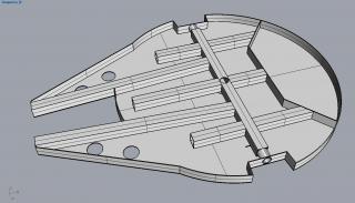

Joining the 32" Falcon club - joewhite - 04-15-2012 I've been on a time crunch with just about everything lately. I leave on a 3-month business trip next week. If you've seen any of my other builds, you'll notice that I make and use laser cut parts. Unfortunately, this weekend will probably be the last time I get to use the cutter. It's been a good three years! :cry Soooo....I decided to hurry up and get the basic shapes of the Falcon cut before my trip. Mission accomplished! Man this thing is huge!!!! ![]() I used Joshua Maruska's drawings, imported them to the program I use and made vector templates from them. As with most Falcon builds, I'm taking a different approach. Due to the table size, I had to break the body up into three parts. It's ok, though. If it doesn't work out, I'll just have to cut a new hull by hand. I also incorporated a few guide notches for some parts. Oh, and there are 38 ribs in all! To tell you the truth, if I could have only done the ribs, it would have still been worth it! Call me lazy, it's ok! :lol All in all, I used one 72" x 24" sheet of .060" styrene (cut up into 24" x 20" pieces) for all the parts. PM me if you would like a copy of the cutting file. I have to warn that although I have spent a lot of time on these parts, there may still be some errors. I think it's a good start though. BTW, I can provide drawings with and without the 3-part body. ![]() Oh, and I misspelled Joshua Maruska's name in the preview above. I'll correct it later. Joe RE: Joining the 32" Falcon club - JAWS - 04-15-2012 Ok you definately have more builds on the go than I do now Joe. Nice to see though. Great template youve mad up too buddy. We need more work like that being shared or distributed. RE: Joining the 32" Falcon club - joewhite - 04-15-2012 Hehe! I wish I could concentrate on one thing and see it all the way through but I haven't had any time at all. I'm hoping the Fall will bring some more model making time. And thanks about the templates. But the real thanks goes to Maruska....whoever he is. His drawings are crazy awesome! They just needed a little extra work to make the ribs and such. BTW, I wouldn't have ever dreamed of building a Falcon had I not seen Phil and Cory's builds! Phil also gave me some good advice. Thanks guys! Joe RE: Joining the 32" Falcon club - Wombat - 04-15-2012 Thats a really nice thing to offer the community here, good stuff, Joe! Enjoy the build when you have the time, for a SW ship it ain't half bad this one.. LOL RE: Joining the 32" Falcon club - kbilly - 04-21-2012 I'll be following this thread for sure! Look forward to seeing it come together. RE: Joining the 32" Falcon club - joewhite - 04-21-2012 Thanks, k! I gotta say, all them awesome builds out there did inspire me, without a doubt, but your superb id'ing skills worked it's magic on me as well. Without your contributions to the community, I probably wouldn't even have imagined attempting this build! I hope to bring it! I've got a few months to plan my next move. BTW...go Spurs! Joe RE: Joining the 32" Falcon club - joewhite - 02-15-2013 Frank, thanks for returning the motivation to dust off this project. Not much to look at still but here's what I did the last two days. Luckily my plate is less full these days....hopefully for a good while. I don't have room in my current house and may have to build a carrying case for this as well due to me having to move every few years (military). Nevertheless, I got the itch to continue with this so here is my recent progress. Here are most of the parts for the basic body. About 70 parts will make it up NOT including the 1-inch sidewalls and inner support located in the middle of the pic. Not pictured are the mandibles and the 1-inch square and round aluminum tubing that will make up the armature. These parts alone have already given me an idea of how much this thing could potentially weigh! I'm shooting for under 25 pounds if I can help it! ![]() Here you can see the way I designed the hex tunnel boxes. The increasing side angles on the three ribs follows the curve of the hull. I calculated the crap out of this area! Hopefully it'll save me time like I envisioned and not bite me in the butt! ![]() Again, not much. However, between Frank C's build and his comment about how most builders stop after the drawing phase, a fire has been lit under my ***. Let's see how long it stays lit, job permitting! :lol Joe RE: Joining the 32" Falcon club - Tsophika - 02-15-2013 Cool! Now, how can I convince you to put that effort into a 5' version? RE: Joining the 32" Falcon club - joewhite - 02-15-2013 You'd have to give me a brand new laser cutter! LOL! No, but, wait.....my friend has a giant CNC routing table at his work. If I can convince him to cut a 5' hull......hmmm! I think I will be looking at those 5' blueprints now. Realistically, though, I'm not sure if I could hunt down all those donor parts for a 5-footer. I have a bunch of them but not all. Dammit, Craig, you've got me contemplating it already! ![]() Joe RE: Joining the 32" Falcon club - daverep - 02-15-2013 Nice! This is my next step this weekend if I can get a few hours. Look at all of those clean lines! I'm so jealous! ![]() I guess when I get the chance, I'll start a thread too. Found the 1" aluminum tubing at Lowe's. Good call...it was just over $11 for a 3' section. I'll be in touch! -Dave RE: Joining the 32" Falcon club - joewhite - 02-16-2013 (02-15-2013, 11:27 PM)daverep Wrote: Nice! This is my next step this weekend if I can get a few hours. Look at all of those clean lines! I'm so jealous! It's not all clean, Dave. See that tear in the styrene in the last pic...hehe! I got over anxious when I was popping it out of the sheet! Cool about the tubing! I was under the impression that they only sold it in 8-foot lengths. I'll also be making a Lowes visit this weekend. I was going to go with round styrene for the mandible lighting tubes but if I find a good substitute at Lowes, I'll do that. Right now, I need to think about all the maintenance holes around the ship. I'm trying to figure out if I need to build those first. The mandible holes will definitely be attached before the top and bottom plates come together but I still need to get the proper circumference and depth first. Joe RE: Joining the 32" Falcon club - daverep - 02-16-2013 I got some 1" piping while at Lowe's. I had thought about getting some square styrene tubes from Plastruct or US Plastics, but figured I was already at Lowe's and it was probably cheaper just to do the 1" pipe from them. I'm also at the same place on the maintenance holes. Trying to figure out how deep as well. I want to work on those before I skin the top & bottom. I was going to try and match up some kit parts with the ref photos in order to figure out the depth, but I'm missing some important donor kits to be able to do that effectively. I wanted to cut into the ribbing I've done in order to use those as support for the wells. Might email you sometime this weekend to run an idea or two by you. So, fair warning! ![]() -Dave RE: Joining the 32" Falcon club - joewhite - 02-16-2013 I'm down, Dave. Email away. Oh so you got round tubing. OK, maybe I am still correct about the 8-foot square aluminum tubing. That's what I saw online for about $30 or so bucks. Joe RE: Joining the 32" Falcon club - daverep - 02-16-2013 (02-16-2013, 02:09 AM)joewhite Wrote: Oh so you got round tubing. OK, maybe I am still correct about the 8-foot square aluminum tubing. That's what I saw online for about $30 or so bucks. Sorry...my post WAS a bit confusing. My apologies. I actually bought both. I got the 3-foot, 1" square aluminum tubing for the body and the 1" pvc pipe for the mandible lighting tubes. I was thinking the square styrene tube would give me better bracing on the mandibles, but I plan on glueing it in, so I thought it wouldn't make a difference if it were round or square. I might add some supports to the pipe if needed. -Dave RE: Joining the 32" Falcon club - joewhite - 02-20-2013 So, I went down to Lowes and bought some aluminum square tubing. Had to return it though. I wasn't thinking of all the extra work I'd have to put into it to cut and drill holes. And naturally it adds more weight....I thought I could live with it but it was a little heavier than I imagined. I was going to drill a bunch of holes to lighten the weight but I decided to order some plastic square tubing instead. It sucks how the plastic stuff is slightly more expensive than the metal....oh well. I know ILM used round tubing for the mandibles. Has anyone used or thought of using square? I was thinking that it would serve as the inner mandible sidewalls as well as inner support and lighting access. Joe RE: Joining the 32" Falcon club - kbilly - 02-20-2013 You need to consider the mandible wells, I remember someone saying that the end wells are boxed to go around the internal tubing. RE: Joining the 32" Falcon club - joewhite - 02-20-2013 Yeah, I was looking at that. Going square will shave off .060" by eliminating the wall. It's not much but kinda helps. Building it with a wall, square or round tubing brings the tube very close to the forward wells. I did feel that the wells would barely fit round but barely. Hmmm, so was only the side facing the tubing boxed? I also don't see why the tubing couldn't be altered. Looks like I will have to research them wells a little more. Joe RE: Joining the 32" Falcon club - daverep - 02-21-2013 I have my aluminum tubing. If I get the chance tonight I can maybe check mine using the aluminum tubing. 1" is 1"...shouldn't make a difference if it's aluminum or styrene I would assume. These wells are giving me fits as well...and the docking tunnels...and just about everything else so far! HA! RE: Joining the 32" Falcon club - joewhite - 02-21-2013 Looks like I may have some bad news! I hope not but I think it may be true. I'm coming to discover that the Maruska files may be off! I slapped together some of the port mandible wall parts. Now, they aren't in their absolute correct position vertically, but the horizontal spacing is really close. The last pencil line on the left side, underneath the Gepard gun, is the tip of the mandible. I measured 13 1/2" inches from that line to the left edge of the Porsche engine part. A little longer than the MR Falcon mandible measurements. I think they measured 13 1/8". So I was pretty close considering I took measurements from some of my unmodified parts instead of tacking them on to the test strip. So, it turns out that the same length of mandible on Maruska's drawings only measure 12 1/2"! Dammit! From the tip of the mandibles to the back of the ship measures 30 1/2".....a little shorter than the Studioscale.com plans which measure 33.74". This sucks! I apologize to all those who are using the plans I made but I used the source material which were known to be reliable plans. Someone please correct me if I am wrong! Joe
