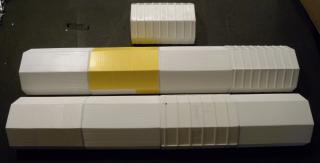

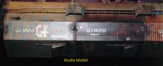

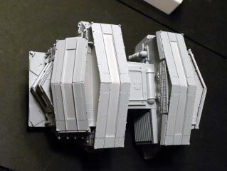

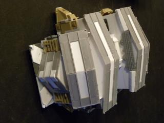

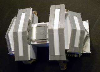

Hey Guys,
Started on another Studio Scale project. Figured I'd try to tackle this little beauty.
All 16 containers are being built from scratch, using the same kits the studio did (Reefer, Moving Van, Container, Post Van). I've even been matching them up on the sides to the rivets. It's been a lot of fun, can't wait to get them painted and weathered.
Started on the head section as well. Most everything is fitting exactly as it should to the studio miniature. I'm still adding some greeblies here and there, so these are not the complete parts yet. All in all, it's coming together pretty well. Substituting some greeblies where I can't ID the parts where needed, just to speed this thing along.
The last pic is of the studio miniature as a comparison.
More to come...
-Sean

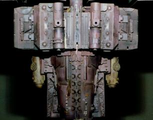

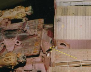

Here's a nice shot to show what the original filming miniature looked like, and all the fun greeblieage on the head. I love the colors on the containers too. Way more subtle than that awful color scheme on the new show GF.
-Sean

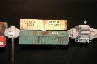

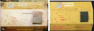

Hey Doug, I'll give it the same lovingly weathering I gave my Colonial Movers... Smile (See attached) I love not only making it dirty, but matching almost speck for speck the dirt, spatters, grime, etc.... That's the most fun part of these ragtags for me.
Yeah, I need to look at my specs, but it's around 34-36" in length.

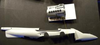

Anyone recognize this part by chance?

The weathering on your CM is amazing. I'm tackling that build myself right now but have a long way to go before getting around to weathering. I agree on the challenge of "smudge for smudge" weathering duplication. I did my best to do so on the BSG shuttle and Raider. It's very tough to get right...and those were simple in comparison to these guys.
-Doug

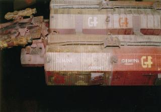

RE: Gemini Freighter Build - t2sides - 08-28-2012
Thanks guys!
Small progress update. Finished all but one of the containers. I'll plan to paint them all individually, then assemble them. Getting ready to tackle the engine section, that should be fun!
-Sean

While looking through kit scans for things for the G i noticed this part from the Airfix 1/600 Scharnhorst.
[attachment=12112]
Can't tell if it's like one of the part's you are looking for or not though.

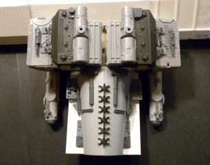

RE: Gemini Freighter Build - t2sides - 09-05-2012
Hey Guys,
Thanks Phil for that reference, looks pretty darn close, I'll look into that more!

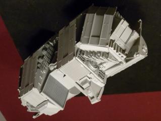

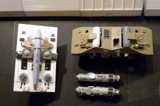

Here's another update. Making progress on the engine section. I had to use a couple sub's for original parts, but most of them are correct to the filming miniature. I'm not planning to light the engines, will use a reflective tape similar to what they did. I still have to add the styrene strips on the inner engines that cover the seam from the railgun parts, and have a few more parts (like radiators) to add to the engine section.
The last two pics show the updated head section with the crane parts installed, and the part of the harrier that was cut out to make the main head body.
Cheers!
-Sean

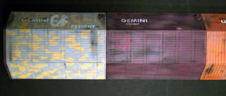

Here's a brief update. Most of the engine section is now done, and got started on the starboard side containers. Still have some more weathering/filtering to do then clear coats, but it's starting to take shape.
-Sean

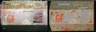

RE: Gemini Freighter Build - t2sides - 09-22-2012
Thanks Guys!! Much appreciated!!
They look so much better in person, the colors are really blown out in the photos. It all looks much more subtler.
Phil, yeah, I used the liquid mask approach to that container. Based on their paint patten, I'd guess they did about the same. The effect turned out really cool.
Mike, there are a lot of different things going on, but in a nutshell, my approach on the containers is:
1. Base coat
2. Weathering with chalk pastels (softer dark spots)
3. Oil wash/dabs (darker spots or filler areas)
4. Dry brushing (highlight rivets, raised areas, etc...)
5. Blotting (adding paint chips, scratching)
6. Filters, very thinned colors and airbrush mist over certain areas more than others.
7. Some more pastels
8. Clear coats
I'll try to get some new pics outside shortly, hopefully it'll show the colors/weathering more true.
Thanks you guys, this is such a fun ship! I am making it match the 'intent' of the original filming miniature, so I don't drive myself nuts trying to make an 'exact' replica. It's made it much more fun.
-Sean

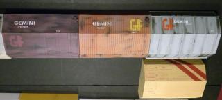

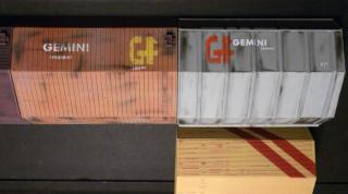

RE: Gemini Freighter Build - t2sides - 10-01-2012
Hey fellas, small update...
Got the containers mostly completed. Still have some detail painting and weathering to add, as well as the detail decals. After that, I'll be putting each 'row' together, and adding the C-Channel and painting that the base color. Last pic are the Roco tanks that still need to be painted and applied to the containers. But, it's coming along.
This has been one of the most enjoyable BSG replicas's I've had a chance to build so far. I love all the different containers.
Thanks for looking!
-Sean
