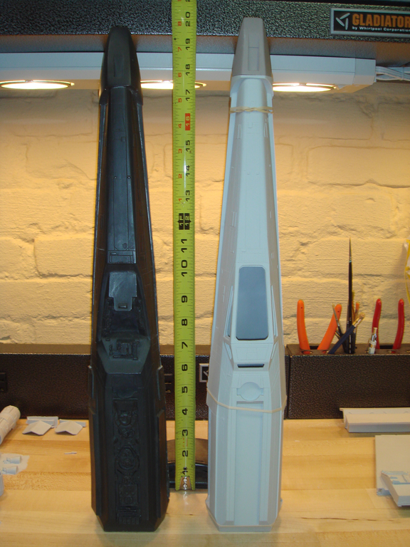

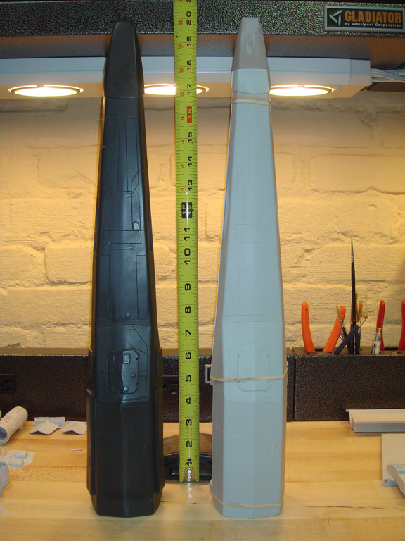

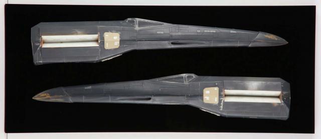

1/24 Hero X Wing Build with Maxi Brute Fuselage - PB BB1 - 11-23-2009 The X is iconic, no doubt about it. To me the ANH X is the X wing. A shame as most have been abused or partly modified. I hope to pay proper tribute to the original builders of these fabulous miniatures. It was rumored the Estes Maxi Brute fuselage had been vac-formed over an original. However, when held it is immediately apparent that this is not the case. I wish it was too, but further research reveals it was built up from scratch. The master pattern for the Maxi Brute back plate, droid strip and a segment of the fuselage can be found at the SWCA: http://theswca.com/index.php?action=...&item_id=59028 Seemingly no direct lineage to the originals besides the claim on the box... or is there? Have a look at pages 10 and 11 of the 1977 Estes Christmas Catalog: http://www.ninfinger.org/rockets/cat.../77estxmas.pdf Obviously the writer has taken a few liberties but this does establish some lineage. Estes staff did go there and handled the models. There is even a tiny photo of a "Wayne" measuring a Y Wing and a Charlie Webb credited for taking over 500 photos. Now there is a portfolio I'd like to see. The Maxi kit comes with a wing blueprint that measures out to the size of a Hero wing. The cannon depicted is dead on to all of my studio reference as well. My hypothesis is that the kit was made from a set of measurements taken during the visit. This build begins with the engine master from the Phantom II engine cut and recombined, with panel lines added before gluing. This dark green plastic is from the 1976 release of the Phantom kit, and can be brittle. Speaking of brittle plastic, I have had terrible luck with the landing gear bits from the whitley. The one at the top was removed from another master in 6 pieces and has been reassembled. It is difficult to see in the photo but the detail is now a bit rough from the repair. Even Tenax couldn’t save this one… off to ebay for another and grabbed up the elephant kit required for this build from the same seller. Not sure if it was a result of packing but 1 of the 2 from the new kit was also broken. Gluing this one back together was a piece of cake, though. ![]() Also began construction of the strip that goes behind R2. I paid special attention to the Hurricane bit. If you have ever seen the kit-part you know that it does not sit flat; with a gap for another part that continues the raised border along the edge. The ILM droid strip looks to have some filler in there. I wanted mine to sit flat on the Scharnhorst deck so I used some bits from the Hurricane to approximate the shape of filler on the original. ![]() Getting the droid strip right was a PITA. You have to cut the sides off, drill out the raised circle, but leave the lip the thickness of the rest of the raised borders. I backed the entire thing with styrene but added an extra slice under the Hurricane part so everything sits flush... can't have any undercuts if its going in rubber. ![]() Its a start... RE: 1/24 Hero X Wing Build with Maxi Brute Fuselage - JAWS - 11-23-2009 Kool mate. thanks for droppin in with your XWing build. I nearly bought a Maxi Brut. I think I might see if its still available. This is going to be a great build thread. Cheers mate. RE: 1/24 Hero X Wing Build with Maxi Brute Fuselage - 427 Cobra - 11-23-2009 The Maxi-Brute models' fuselage was directly recast from a reassembled pyro model,and not scratch made. Which one is still unclear. This was confirmed by Estes themselves through the original owner of this forum a couple months ago - August,maybe? There were however,some parts that weren't recast from the original. This would explain why some,if not all of this is the exact same size. There was a model of Red 3 that was featured at the Hard Rock cafe that was purported to be from Star Wars,but it was just an ICONS model that was painted,and modified to look like the original pyro version. Your links don't work at this time. I keep getting error messages. The other photo doesn't show up at all - it's just a red X. RE: 1/24 Hero X Wing Build with Maxi Brute Fuselage - PB BB1 - 11-24-2009 Can you point me in the direction of that material? I understand the Icons was derived from a Pyro, but I see no visual evidence that the Maxi was... if anything it looks to be based on the first X Wing made, Red 2. It has a slightly fatter nose and short turkey feathers. There is even a wing diagram that measures out to the size of a hero wing included with the rocket. EDIT: Perhaps I exceeded photobucket's free limit? Photos look okay for me, let me know if you still can't see them. RE: 1/24 Hero X Wing Build with Maxi Brute Fuselage - 427 Cobra - 11-24-2009 I don't know if it was Red 2 or Red 3 reassembled from what was left of it,but Estes did recast one of the original ILM models for sure! The ICONS was purportedly made from scratch according to a 3-D modeling program. This wasn't recast from any known source. The story was that the Maxi-Brute was recast from a pyro model that was preserved in a box in the archives,but never saw the light of day after Estes was done with it. I heard that one of the ILM modelers put it back together for this recast,but nothing ever happened after this session. This was a while ago,so I don't know who it was that my source got this information from was reliable enough,or not. I read that from someone else on another forum chatroom as well,as my un-named source. I believe it to be true. There's a lot of speculation about these models,but no one has come forth with any useful information other than what I just posted here. We all know that the original ILM models were kitbashed,and scratch built parts,but none of the modelers on this,or any other forum are aware of any of the events,or in which order any of the things that transpired to the end of filming. Everything else is conjecture beyond what we can see. Maybe all the secrecy surrounding all this is simply because no one at that time cared,nor was there an ILM model fan following as there is today. What happened to Red 5? Why is Red 3 painted with a different scheme than it originally had in Star Wars? Many people on the RPF think it was saved,and repainted. Do any of these guys remember that Red 3,as well as Red leader were PYRO MODELS??? These were destroyed in the filming process once it was established as to how these would be obliterated with pyrotechnics. There were only 7 of these made for the movie - Red 1,2,3,4,5,6,and Red12. These are all visible in the art of Star Wars,and other books. There was a Red 3 model used for Empire,but why was its' top right wing broken? Was this Master Replicas' fault? Was this why they lost their license? Who knows? I saw the photo session of this,but it doesn't have the finesse of the original ILM models - even the pryo versions were cleaner with their glue lines. This Red 3 model looks a little sloppy compared to the original ILM models of the seventies. The very top photo in your first post on this page has an image code on it,but it still has a red X beside it. RE: 1/24 Hero X Wing Build with Maxi Brute Fuselage - PB BB1 - 11-24-2009 Those first two we're supposed to be links; use these instead. Master Patterns of backplate and strip for Maxi Brute X Wing. http://theswca.com/index.php?action=disp_item&item_id=59028 Keep in mind there are other parts in there from Estes smaller scale X as well. Definitely check out the Estes catalog, as an article in the back documents their visit to Van Nuys: http://www.ninfinger.org/rockets/catalogs/estesxmas77/77estxmas.pdf RE: 1/24 Hero X Wing Build with Maxi Brute Fuselage - PB BB1 - 11-24-2009 As for the lineage back to the Hero versions... yeah what a ride. I've been through all of the research on the RPF and other forums years ago but recently someone posted a chart documenting when and who completed the X and Y filming miniatures. Its up on the RPF now, but does little to tell us more about construction/materials. Just a timeline really. But look sharp. Red 1 is on the table twice in the shot of the proud modelmakers. One Hero, one pyro. Best guess is Red 3 represented more than just one X in ESB and ROTJ. Mods we're made for it to double as Red 5 with landing gear down. What I want to know is what happened to Red Leader and the other Hero models? Rumor has it that one was stolen during production, and I heard Grant McCune still has 'his' in his office to this day. Damn, I would love to see those photos taken during the Estes visit. Almost done the engine master: ![]() Onto the Maxi Brute X fuselage comparison:

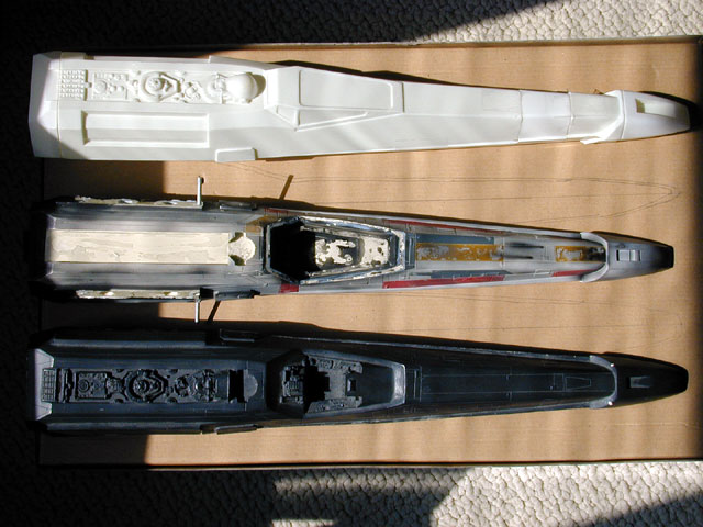

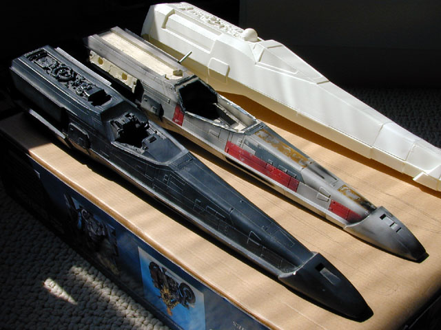

RE: 1/24 Hero X Wing Build with Maxi Brute Fuselage - 427 Cobra - 12-05-2009 These models were originally made with a polyurethane resin fuselage,and polystyrene bottom on some. These were formed from a buck that was made by casting the original model over a wooden form. This was made from urethane. The resin of these was originally a catapillar yellow that was painted over with a tan primer over the pyro models,and a black primer on top of that. The same treatment was used for all models. The tan wasn't satisfactory,as you couldn't tell where all the white paint was applied evenly,so it was decided to use black under the white. This is why you'll see some patches that are dark yellow/orange in colour,and not tan where the paint was intentionally removed. The same is also true for the four foor Return of the Jedi model. Polyurethane resists aging in colour,and it's easier to use - more than other resins,which is why it was used. Remember,this was new technology back in the day. It took several tries by the ILM team in small quatities to get this down without having to throw away a lot of expensive product. When we were all a lot younger,all you had to choose from is the MPC model,or the Maxi-Brute model. This latter was also formed from the same buck - not simply measured,then a scratch made version offered to the public. Yes,the Star Wars chronicles is wrong most of the time. That lends me to believe that this guy was making a lot of his misinformation up,or he was high at the time he wrote it. The ILM models were kitbashed to save a lot of time,and money to make an entirely new vehicle design. This also saved them from having to make forms for a lot of small details,and complex parts with the new moulding technology that was shown to them by a few experienced mould makers at the time. RE: 1/24 Hero X Wing Build with Maxi Brute Fuselage - Kuhn Global - 12-05-2009 Great points all around Chris! When did the Maxi-Brute originally become available? RE: 1/24 Hero X Wing Build with Maxi Brute Fuselage - 427 Cobra - 12-05-2009 The first year of the Maxi-Brute was 1978. This was the fall release,and it was the earliest version ever made. There were no scribe lines on it,but it was only cast for the fuselage. The rest of the parts were made from scratch,as this was only intended to be a rocket version of the X-wing fighter,and not an uber-perfect 100% accurate model for display. This is why so many people dispute the origin of this model,as the greeblies were cast,and added to the fuselage after the original ILM buck cast was taken to the factory to be massproduced. This was in the late summer of 1977 (August,or September). This was announced in RC modeler magazine in a small advert. This was done to appeal to the RC modeling geeks,as this was a huge business at that time. Anything that flew was big money. It would six months later before the actual summer release date was set. I know,because I was one of the first people on the waiting list to get one of these when they came out in the stores. This took almost a year in the planning stages before being approved by the Estes corporation,but only after clearing all the legal procedures of Lucasfilm. The first official release was at the end of July 1978. This is the date stamp that many of the first boxes,and instruction manuals had on them. There were later releases,but the fuselages had been altered,and other changes to make the model lighter for flight purposes. There were other alterations,and additions to subsequent models,but these were never as accurate,or as desireable as the first releases with the enclosed canopy. The size of the laser canons,and the nosecone design,and the Phantom engines on the later models were slightly smaller to accomodate even weight distribution. RE: 1/24 Hero X Wing Build with Maxi Brute Fuselage - 79 Daytona - 12-06-2009 WOW!! This is a great weath of info you guys are giving us so thanks and like i said earlier i got one of the Maxi-Brute X-Wings back in late or early 79 and i thought it had a better look then the old MPC kit so thats why i made it in to a display model . RE: 1/24 Hero X Wing Build with Maxi Brute Fuselage - PB BB1 - 12-06-2009 Hey guys, no worries, please discuss on! Perhaps just one Red 1 afterall... not so sure about this. I have reference of Red Leader that definitely has pyro wings. Considering the advanced construction of the Hero models I highly doubt any of the Hero models got blown to bits. Granted it has been some time but Lorne Peterson says so himself in the Sculpting a Galaxy dvd. He makes a point of telling us that no one came around asking to blow up a hero model as they were never short on things to blow-up. As for the Maxi Brute... well there's a reason you thought it better than the MPC... it is THE X imo. There is currently no proof at all that it was based on an ILM Hero buck... or anything taken home from that visit. If there is more information here than the mailer linked in my first post, then please I beg you to share it here. The more I look at this thing the more I realize this IS IT. You have to figure the simplifications made were decided on... take away here, add something here. The cockpit's stepped transitions are a great example. BUT the X wing is here in the MB... regardless of its lineage. Ironic really that a near-perfect studio scale Hero X has been available since 1978! I will be posting the 'wing template' sheet that is included with the rocket. The Sealab parts match the wing box perfectly. I will be posting the template with all Hero wing measurements. Granted, tons of work involved to make it more than a rocket, but certainly the best start you can get on your scratchbuild. That is, until I offer a fuselage kit. Might want to sell those MBs... gonna be offering my work up to any builders. I will NOT be selling a complete kit and I am already getting a head of myself. This will take time, but I want to help any builders. I can count on one hand how many X scratchbuilds I have seen in the past decade so i'm not sure if there would be any interest anyway. What I want to know is were the panel lines on the hero bucks done individually? RE: 1/24 Hero X Wing Build with Maxi Brute Fuselage - JAWS - 12-06-2009 I nearly scored an or the XWing 'Buck' when it recently went on auction from Richard Edlunds collection. It had the panel lines scribed into it. It was said to have been used to produce the last 4 XWings used in A New Hope. So from that statement I suspect they were 'Pyros'. Im trying to find the information on that buck. RE: 1/24 Hero X Wing Build with Maxi Brute Fuselage - PB BB1 - 12-06-2009 (12-06-2009, 09:29 AM)jasonwright.1972 Wrote: I nearly scored an or the XWing 'Buck' when it recently went on auction from Richard Edlunds collection. It had the panel lines scribed into it. It was said to have been used to produce the last 4 XWings used in A New Hope. So from that statement I suspect they were 'Pyros'. Im trying to find the information on that buck. Yeah, I read that on another forum not realizing that was you. So who did wind up with it? IIRC another guy on the same forum was going to offer a kit, with a backplate from an original, and then backed out after he snipes that gem from the Edlund collection? I have the photos of that thing... no doubt that is the Pyro master. Wing mounts are dead on to the photos of the Pyros. That buck used to make it is definitely the same as the Hero versions. You can also see the styrene bottom half, and resin nose. Same parts that were used on the heros. RE: 1/24 Hero X Wing Build with Maxi Brute Fuselage - JAWS - 12-06-2009 That guy was a not so popular person who had studioscalemodeler.com I was the idiot who showed him that 'Butt Plate' that he snatched! Then asked if it was ok... It was probably him who won that 'Buck' too cause I was on friendly terms with him at that time. Damn, more salt in the wound. Of all the people I had to meet first in this scene it was him. Heres an image & a link to the auction http://www.icollector.com/Final-detailed-master-male-molds-for-the-X-wing-Fighter-fuselage-from-Star-Wars-A-New-Hope_i8632912 RE: 1/24 Hero X Wing Build with Maxi Brute Fuselage - JAWS - 12-06-2009 t the RPF http://www.therpf.com/showthread.php?t=48646 I marked the parts you can have from the incomplete Sea Lab III kit I got. The clear part had pieces attached & is not 100%. If you need it for your build you can have the orange duplicate piece that is in 100% condition. Maybe I could buy some castings of your 'completed parts' & I'll get myself a Maxi Brut I do have all the parts in my complete kit but can only offer castings of those

RE: 1/24 Hero X Wing Build with Maxi Brute Fuselage - MonsieurTox - 12-09-2009 Sorry you misread me, I didnt say that Red 6 (on your pic) was Red 12 but that the one you call Red 4 is actually Red 12, Im talking about yellow markings on the cannons (barrels), not red markings. And thanks for all those great pics but you seem to have only the bottom pic of Red 12, I have the 3 other views of this serie (just like Red 4) of pics and I can assure that's Red 12. Quote:Notice the red laser canon on the top port (left) wing on the model with the GRAY canopy. This is Red 6! Red 12 is between Red 6,and Red 4 in this picture. I'm not simply trying to entertain you,but inform you with photographic evidence,and not long held misconceptions. Yes, that was I said, that's this one. Let me quote myself : Quote:The X-Wing with the yellow canopy in this pic is not Red 4 but Red 12 (just look at the yellow markings of the laser cannons and compare to the pic you posted of Red 12 Red 4 had different markings -2 yellow strips per cannons close to the heatsinks-). RE: 1/24 Hero X Wing Build with Maxi Brute Fuselage - 427 Cobra - 12-10-2009 You don't have to explain. I wasn't looking at those laser barrels when I posted that lastnight! I was tired,and not thinking clearly. That was my mistake! It's obvious. I see that now. It's as clear as a bell. I just wonder why most of these have the yellow stripes on the barrels,but Red 5 has blue candy striped ribbons on its' laser canon barrels. Was this because Red 5 was the hero of the movie,and they wanted to show that? Maybe it's so that it you can tell the difference between it,and the other fighters while on screen. That's what I meant when I was talking about the yellow stripes. Red 6 doesn't have them either. The only other model that has them is the four foot Red 3 model from Return of the Jedi. I wonder what the stripes were originally supposed to suggest,or if they were strictly for a sense of realism.....
RE: 1/24 Hero X Wing Build with Maxi Brute Fuselage - JAWS - 12-10-2009 Well one of Geoges strictest rules was that if you put something in or on a model it has to have a relevant menaing to what ever it is. So stripes have to have had some meaning. RE: 1/24 Hero X Wing Build with Maxi Brute Fuselage - 79 Daytona - 12-10-2009 WOW!!! Cool pic's thanks for posting them its really great read the history about these models from ILM. RE: 1/24 Hero X Wing Build with Maxi Brute Fuselage - 427 Cobra - 12-10-2009 (12-09-2009, 05:31 PM)MonsieurTox Wrote: And thanks for all those great pics but you seem to have only the bottom pic of Red 12, I have the 3 other views of this serie.This is the only photo I have of Red 12 like this. I too,would like to build Red 6,and Red 12. These are the most obscure of the Rouge group. I only have the photos of these two that are posted here. RE: 1/24 Hero X Wing Build with Maxi Brute Fuselage - kbilly - 12-10-2009 Wow... you guys really know your x-wings. I think I might just wait till someone makes an infographic haha. Seeing as how I'm a little late to the party, what are the main bones of contention here? You know in 10 words or less. RE: 1/24 Hero X Wing Build with Maxi Brute Fuselage - 427 Cobra - 12-12-2009 It all boils down to this - Is the Maxi-Brute really cast from the original ILM buck that the original ILM models of the seveties were also cast from? I beleive the company - others don't for whatever reason.

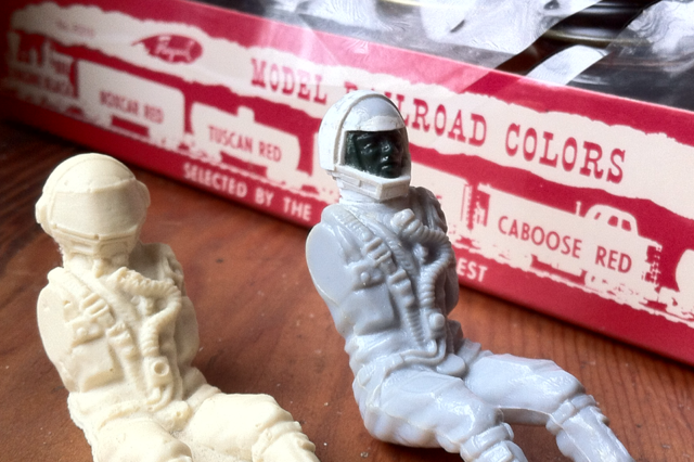

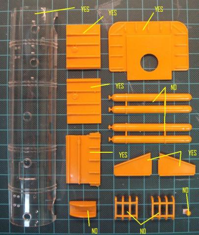

RE: 1/24 Hero X Wing Build with Maxi Brute Fuselage - PB BB1 - 12-22-2009 Baby steps... This one's for you Jase! I have chosen to replicate all of the detail found on the original back panel... you can really get a feel for what was sitting around their workbench. What to do with these Saturn V bell trimmings... ![]() Finally starting the fuselage mods as well. This is going to be tricky... I will next be removing the nose cone to fill with solid resin. This will also spoil my view of the entire fuselage I've been keeping on the bench as inspiration. Oh well... time to get to it... even if it ain't pretty. First, layered some styrene in there to correct the depth of the notch, only to realize it does not go back far enough. Some filler here and there to smooth it out, and marked with pencil what needs to be removed. ![]() I want to believe... that the MB is from ILM parts. But these nose mods make me question the nose itself. It seems just right to me, granted... ever so slightly too fat when compared to photo reference. Still, I am wondering if this did come from an original why bother to modify this detail? Perhaps the original notch created aerodyamic problems. RE: 1/24 Hero X Wing Build with Maxi Brute Fuselage - 427 Cobra - 12-22-2009 I believe the Maxi-Brute story no matter what anyone says! Remember,there were a lot of things that had to be added after moulding the fuselage. The scribe lines,and greeblies along the sides of the fuselage were all added later. There were parts that needed to be shaved,and removed as well as modified to add certain details. I won't go to much into this,as I won't derail this thread again. This is why some of the things on the Maxi-Brute model aren't easily explained,but they are in accordance with keeping the original ILM lineage. What you're doing is no different than what happened at the original ILM modelshop back in '75 - '76. What you're wearing might not be the same,but you definately have that ILM mojo going on. Don't stop what you're doing that way you're doing it! This is the only way to figuring out what skills you have,and to what degree. This is how it usually happens,except when you have a deadline to finish by,you have a lot of heat on you to get it done! On the plus side,you have a bunch of experienced modelers that are professionals to bounch ideas off of. Back at ILM,there were some models that had problems with slight part warpage,and others that needed to be modified to different degrees to match each other,as no two ILM guys always worked on all the exact same details for every model. The original buck made was destroyed by cracking resin that wasn't properly mixed inside the mould that caused it to expand slightly,so a new mould was made,and the bottom mould was modified slightly to accomodate the new armature motors. There was always something to go wrong,so you have to think on your feet! Just keep going. If there's any part that you need help on,don't hesitate to ask. RE: 1/24 Hero X Wing Build with Maxi Brute Fuselage - JAWS - 12-22-2009 Looking good Paul. Cris nice feedback. This is going to be a great build & theres plenty of people following it. Keep up the good work. RE: 1/24 Hero X Wing Build with Maxi Brute Fuselage - 79 Daytona - 12-22-2009 I agree looking GOOD!!! Can't wait to see more.
