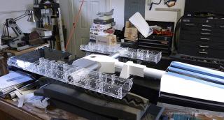

We're making good progress on the build so far. It's very tedious and precise work. Our goal is to achieve a very high degree of precision. That means everything should be square, plumb, and neatly fitted.
To that end, I have developed special jigs and tools to make construction as accurate as possible. This includes an expensive machined aluminum table that is absolutely flat and allows parts to be bolted and clamped directly to the metal surface during assembly.

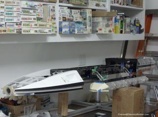

Right now we have the main body and neck sections permanently attached to the armature. This required a good deal of fiddling and adjustment. In addition, both landing bay cores have been built and fitted to the rest of the ship. After final alignment of the arms is completed, the bay bottom skins can go on and then the end caps.
The coffin and pyramid that go under the main body were built a while back. Before we can fit them, however, a pipe sleeve must first be fabricated. The armature I designed goes together without welding because it uses IPS pipe. This allows the use of very special fittings. But, the outer diameter of this pipe is slightly smaller than the one used on the original Galactica. As a result, this replica armature must be modified where the pipe is exposed under the main body and neck.

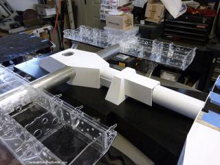

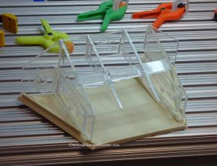

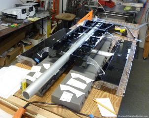

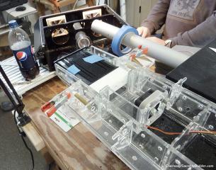

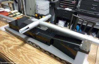

Fitting the bays was quite an experience. I created a design whereby the ship can come apart in sections for easy detailing. This is a huge blessing but it has also made things more complicated to assemble. For example, the armature cross arms have been split into two sections so the outer part that is attached to the bay is removable. This allows the landing bays to come off so they can be detailed more easily.
Unfortunately, we discovered this important design feature makes the bays challenging to test fit. To get the pipes to fit together, there has to be some wiggle room at the joint. This means the bays can sag at the point where the two pipes come together.
Once the cross arm pipes are epoxied in place, none of this will be an issue. Until that happens, however, we can’t fully align the landing bays without adding some temporary supports underneath.

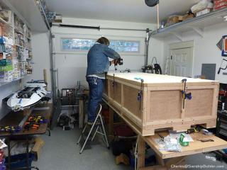

RE: Yet another studio-scale BATTLESTAR - star-art - 03-07-2013

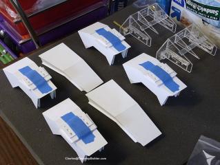

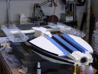

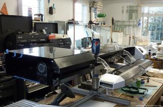

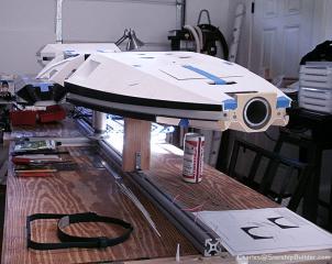

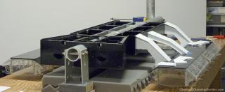

Richard and I held another marathon building session last week. The bottom of the ship is now complete. We installed the coffin and pyramid assemblies that Richard had so elegantly built earlier. We then trimmed out the exposed armature pipes. That turned out to be quite a job!
The armature on this replica is made from rugged IPS pipe. It's a bit smaller in diameter than the muffler pipe used on the original. The typical solution is to wrap the exposed pipe in styrene sheet to make up the difference. Because the plastic needs to be rather thin to wrap onto the pipe, this can require many layers to get the proper thickness. I've also learned from experience that thin styrene tends to wrinkle when glued. Thus, keeping everything nice and neat could be a challenge.
This time, we chose a different approach. We crafted "sleeves" out of stainless steel tube that is nearly exactly the same size as what was used on the original studio miniature. This way, all the visible pipes have the correct diameter. Later, when all the parts get glued on, everything will be spaced correctly.
On the original studio model, they wrapped the lower longitudinal (i.e. length-wise) pipe in styrene while the bay cross arms simply had parts stuck on them. This replica also features exposed metal bay cross arms. And, just like the original, we wrapped the lower main pipe in styrene the exact same way it was done at Apogee in 1977/78.
Thanks to the sleeve, the pipe had the correct diameter. Thus, we had to apply only one thin layer of plastic. This was accomplished using epoxy. Since the sleeve could be removed, we were able to apply the plastic wrap with everything off the model. To keep from having any wrinkles or other surface blemishes, we hid the seam where it would not be visible. The result was a very clean finish.
We also made more progress on the engine section. The side boxes were built and the rear "thruster module" was fully assembled. All the cast resin "thruster vaults" were cleaned up, fitted, and installed. They are simply tacked together for now. In order to detail them, it will be necessary to split them apart again. Then, once they are fully detailed, they can be glued together permanently.
Richard also completed work on all six of the arms. These are built as shells that fit over an internal acrylic structure. The bottoms of each one are simply taped in place at the moment so the entire arm can be removed for detailing.
Right now, the entire ship is assembled upside down on the work bench. Next, we will start work on the landing bay interiors and we will also continue working on the engine section until it's done.
I chose not to install the landing bay bottom panels yet for a couple reasons. First, the rear end caps are rather complicated and I want to make sure we have full internal access to get those installed. Also, I decided to make a revision to the internal bay structure. That's because the client will be using circuit boards for the rear bay end caps supplied by Custom Replicas. These have surface-mount LEDs and a number of resistors that are likely to generate some heat.

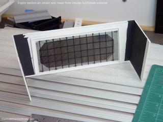

To make sure the model stays cool, I was able to figure out a way to mount a small computer case fan inside each bay to blow air across the boards. The most important thing is access for future service and repair. Due to the number of components crammed in there, this was quite tricky to engineer. I got it all figured out, however, and the needed parts were laser-cut. I also ordered the fans themselves (quiet models with a stated noise output of only 12 dB each) along with some anti-vibration mounts like the ones we're using for the engine fans. These will keep the bay fans from sending vibrations into the structure over time. All those items should be here sometime this week.

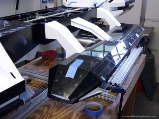

While all this was going on, we had a few more week-long marathon building sessions. The most recent one was just last week. We made every effort to completely finish this beast. Of course, she did her best to fight us every step of the way. LOL
The engine section is now completed and ready for detailing. All that’s left to do is glue in the “waist” with the custom-made air intake assembly. That is built and fitted and ready for permanent installation.
The rest of the body of the ship is pretty much done as well. We’ve spent a great deal of time working on the landing bays. The rear end caps have turned out to be a project within a project. I think we've put almost as much effort into building those as we have the rest of the ship (minus the head section).

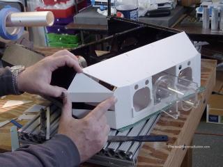

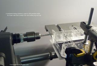

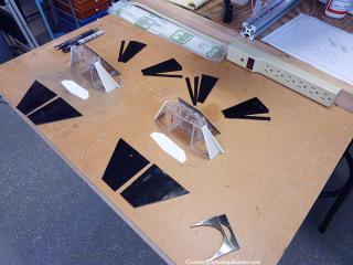

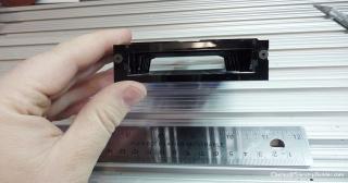

The original plan was to use the cast resin parts I designed for Custom Replicas. These form a finished shell, ready to detail, with an interior framework made of plexiglass. Unfortunately, the resin parts warped. While this could be fixed, they also shrank a bit. This shrinkage was not uniform. As a result, in terms of angles and dimensions they no longer fit the bays.
The client asked that we discard the resin parts and build all four landing bay end caps from scratch. That has turned into a major undertaking. Because this model uses custom made printed circuit boards (PCBs) for the sequenced landing lights, we were forced to use the lower resin shells for the rear end caps. These were specifically designed to fit the circuit boards and allow then to slide out for servicing.
The rest of the end caps were then carefully built from scratch around the existing lower resin parts. At the same time, the resin parts had to be altered to precisely fit the surrounding bay structure.

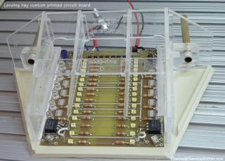

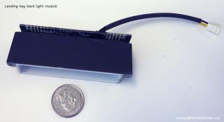

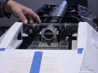

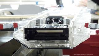

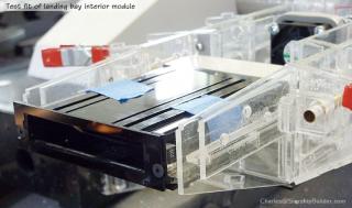

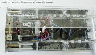

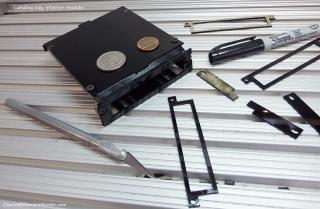

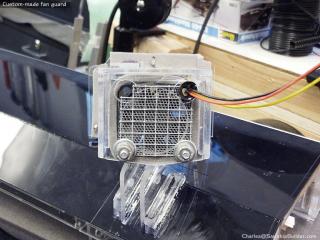

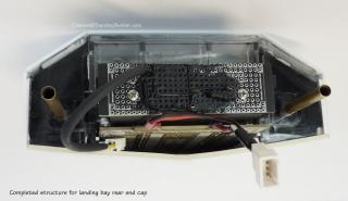

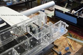

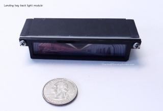

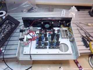

Inside the rear of each bay is a cooling fan, a custom printed circuit board, a complete miniature interior “set” to match the one on the original studio model, and a back-lit module containing a copy of the matte painting that was used on the original studio miniature. All this is connected via a plug-and-play wire harness.
It is ironic that, on a model this large, we were forced to cram so many components into such a small space. In many ways, this was like what we went through last summer working on the C movie model.
Fortunately, both rear end caps are now built, the interiors are finished, and all the landing bay wiring is done. Before finishing our last work session, we connected both landing bays for a lighting test. After all this work, it was quite a moment when I plugged it in and turned on the power switch. They worked perfectly!

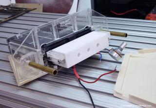

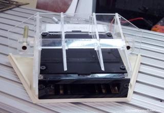

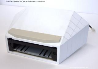

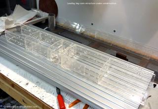

Richard has been hard at work finishing the landing bay rear end caps. Making these from scratch has been a real challenge. It’s not easy matching the quality of 3D-printed and/or laser-cut & etched parts. But, I think we’ve managed to do pretty well so far. At this point, the rear end caps have been masked and primed. All that’s left is some final “preening.”

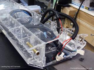

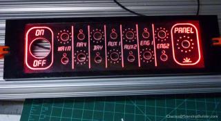

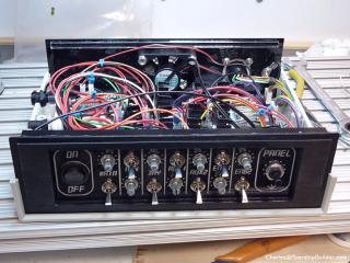

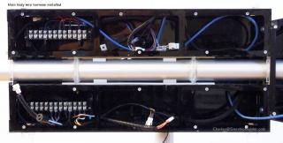

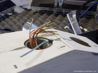

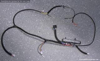

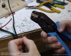

In the meantime, I’ve been working on the complex wiring. I spent weeks designing everything. Now, it’s time to see if what I’ve drawn up actually works as planned. As with all complex projects, a number of things will need to be tweaked along the way.
The landing bay wiring was installed during the previous update. It has now been finalized and connected inside the main body. One of the challenges in this area is the fact not one but two fuses are needed inside each bay. With little or no room to spare, it was not possible to install panel-mounted fuse holders. Thus, I was forced to employ inline fuses. Because they must be accessible in order to change the fuses, these take up a lot of room in the wire harness.
Everything must be done through the narrow opening at the end. This includes being able to remove and service the custom printed circuit boards, each custom back-lit interior painting with light box, the 40mm computer fan, and of course the two fuses.
Once all that was sorted, it became apparent that, with all the wires stuffed in there, it might be possible for one or more wires to find their way into the path of the fan blades. I asked Richard to make a custom “fan guard” assembly and he did a brilliant job as usual. It is pretty neat and should be quite effective I think.
So far, I’ve made up and installed the main body harness. That went fairly smoothly. I still need to make the circuit board that will go in the main body (and a similar unit that mounts inside the head section). I also have to make up all the individual LEDs with their own wire harnesses. These will plug into the circuit boards.

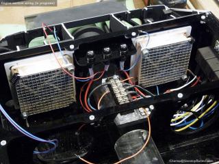

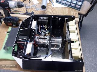

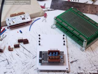

The engine wiring was next. There’s a lot going on in there, so it’s the most complicated part of the ship to wire. I’d say it’s about 2/3 done at this point. I still need to install the custom computer control module behind the port side cooling fan. And, of course, we need to fabricate and install the main engine lights themselves. These will be completely custom made.
The computer module will monitor four internal temperature sensors and all four cooling fans. In the event of a problem, it will be programmed to cut power to the printed circuit boards inside the landing bays and/or the main lights inside the engine section, as well as any or all of the cooling fans as needed. For example, it should be able to detect if a fan gets stalled or jammed and shut it down in order to prevent the fan motor from burning up. In addition, if a fan quits working, the associated circuitry will automatically power down to prevent overheating.
A lot of careful planning and design work has gone into figuring all this out. Once I get it all wired up, there will be some extensive testing in order to make sure everything works correctly.

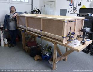

I’d like to say “thanks” once again to Richard Lindstrom for all his hard work helping me finish this beast. We’ve put in a lot of 12-hour days trying to get it all done.

LED lighting can certainly require cooling depending on the type of LEDs chosen. In this case, the strip lights in the engine section will get quite warm. They will be mounted to a custom-made aluminum heat sink and cooled by fans.
Even if the LEDs don't get warm, the resistors required to run them sometimes do. In my article for Sci Fi & Fantasy Modeler, Volume 30, I talk about heat being dissipated by the resistors and some of the problems that caused.
In the landing bays, there are custom printed circuit boards (PCBs) in very tight quarters. These were made by a third party. While I don't expect them to get hot or even warm, the cooling is there just in case. For a project this time consuming and costly, "better safe than sorry" is the rule to live by. Smile

I don't have very many pics because, as soon as we'd completed all this, we had to tear down the ship again for me to get back to work on the wiring. I am attaching what I can.
I'm still working to complete the complex engine compartment wiring so Richard can lock down the waist structure. I've also been building all the circuit boards that go inside the ship. Soon I will start work on the control box. Right now, the "core" of the ship is upside down on the bench so we can work on the umbilical.
The best approach IMO is to have the wires come out of the model and then run straight to the control box. But, this would mean a 10-foot cord would be sticking out the bottom. The client wants to film this model and he would never be able to hide that. In order to shoot from below, the umbilical must be disconnected just underneath the ship.
This will make it a bit tricky to get the model on and off its stand. But, that is the trade-off for being able to film it from every angle.

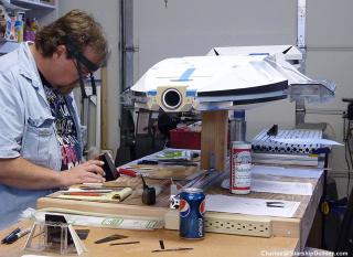

RE: Yet another studio-scale BATTLESTAR - star-art - 09-12-2013
Budgie smugglers??? LOL
Richard was cleaning out his garage and found that old beer can. Apparently, it's vintage from the period! He brought it to the shop so we could have a more "authentic" piece to put in the photos. It's for sure not mine as I don't drink. . .

RE: Yet another studio-scale BATTLESTAR - Richard_2001 - 11-19-2013
Yeah,
Richard is pretty much finished with his side of things even the "BFB" got finished long ago.
Just waiting on Charles to get the electronics bashed together so I can go help him lift it into his truck for shipping.

I know it has been a while since the last update. Still, work has continued. In fact, the model is about to be shipped to its owner. Once we have it crated, I'll organize the pics that have been taken over the last few months and post a new update.
RE: Yet another studio-scale BATTLESTAR - Wombat - 01-04-2014
Fantastic news, Charles!!
Your client is going to be so rapt to finally have it. Cool

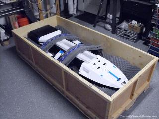

RE: Yet another studio-scale BATTLESTAR - star-art - 01-13-2014
The structure of the battlestar replica, as well as all the lighting, has been completed. The ship is on its way to the client as we speak.
Because the client wants to film this model, the electrical design on this project was more challenging than usual. It had to be treated as if it were a *real* filming miniature. That meant eliminating all pulse-width modulation (PWM) from the circuitry. PWM creates a "flicker" effect. While it might not be noticeable to the eye, it certainly shows up quite well on camera.
The other major requirement for filming was creating lighting that could be fully dimmed from "off" to maximum brightness. In order to accomplish this, I chose a linear control strategy. This was more complex and difficult than what I created for our last major project, the 'C' movie miniature.
It is much easier to use ordinary PWM dimmers to control the brightness of LEDs. Here, I had to design my own power supplies that could provide a variable voltage without any pulsing. All this had to be controllable using small potentiometers that could be installed in a control panel.
As with the last project, I opted to build a completely custom control box that featured illuminated controls. There are seven separate knobs for dimming and seven switches for "ON/OFF" control, plus a main power switch and panel dimming control.
With all this figured out, we still had yet another challenge to overcome. The client wants to be able to film the model from below. Because it was designed for display rather than filming, this miniature has only one mounting point -- beneath the ship. To solve this challenge, I added an auxiliary power point inside the main body on the top side of the model. It is hidden underneath the main body lid. To film the ship from below, the client can remove the access lids on the top of the ship, flip the entire model upside down, and power it from the auxiliary connector.
The primary power connector is designed to be hidden inside the lower mounting point. It tucks neatly inside the pipe, helping to keep it out of the way. All the client has to do is make a cover plate to hide the main mount on the bottom of the ship during filming.
Once everything was done, my good friend and faithful assistant Richard Lindstrom built an enormous crate to protect the model during shipping. It is quite strong and should help ensure the model reaches its destination unharmed.
Once again, I must give my thanks to Richard for all his hard work on this project. It has certainly been a learning experience for both of us. For one thing, I did not realize just how much work it would be to assemble all the different modules *after* they had already been built. I already knew how much time and effort was involved in building the different sections of the ship. That alone can take months. Putting it all together, however, is like taking on a whole new project.
This ship was very challenging and time consuming to build. Still, we are both very proud of the finished product. I'm sure the client will feel like a kid on Christmas morning when he opens the crate!
Before we shipped it out, we managed to capture some video of the lighting effects being tested. We also demonstrated how the modular design works:

Modular Design
