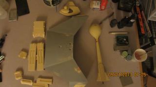

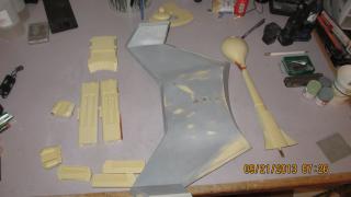

well I guess it's about time I post SOMETHING here since ive been a member for quite some time.
so I started building this a couple weeks ago. im not going to lite it or go really radicle with it, just a simple build
[attachment=15044]
[attachment=15045]

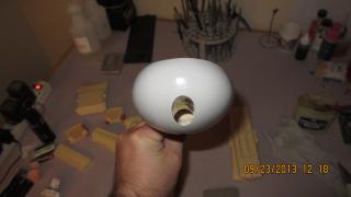

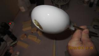

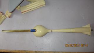

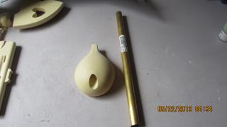

I didn't like the way the tube looked, it was off by a smidge, so dremeled it and added the brass tube. it looks much cleaner and strait.

then I mirrored the pylons and nacelles together for a better fit.

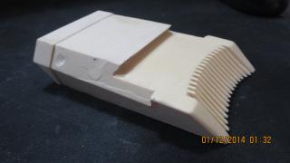

had to do some fixing here on the castings, the back piece was bigger then the cast with the comb , the best I could come up with was to add filler and blend the two together.
[attachment=15474]
[attachment=15475]
once that was done, I mirrored the comb body to the hull. I sprayed window cleaner to the body then smoothed the aluminum foil to the body so there were no wrinkles to deal with. traced out were the comb should be, added some evercoat to the edge of the comb and gave a good press, the result was a perfect mating Smile
[attachment=15476]
[attachment=15477]
[attachment=15478]
[attachment=15479]
