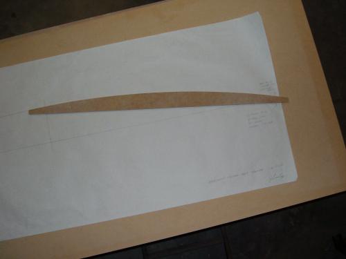

I thought I'd go ahead and build a Naked Five Foot Falcon, I figure if it doesn't work out, I can always turn it upside down and make a bird bath, LOL. If I get it right, I can add detail as I buy kits. I started by making a 79.05 inch trammel to draw the curve of the hull. That would be one humongous sphere if you had the whole thing. I started thinking of all kinds of router jigs and such to carve the shape, but ended up putting on my sculpting hat. The only thing I hate more than sculpting, is painting , yuck ! Sorry about the picture quality, camera is old and on the fritz.

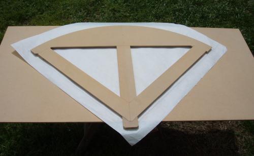

Drawing and Mdf Template
[attachment=17168]

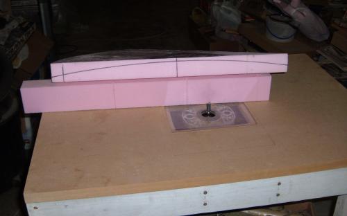

First I cut out a 1/8 th  pie slice of foam. I was going to do a whole quarter at a time, but it was too much to bite at one time.
[attachment=17169]
I used the Mdf template to draw the curve on the foam.
[attachment=17170]
Got out the ole hacksaw blade and started wacking away anything that didn't look falconish, Wink
[attachment=17171]
After a few hours of hacking and sanding, cough, cough, I had this.
[attachment=17172]

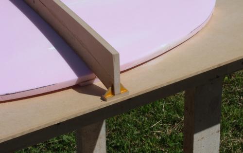

Then I had to make another piece just like the first and glue them together. With the two 1/8 slices together I now had a 1/4 hull section.

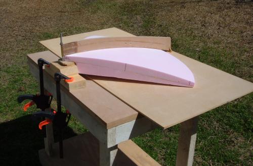

I couldn't get it perfect by hand, so I made a jig I call the "Blade". It's a scrap piece of 1/2 inch Mdf cut to the exact hull curve. I
epoxied a piece of brass tube that can pivot on a bolt. I then glued on a strip of 100 grit sandpaper to the bottom of the  "blade". By
sweeping back and forth it sands the wedge to exact shape. It's hard to describe so here's some pics.
[attachment=17175]
[attachment=17176]
[attachment=17177]
[attachment=17178]
[attachment=17179]

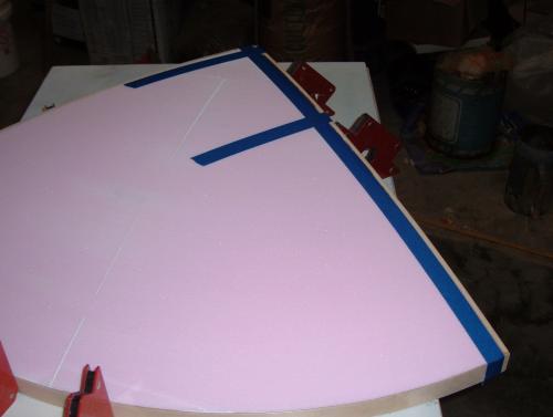

Well been working on the Nekkid Falcon for a few months. Finally getting something I can mold. Here's the latest,

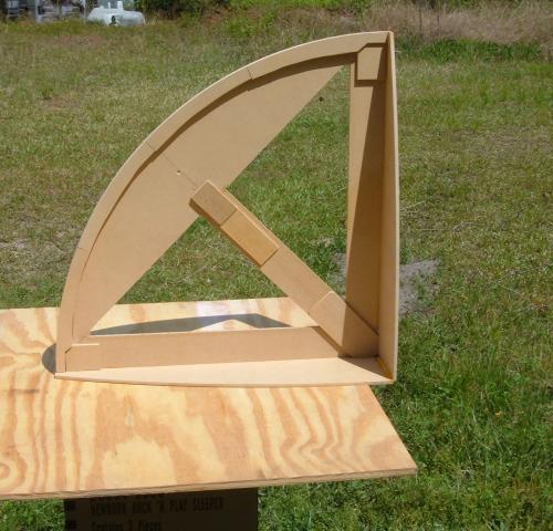

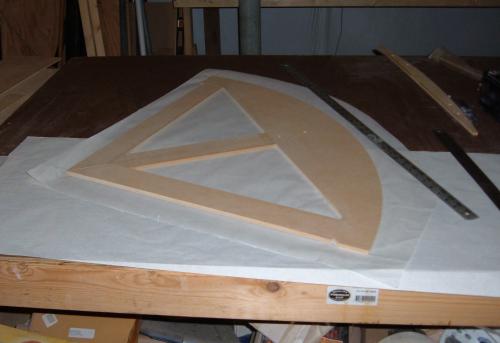

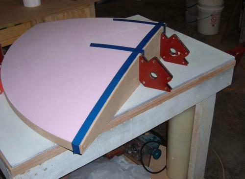

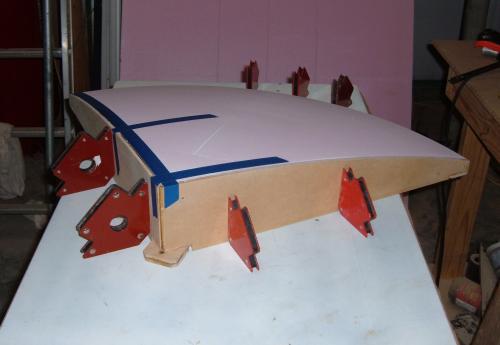

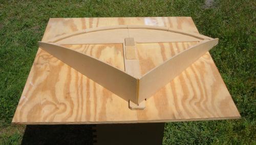

I needed to strengthen the foam up and get some nice 90 degree angles on the plug. So I made a frame from Mdf Parts.
This looks like a Baseball diamond, LOL.
[attachment=17343]
[attachment=17344]
[attachment=17345]
[attachment=17346]
[attachment=17347]
I have a 3/8 steel plate for a table top, so I can use my 90 degree welding magnets to get a nice square edge.
[attachment=17348]
I also added a 1/16 ply edge to the front curve. This strengthened it quite a bit, and makes the edge square.
[attachment=17349]
[attachment=17350]

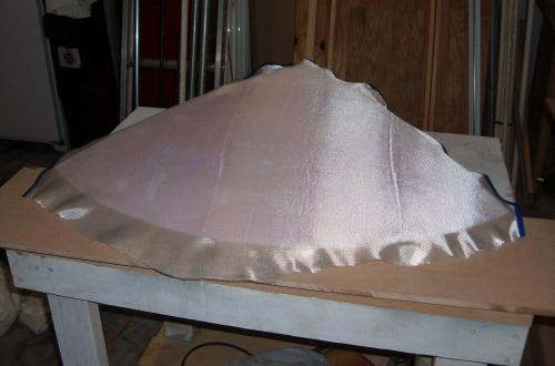

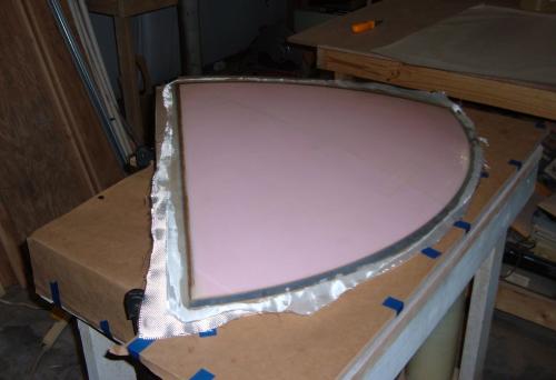

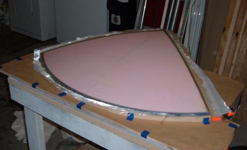

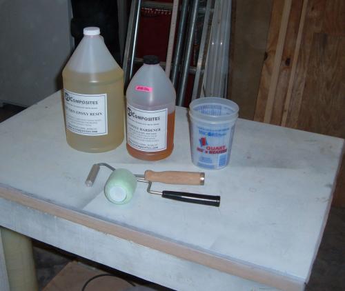

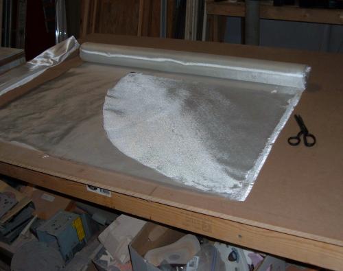

Got my epoxy supplies a few weeks ago. I went with US Composites. Their stuff is cheaper than most others, and works great so far. You get almost a Gal and a half for under 100 bucks, including shipping. So here's the messy part,
[attachment=17351]
[attachment=17352]
Using 1 layer of 6 oz. and 1 layer of 2 oz. for the plug surface.
[attachment=17353]
Layed on dry to have a looksie, ooh shiny, LOL.
[attachment=17354]
[attachment=17355]
Here it is wet out.
I'll try to post some more tomorrow of it trimmed and primed. Now I just have to make another pie slice for a half hull mold. I wouldn't want to lay up 8 pieces for every hull, Wink Cheers,

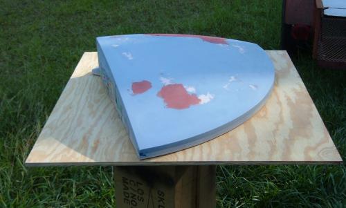

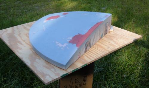

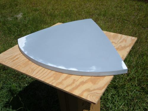

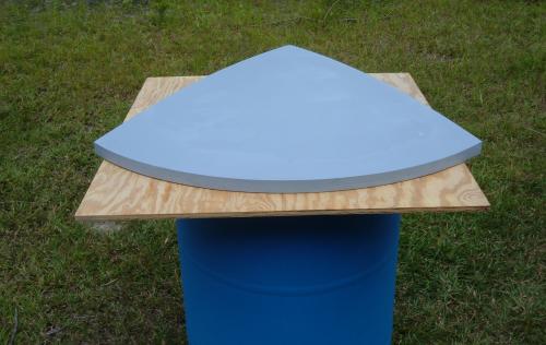

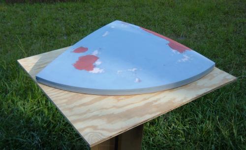

Sorry it took a few days longer to get these pics done. Finally got the 1/4 slice trimmed and primed. There were a few shallow spots here and there. Had to get out the ole spot filler. It doesn't matter how careful you are, there's always a few high and low spots. Even if I Cnc'd this thing, you'd still have mill marks to contend with. So here's a few more pics, Enjoy.
[attachment=17361]
[attachment=17362]
[attachment=17363]
After a few coats of filler primer, filled in the low spots with Filler putty.
[attachment=17364]
[attachment=17365]
Another primer coat, then hit it with a little drywall spackle compound. I like to use this to fill small spots in primer. It sands great, and filled those little spots easier.
[attachment=17366]
[attachment=17367]

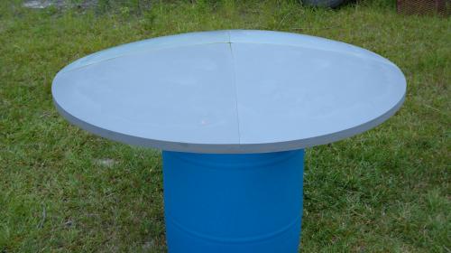

The last few primer coats. I think I'm close now. Still want to throw on a black guide coat, to check for any sneaky spots that I may not see with my poor eyes, Then it's on to making the other half of this thing, Argg !
[attachment=17368]
Couldn't wait to see what a full dome will look like. Threw a pic together in Photoshop to get a sneak peek.
Now on to making another quarter dome. Got a few tricks for this. Don't want to go through the same hassles for a new section. Stay tuned, Cheers,
