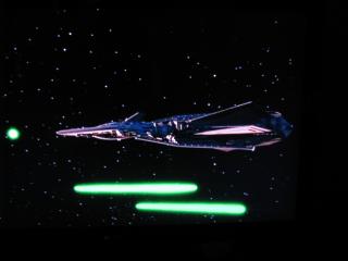

This is one of those spaceships that I wanted to have my own model of ever since the very first moment that I glimpsed it.  On the Shout! Factory 2011 DVD/Blu-ray release, there is a glimpse of what was planned for this ship vs what was actually used:
[attachment=17651]
As built:
[attachment=17652]

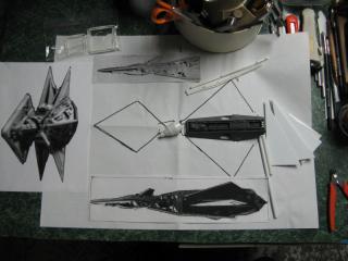

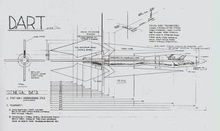

My (rough) working drawings:
[attachment=17653]

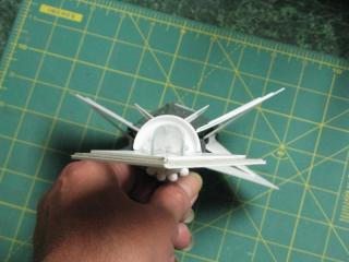

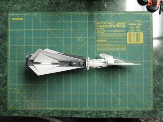

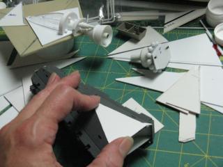

Cutting and gluing:
[attachment=17654]

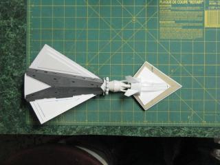

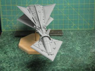

My best size guesstimate is 7 inches wide by 13 inches (or so...)
[attachment=17655]

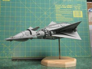

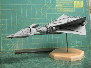

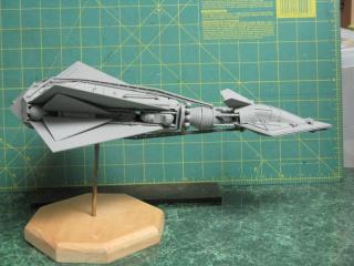

Starboard side:
[attachment=17656]

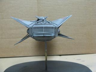

Forward / nose / bow view:
[attachment=17657]

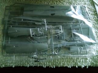

What's the canopy made from?
RE: BBTS St. Exmin Valkyrie - Joseph C. Brown - 06-07-2016
(06-03-2016, 08:29 AM)LeeS Wrote: You're going to force me to make one of these Big Grin
The canopy and the corresponding ventral 'bulge' came from the 1/48 Monogram F-15; the kit came out in 1979, so is quite eligible for this build.
[attachment=17729]
[attachment=17730]
Use the aft portion of the canopy for the top, and a second full canopy on the ventral side:

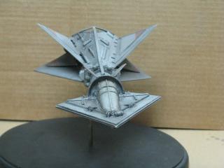

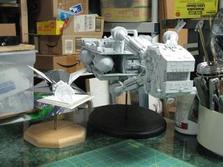

Primer on:
[attachment=17736]
[attachment=17737]
[attachment=17738]

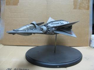

Followed by - (gasp!) preliminary completed pictures!
[attachment=17741]
[attachment=17742]
The reflective tape in the engine compartment effect worked nicely - far, far faster and easier than trying to cram a light and a battery in there!
[attachment=17743]    [attachment=17744]
I will endeavor to take some nice 'finished!' pics and post them in the appropriate area very soon!
