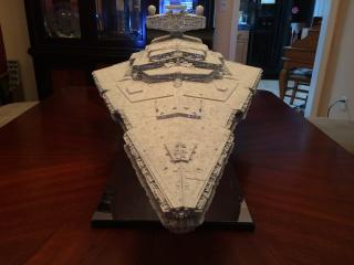

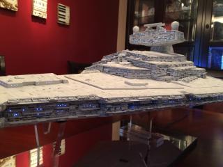

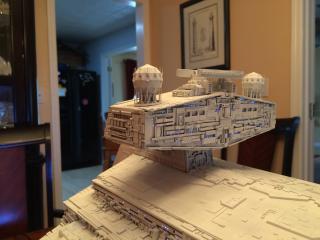

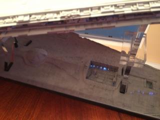

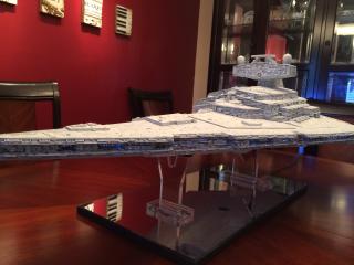

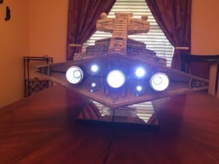

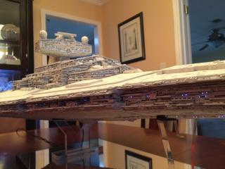

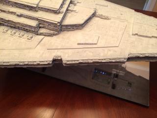

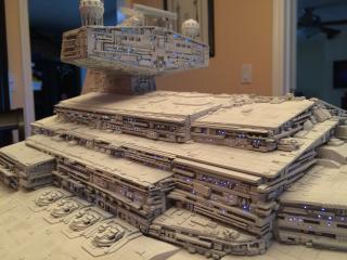

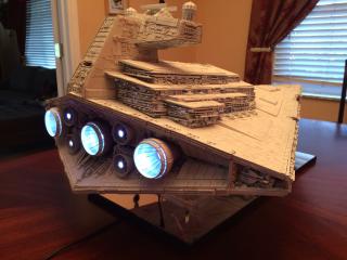

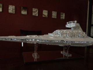

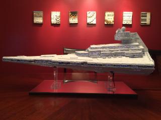

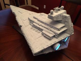

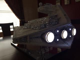

Something like a 1000 strands of fiber optics and a bunch of LED bulbs, I have finally finished. I made the base wit 1/2 inch acrylic for the supports, 1/2 MDF for the base and Mirrored 1/8 inch acrylic to reflect the bottom of the ship. The kit was really challenging, but still a lot of fun. I painted the entire ship black first then airbrushed 4 shades of white to panel the surface and give it a little more texture.  I found this technique really helps the details pop out without having to do washes over the entire model.
[attachment=17663][attachment=17664][attachment=17665][attachment=17666][attachment=17667][attachment=17668][attachment=17669][attachment=17670][attachment=17671][attachment=17672][attachment=17673][attachment=17674][attachment=17675][attachment=17676]

Wow ! That is a thing of beauty. Really great work there bud. How big is that thing ? Cheers,

Hi Joe,
Thanks for the compliment! It's 37 inches long. It ended up being very heavy since I made the internal frame out of plywood and then fiberglassed the resin parts to it. It's strong though. The top superstructure is removable and is held on with magnets so I can still get to all the wiring.
