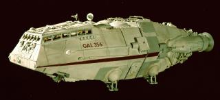

Eventually I'm going to have to think about painting. Does anyone have suggestions as to good paint matches for the shuttle? I have a hard time telling from reference photos whether the base coat shade of gray used on the filming miniature was a warm gray (touch of brown) or a cool gray (touch of blue). Advice would be welcomed!
RE: Do we really need another BSG Shuttle GAL 356? - Wombat - 08-18-2016
Not sure if this helps?
[attachment=17961]

Well... so are those colors a warm gray (as they appear in the photo), in reality a cool gray but the photo colors need to be adjusted in Photoshop, or white with (again) a yellowish cast due to the lighting and photo finishing? Has anyone ever color matched the restored model (or know what colors the restoration team used)? I read through the Smithsonian's online post last night that describes their color matching of the TOS USS Enterprise filming model. If only we had the same... :-)
RE: Do we really need another BSG Shuttle GAL 356? - Wombat - 08-19-2016

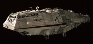

Unfortunately your guess would be as good as mine in regards to the cool/warm look. It can look either in different pictures so knowing which is correct is no easy task and the original miniature was obviously restored at some point after BR which may or may not be correct also. Sorry not much help I know.
Just put this on FB but this is a larger version of it.
[attachment=17962]
and a bit closer scan
[attachment=17963]

First, my thanks to Phil for those photos and the great discussion. It's not definitive, I know, but maybe it also means that no-one can really argue with my final paint color choices as long as they're close! Anyone else following the Smithsonian restoration of the Star Trek USS Enterprise? Kind of intimidating to paint a model when the Smithsonian has posted expert matches from the original filming miniature!

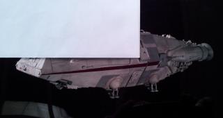

RE: Do we really need another BSG Shuttle GAL 356? - Wombat - 09-01-2016
[attachment=17964]
RE: Do we really need another BSG Shuttle GAL 356? - Troy Downen - 09-01-2016
Heh heh... well... tan? Okay, so there's some color in there. Hmmm...
