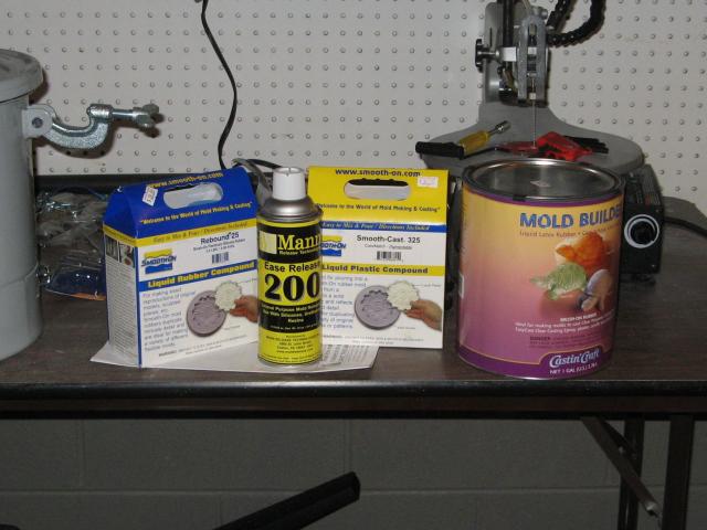

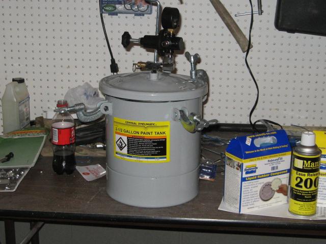

Welppers... I took the plunge today.. I bought a pressure pot and air compressor today.. and I found an Art Dealer here who is also a Smoot-on distributor and bought a gallon of rubber latex, a trial size of liquid rubber and also some casting resin..and a refrigerator! Yes, I said refridgerator. Woke up this morning to find my Ice cream and other stuff a little on the warm side.. Ugh! At any rate Im pretty excited!!
[attachment=1176]
[attachment=1177]
[attachment=1178]
[attachment=1179]
[attachment=1180]
RE: I bought some stuff today.. - modelnutz - 12-13-2009
Well, looks like you're in business now ! ;-)
Got most of what you need....
(dump the latex...useless....you'll come to love Silicone )
Don't forget the Talc !
I might suggest a water trap between the compressor and the Pot.
You don't want any water in the system...it causes urethane to foam.
Can I ask...why Rebound instead of Mold Max 30 or 40 ? ( never mind...just went to Smooth-On's site...brush on stuff...right ;-D
If I remember correctly, Rebound is a platinum cure silicone..( could be wrong though )..be sure to avoid any sulpher based clays ( they inhibit the cure of platinum silicones )
Good luck with the learning curve...may it be mercifully short !

(12-13-2009, 11:23 AM)modelnutz Wrote: Well, looks like you're in business now ! ;-)
WHy the rebound?? It was there, I'm just playing around for now . He didnt have any mold max other wise I would have gotten that..
So, a water trap? What does it look like.. I got most of this stuff at Harbor Freight..

I think you'll do just fine ;-D
You can find water traps at Harbor Freight as well.

That "Mould Builder" tin is the gallon of latex. You may want him to take a few more pictures of that can so that he'll always remember "That time" he bought some. This is part of that "learning curve".
LOL!
I agree with Modelnutz, erospawn. You need to get some Mold Max. I don't use the 40, but have used plenty 20 and 30 with excellent results. You need to get a couple more pieces of equipment once you make the move to RTV's. Vacuum equipment so that you can de-gas RTV. It'll be a very important addition, especially if you plan to pressure the resin later.

Here's a picture of a moisture trap. It'll go at your compressor outlet before any other attachments. That one is at Home Depot.....$12.99.
