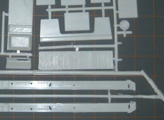

Thanks. I'm still working on that first layer of skinning. Ran out of styrene and finally have my new styrene in so hopefully I can finish it over the weekend.
In the meantime I could use some help. I'm having trouble identifying the long flat pieces in the following pic. I thought they may be parts of trailer, but can't be sure. Does anyone have any idea about these parts?
[Image: T2 - trailer.jpg]
RE: Studio Scale Sandcrawler (ANH) - Ralphee - 06-24-2017
Looks like Plastruct clapboard maybe mate?
Lee
The adjacent angled panels also look Plastruct, siding sheet.
Lee
RE: Studio Scale Sandcrawler (ANH) - KrokoHunter - 06-25-2017
Pretty sure the adjacent ones are done by hand glueing on strips of styrene. Same with the ribs running from top to bottom on the sides of the hull .... As some of the ribs seems to have been torn off
RE: Studio Scale Sandcrawler (ANH) - Ralphee - 06-25-2017
Yes Niels, was talking to Marvin earlier, and he said the same, can't say I've looking much at the model so was just a pondering, but yes it is very non uniform now i look, cool beans buddy. Its looking quite fabulous too!
Lee
RE: Studio Scale Sandcrawler (ANH) - marvin - 06-25-2017
Yessss.... haven't found a detail pic yet thats allowed me to measure the spacing but im sure i have one

RE: Studio Scale Sandcrawler (ANH) - RSWillett1 - 07-11-2017
Those long pieces look like they could be from the AMT Kenworth Cabover possibly?
RE: Studio Scale Sandcrawler (ANH) - marvin - 07-11-2017
Yes it is.... i got that hint recently and checked so you are right!
