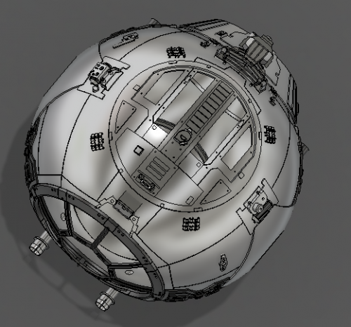

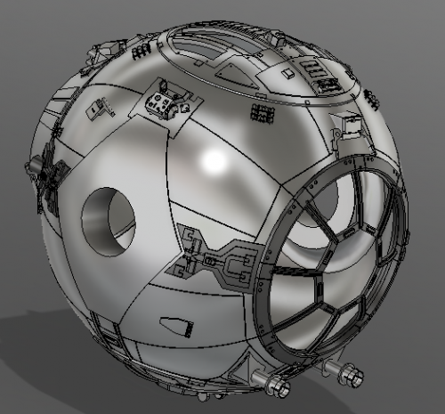

As promised, I'm getting this thread kicked off that covers my use of Autodesk Fusion 360 for modeling the ANH TIE. For those of you who may not be familiar with Fusion 360, it is a 3d cloud-based modeling tool that Autodesk launched in 2013, and is quite easy for the new user to jump in and create designs. The license is free for hobbyists and home users who meet the requirements of the non-commercial, annually renewed license. I had previously been an ardent SolidWorks user, but when the Fusion 360 team integrated a fully-featured CAM package a couple years ago, I made the switch. Generating toolpaths for CNC machining is quite easy, and it's super convenient that the integrated CAM is directly linked to your design geometry, so any updates propagate through to the toolpaths. Creating STL files for 3D printing is even easier - right click on the component and select export as STL - detail levels are fully adjustable for smooth prints.

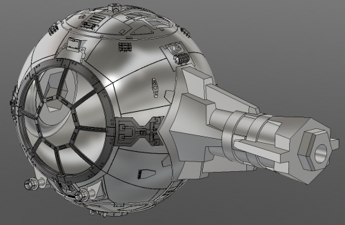

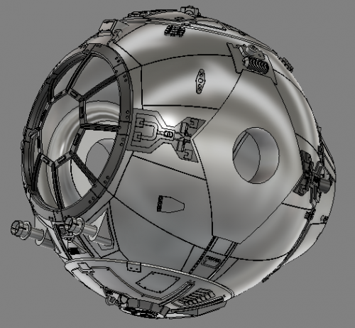

So I'll start this first post with a handful of pics of the current progress of my TIE. I started with a 5.25" sphere and proportioned the canopy, rear cone, top hatch, and bottom hatch from available prop pics. Complex parts are modeled in separate files and then assembled together in another file. I have sought to link geometries sensibly using Fusion's parametric timeline feature, so adjustments to dimensions should propagate downstream with (hopefully) few errors. For example, I can change the canopy ring diameter and all the window mullions and details will stretch appropriately, and the cockpit hole will automagically resize to accommodate the change. I'd be happy to delve into more specific Fusion 360 modeling techniques if anyone is interested - we can tailor this thread to suit the audience.

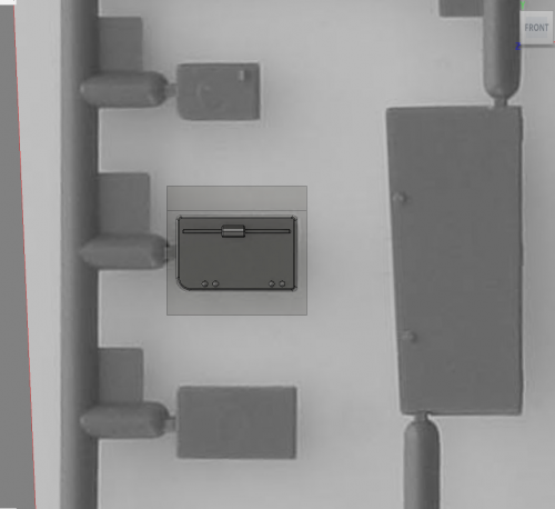

You'll see in a couple pics that I have leveraged the kit part scans to refine some of the detail pieces. I import the scan as a canvas in Fusion and use the calibrate feature on the rulers that are included in the scans. I then draft the outline sketch directly over the top of the part and extrude it in 3D and add any further details. Having the kit scans available has been a new gold mine for me! Big thanks to joewhite and all the others that have worked on these parts maps and kit scans.
And yes, I am definitely going to release all the STL files and Fusion 360 files so ya'll can play around with this as you please. For free, of course! I figure that I'll post the files in stages when I have reached certain milestones in the model's completion. I think a logical first goal will be to complete the cockpit assembly with some provision for mounting the wing pylons, and then post all of those files. I will follow up with my own 3D printing process and assembly to keep this thread fresh and "real"Wink
Of course, your thoughts and comments are solicited, but this will mostly be my own artistic interpretation of the source material, so I reserve the right to make the model "correct to my eye". Although you will be able to make changes to the model to your heart's content! There is actually a collaboration feature in Fusion that allows multiple users to work on the same model concurrently - some sort of cloud digital wizardry tracks the changes and users can ratify changes. I haven't messed with this feature, but I could be cajoled into this if a like-minded group of folks wanted to play (it would certainly accelerate the timeline based on my pace so far...)
As a first request of this forum, I would like to burden some kind soul with the task of a higher res image of the 1/35 Tamiya 8Rad hinged port that is part 7 in Joe's map (the detail at the front edge of the top hatch - circled in red below). The current kit scan image is a little blurry and I'd like to refine this part on my model. Thanks!

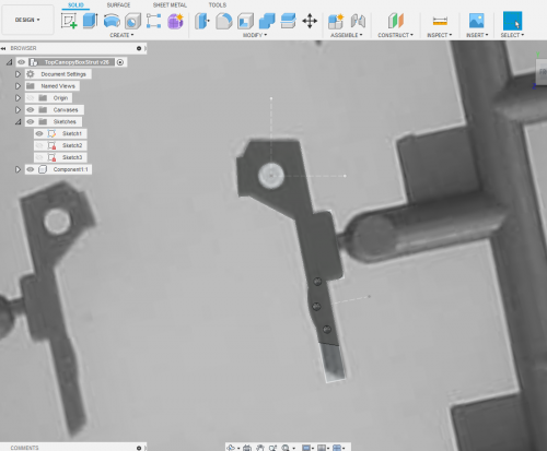

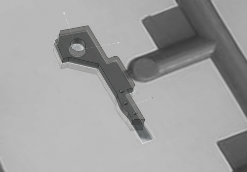

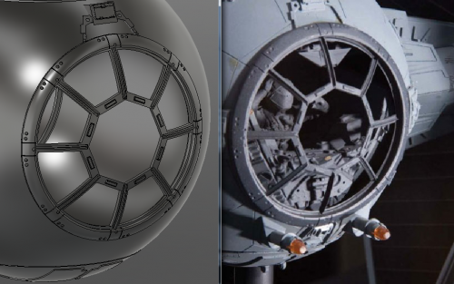

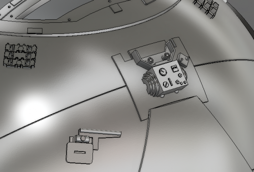

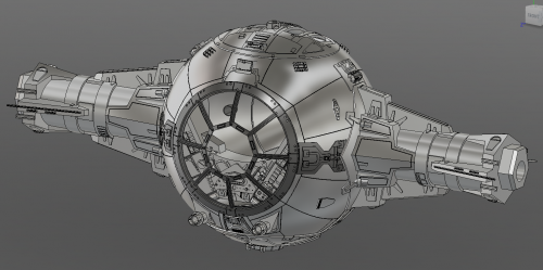

Well, I haven't made as much progress on the model in the last week as I had hoped for. The pic below shows that I focused on the Hetzer tank track details, the 8Rad part that Hammer helped me out with, and the box/struts above the canopy. I'm probably laboring over these details too much, but it is satisfying to compare it to the studio model and see that things just "look right". I want this to be a model that the rest of the community can embrace as the next best thing to having a well-done studio model reproduction kit.
I certainly spent waaaay too much time pouring over forums to research the cockpit ball size - 5.0" vs 5.25" and every dimension in between. I combed through every studio model pic that I had to estimate the size from known dimensions of kit details, then factoring in camera perspective distortion, etc. Pretty sure that I could justify just about any of those measurements depending on what source image I used for scaling. But it did seem to work out closer to the 5.25" side more than not. Apparently a 133mm Plastruct ball may have been utilized by the model makers, so I'll stick with this for now and see how the rest of the details fit.

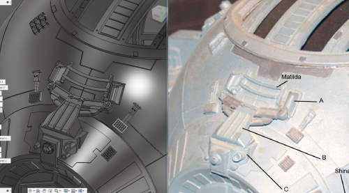

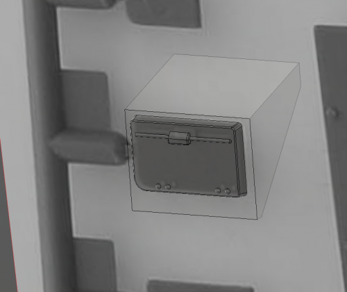

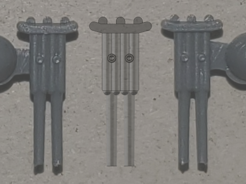

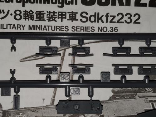

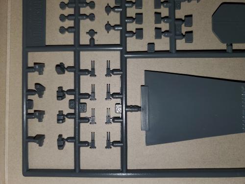

I do have another request, of course. The pics below illustrate my attempt to model the 1/700 Tamiya Shinano part #52 as used for the "clamps" placed around the perimeter of the rear cone on the TIE. These are simplified versions of the anti-aircraft guns that the actual carrier had on board. I don't have anything higher resolution than the images shown behind the 3D model, so I'm not sure if I'm getting it right. It would be nice to see it "in the round". Does anyone else have a higher res pic(s) to donate to the cause?
Thanks again!

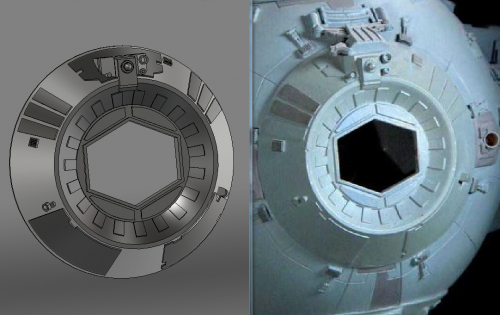

RE: Autodesk Fusion 360 Model - waterarc - 03-22-2020

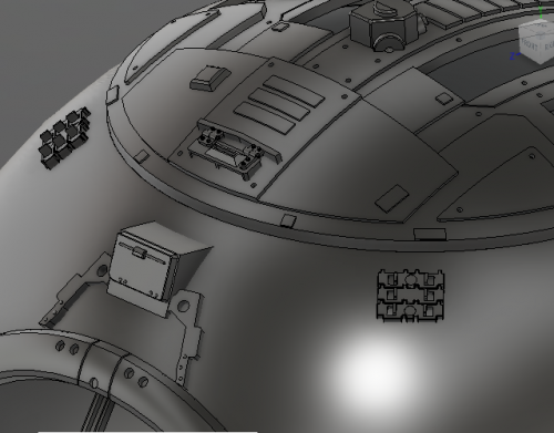

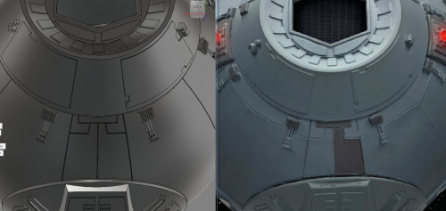

As there's not much else to do right now while we wait out the virus, the TIE is getting some more attention.  Big Grin
I am experimenting around with the placement of the rear cone "clamps" that are the Shinano parts. I'll need to work on the spacing once I have the main hull panel lines put in place. Not looking forward to that - panel lines are a pain to model in 3d, at least in my experience. I'll have to post a quick tutorial on how I do it in Fusion 360 at some point. Maybe someone else has a better way...

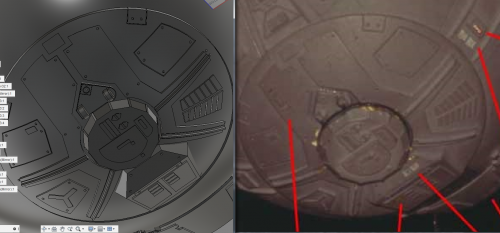

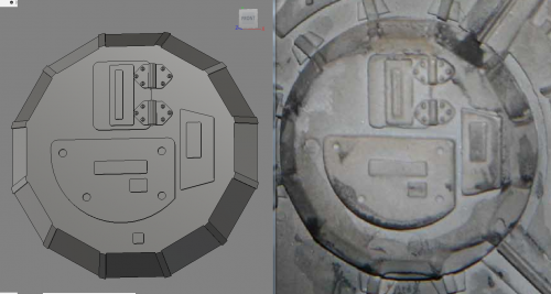

Also, I mostly finished the bottom hatch - just a couple proportions to adjust here and there, but I think it looks decent compared to the few studio model pics that I have. I'm sure that the detail is a little off on the central 12-sided plug, but this is the only decent pic I have that shows the actual studio model with the plug in place.
Once I get the cockpit ball to the point where I'm happy with how all the details are fitting, I'm going to start 3d printing some test pieces to see how things look. I'll need to get creative to fit the hull in the build volume of the Anycubic Photon that I'm using. I'll likely have to split it up in quadrants to fit, but I'll figure it out! I do want to add cockpit details at some point, but I'm going to focus on getting the hull complete so that I can post the STL files for anyone else who's interested in a physical build.
Here's a couple pics:
RE: Autodesk Fusion 360 Model - star-art - 03-23-2020
Nice work! The bottom mount "plug" is also on the front of the Rebel Blockade Runner so you should be able to get a better look that way. Smile
RE: Autodesk Fusion 360 Model - waterarc - 03-26-2020
Charles, thanks for the suggestion - I would have totally missed this fact. So I snooped on over to the blockade runner section for a nice shot of the nose, and voila - there it was! This allowed me to approximate a fairly close rendition of it.

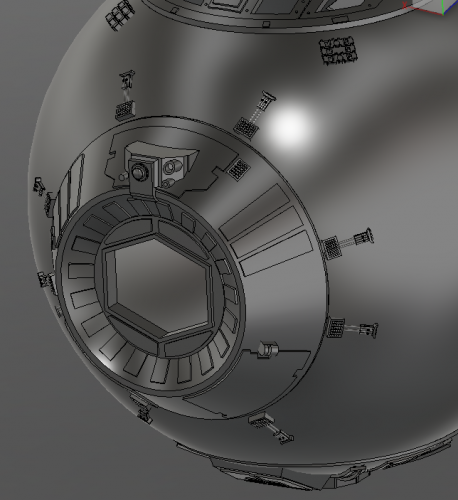

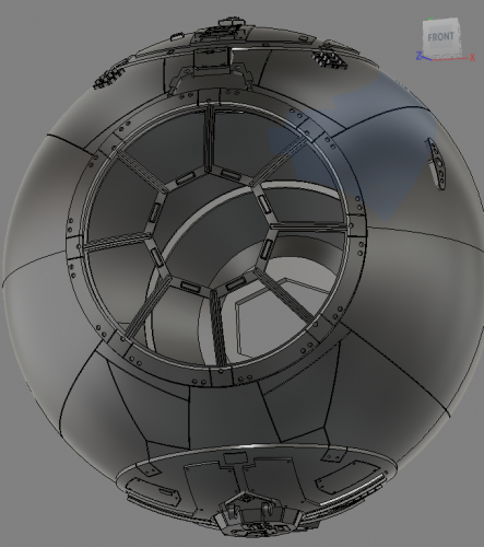

Currently I'm chipping away at the panel lines for the main hull. It's amazing how much more "real" a model looks with a couple panel lines.

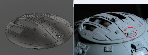

RE: Autodesk Fusion 360 Model - waterarc - 04-11-2020
Very kind words from both of you - it keeps me inspired to keep the greeblies flowing... Below you can see that I've been working on the detail at the rear of the top hatch. I was actually looking forward to modeling the M10 wheel bogey - I have a fondness for the Sherman family of tanks Smile I've also worked in the panel lines around the gun area on the chin. I hope to get the pew-pews modeled up here soon.

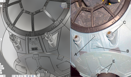

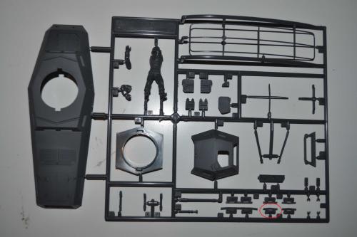

Hey, anyone have any idea what the kit part labeled "A" is? I can't seem to find it called out in any of the maps or associated threads, but I could have missed it.
Also, NS4 - I checked out your Narcissus page, and holy cow, for sure you understand the labor of love of modeling the details! I'm just a padawan compared to what you've done on that thing. Any time I start to feel overwhelmed and apathetic, I'll just hop on over to your page to remind myself that it's accomplishable.
And bg_451 - the resin printers keep coming down in price. The Anycubic Photon that I have will reproduce extremely fine details (I print D&D minis as another hobby), and it can be had for under $300 US. They also just launched an even more economy version, the Anycubic Photon Zero for right around $150 US! For resin, I can highly recommend Siraya Tech's Fast Resin - it's relatively inexpensive, semi-flexible, sands very well, and takes paint great. Oh, and it doesn't stink like the other resins can - very important for not raising the ire of the significant other in the household...
RE: Autodesk Fusion 360 Model - waterarc - 04-13-2020

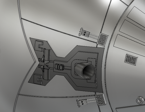

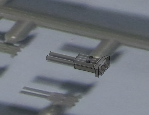

Guns and chin detail are completed. Note that the LED holders were slid down on the gun tubes in the studio model pic - other prop pictures show the guns extended out with the LEDs in place, which is how I have modeled them. Thinking ahead to printing these out, I have chosen to keep the gun tubes as a separate part - likely I will use the actual brass tubes for durability and to prevent light shine-through when the LEDs are lit. The gun bosses will be an integral part of the hull and have holes through to the inside of the hull for wiring.
In general, my practice for modeling details is to keep them as separate components that will be printed independently and glued on during assembly. I think this will look better for the most part. However, the resin printers have absolutely no problem with fine details, so some of the "flatter" details I may integrate onto the hull and let the printer do its thing. In any case, I intend to release the Fusion 360 files with all the details separate so that you can opt to go with whatever method your equipment is best suited for. I may offer the STL files with and without details separated - I think some folks are going to want to print this out at smaller scales (like 1:48) as mostly single pieces. On the other hand, some folks may want to print the bigger pieces on an FDM filament printer, sand/post prep, and then have the details resin printed. I'll try to ensure that all options are doable with my files.

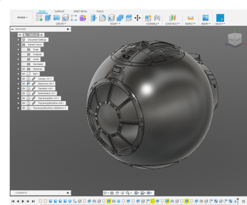

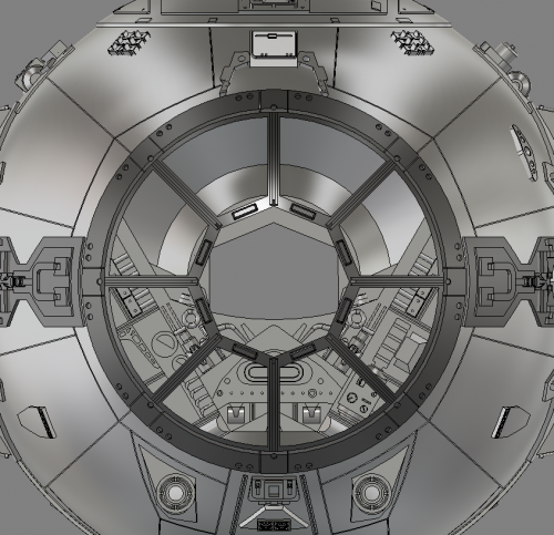

More progress pics. The cockpit ball is essentially complete with all details (I think I got them all). Again, thanks to everyone who has posted kit scans over the years - they were a big help in establishing the details for the 3D model. I need to do some prep work to make all the parts printable, and I still need to figure out the wing support tube issue - I think I want to (dare I say it) deviate from the studio model by making the cockpit interior be the full inside diameter like the interior shots with the actor pilots. This would preclude using the full wing support tube that runs through the center. I think I'll take a stab at modeling some of the interior to see what room I have to work in a support structure. There may be some creative use of neodiddlyum (AVE - YouTube) magnets for holding this together. Anyway, I'm going to kick out a couple STL files here and see how some of these parts print, as I'm itching to get started on the physical build.

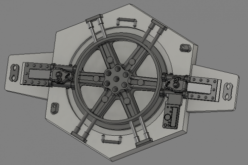

Roughing in the shapes of the wing pylon. This will help me figure out the cockpit "roll cage" support structure while still providing room for a detailed interior. I've made the plug that inserts into the cockpit poka-yoke to aid with proper alignment - same for the wing panel attachment.
I think magnets are a good solution for the hatches, canopy, and rear cone, but I'm wondering about the weight of the finished wings when fabricated from a buildup of sheet/cardstock and laminated with resin details. I have no delusion that I'm going to land any KoolShade, so I'm resolved to creating a resin-printable facsimile. Any advice on finished wing weights? Should I stay away from using magnets on the wings and pylons and go with a mechanical fastener?

RE: Autodesk Fusion 360 Model - Hammer3246 - 04-22-2020
The wings will be very heavy, I'd go the mechanical route. I have a SS resin printed TIE that I purchased on FB, I don't think I'd trust a magnet to hold them on.
