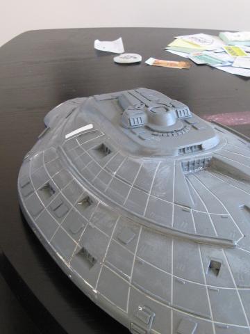

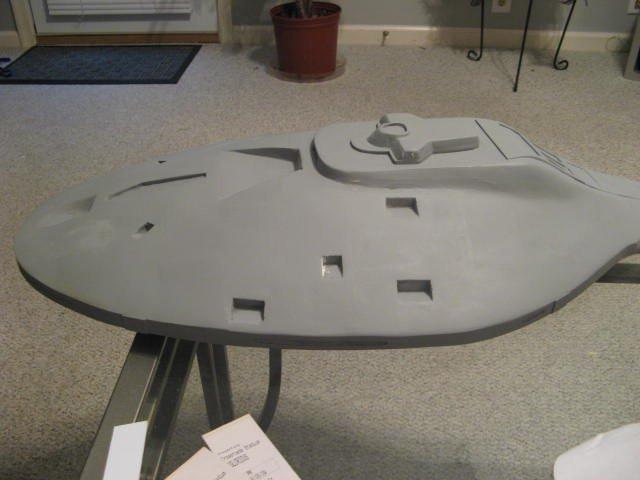

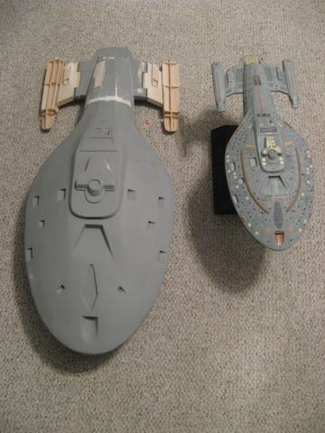

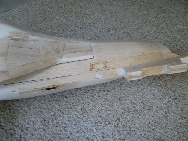

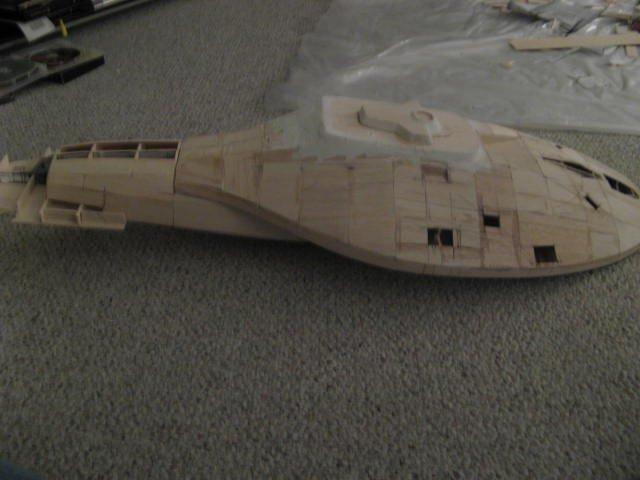

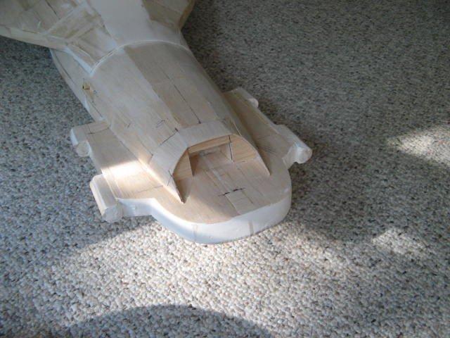

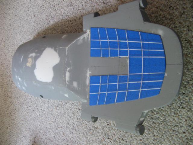

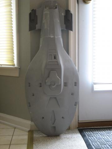

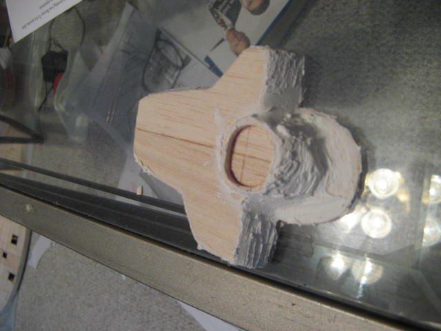

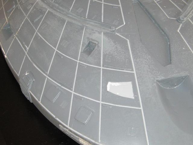

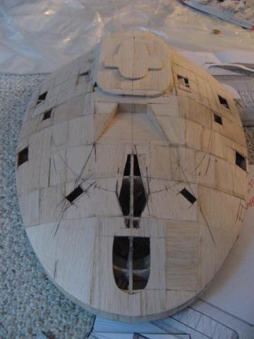

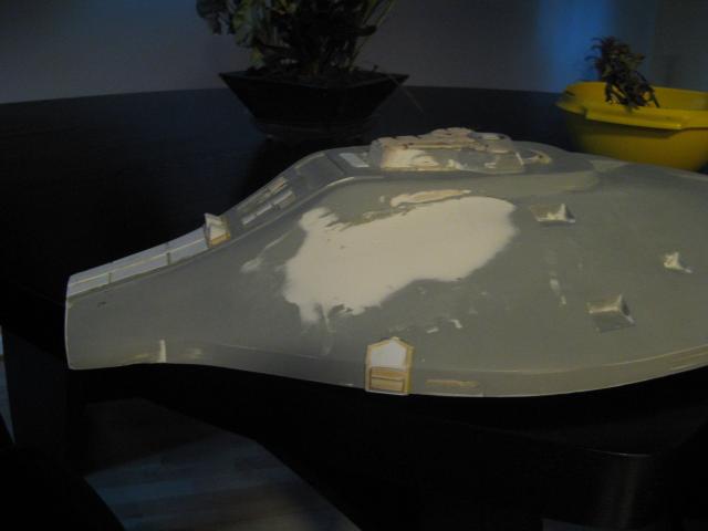

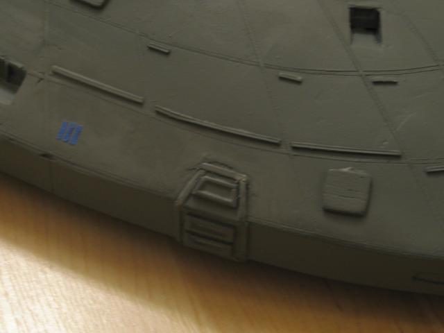

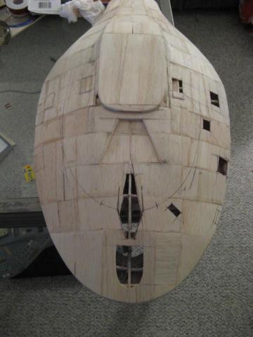

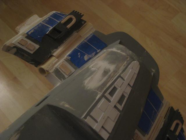

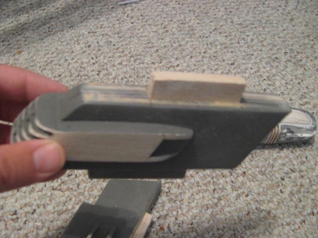

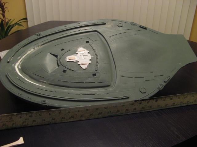

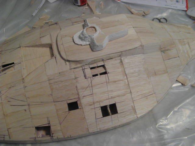

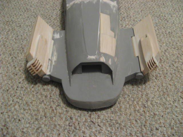

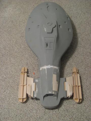

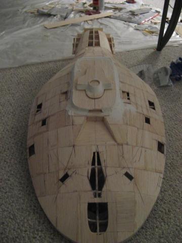

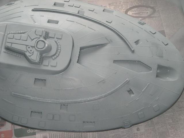

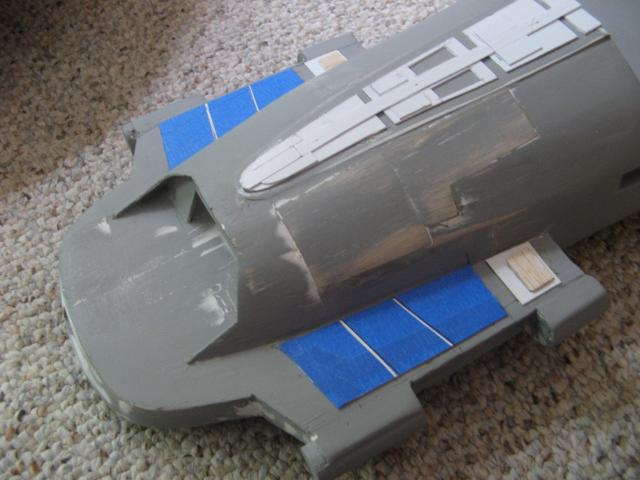

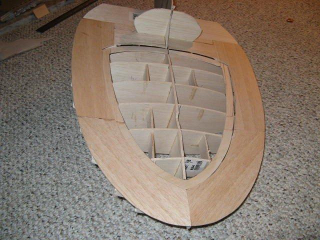

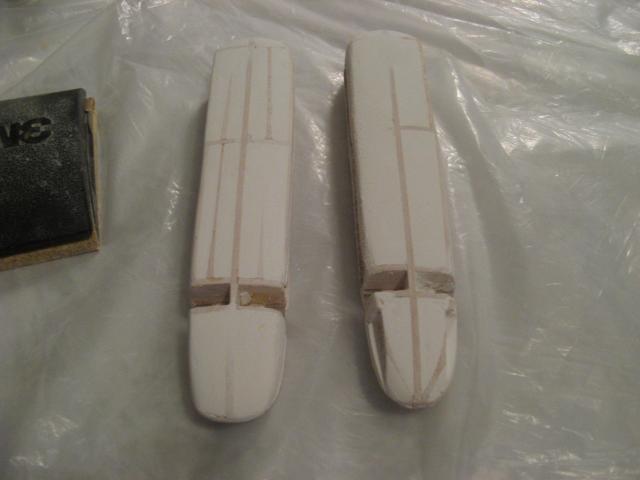

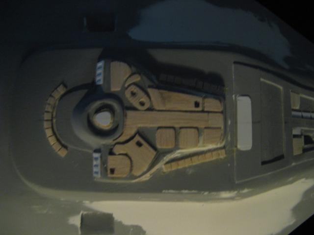

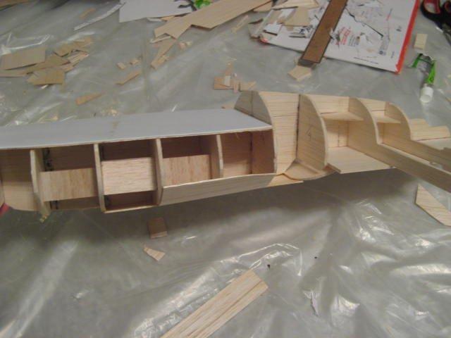

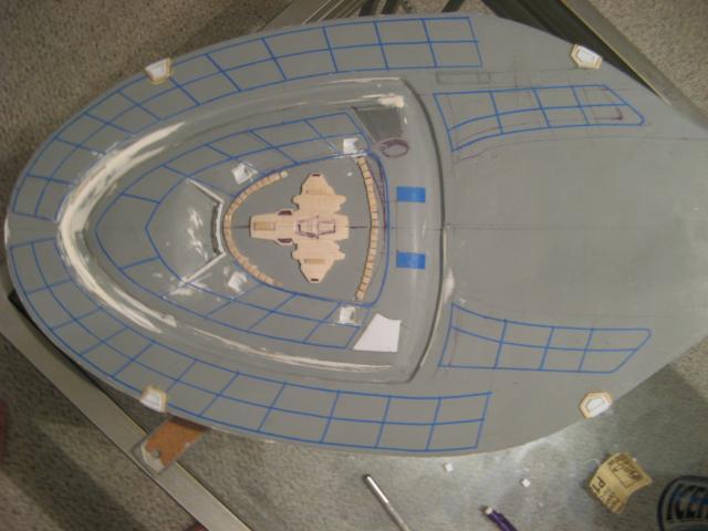

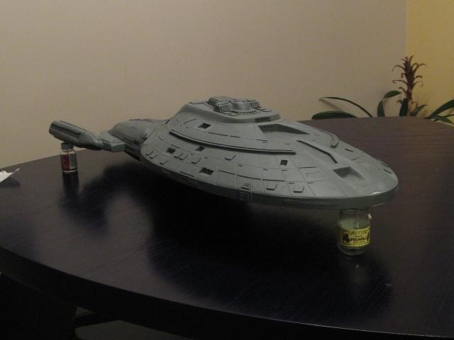

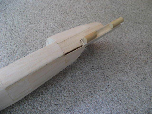

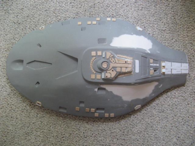

Hey Guys,
I haven't posted a lot because the main reason is I have spent most of my modeling time working on this 1/350 scale Voyager scratch build.. I've spent countless hours working on this and I am almost done! One reason I didn't post it sooner is I sort of had plans for this and since I don't do this full time..I wanted to get far enough ahead of the game before I posted it .. well, that time has come. All the parts were made by hand.... except the sensor array parts. I'm working on those now.. but have been unsuccessful in identifying the correct model parts for those.. so, Im sort of mixing and matching stuff together to make it work..
I've made plenty of mistakes on this.. and corrected plenty of mistakes.. and some, well, I'll just have to live with....For my 2nd major scratch build, I consider this a success. Plans are to mold and cast this.. Mold it in Fiber Glass, light it up and then we'll have the beauty that is the Voyager ship... I do have to say that I miss buildining plastic kits.. Here goes
[attachment=1828][attachment=1829]
[attachment=1830][attachment=1831]
[attachment=1832][attachment=1833]
[attachment=1834][attachment=1835]
[attachment=1836][attachment=1837]
[attachment=1838][attachment=1839]

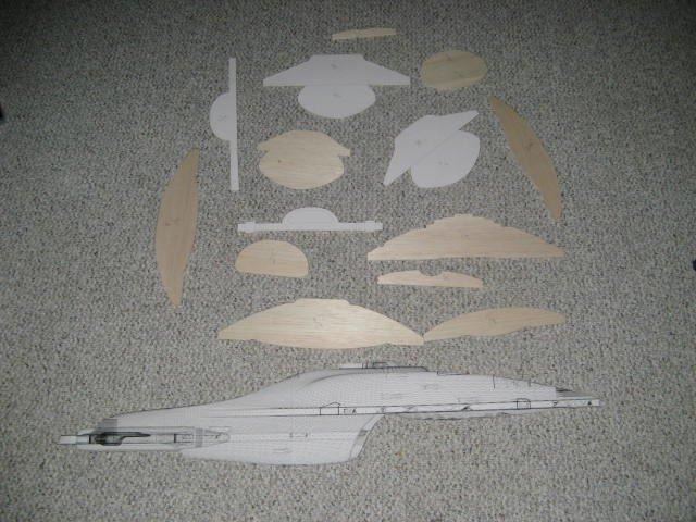

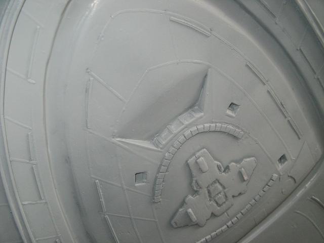

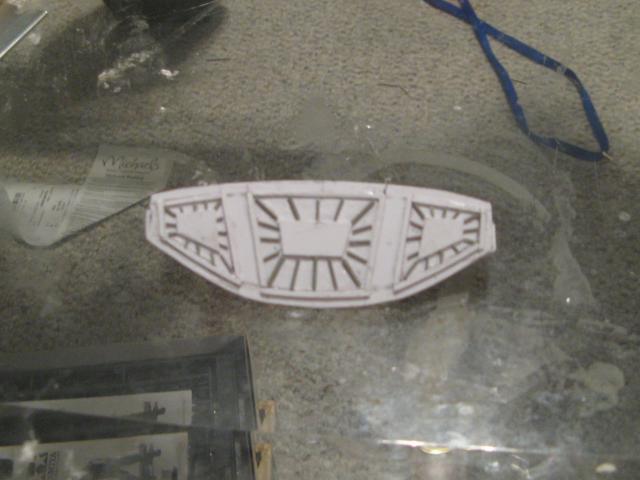

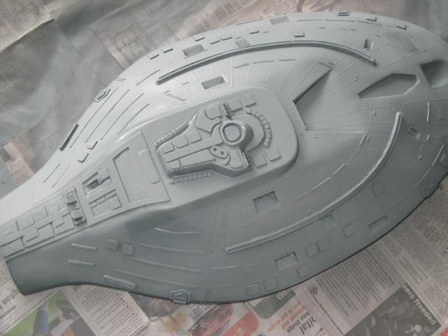

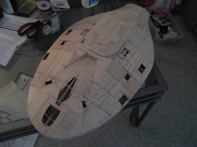

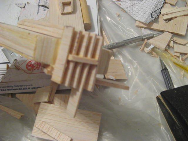

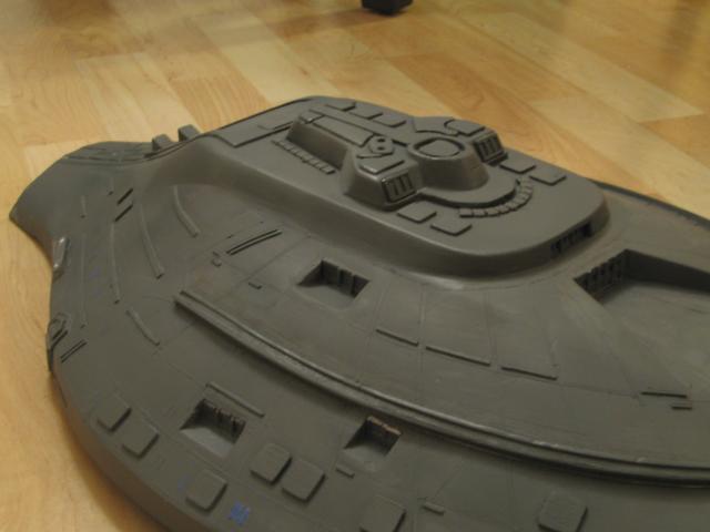

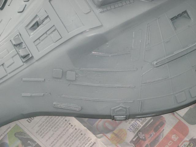

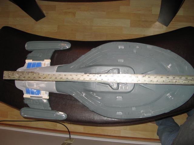

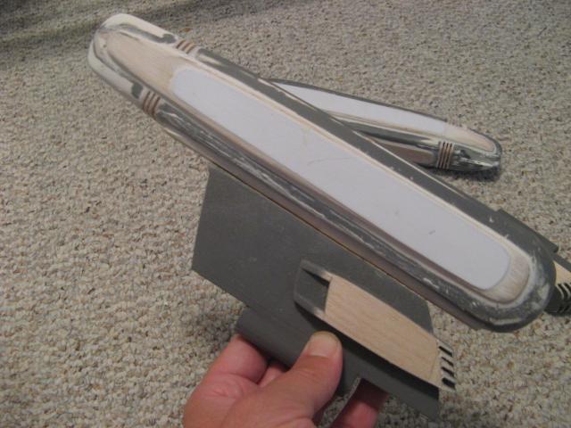

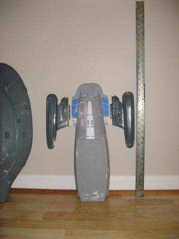

RE: 1/350 Scale Scratch Built Star Trek Voyager - erospawn - 12-29-2009

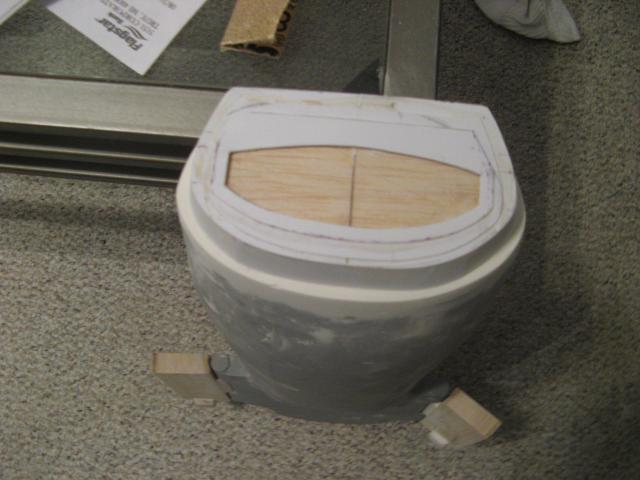

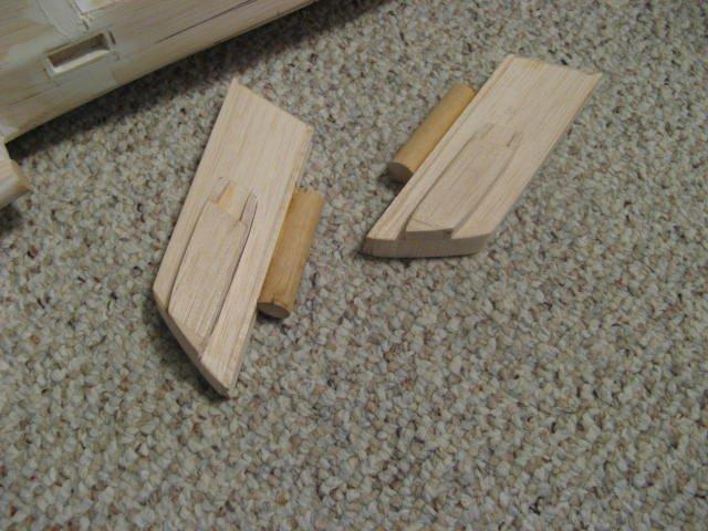

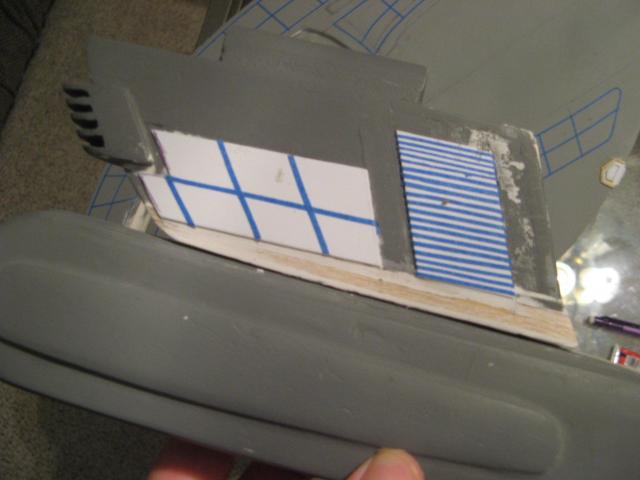

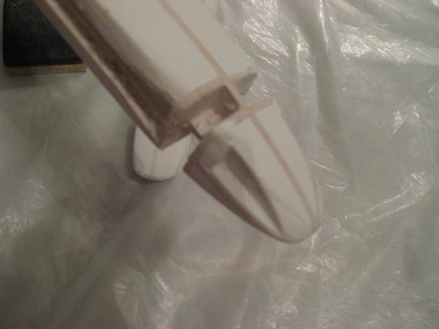

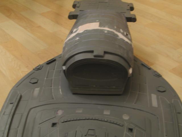

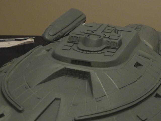

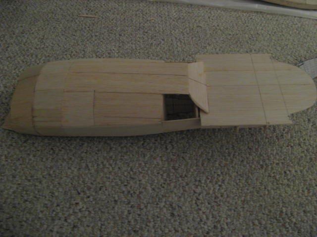

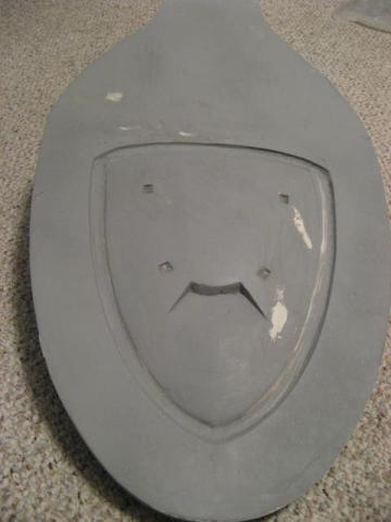

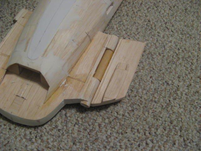

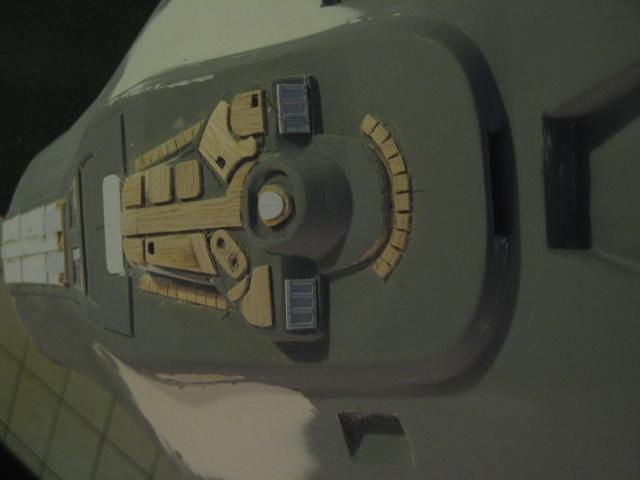

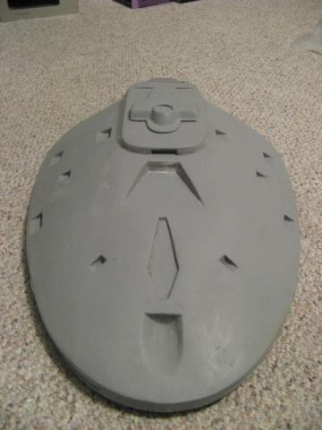

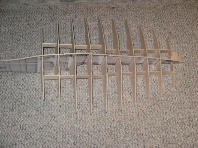

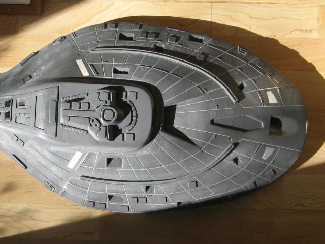

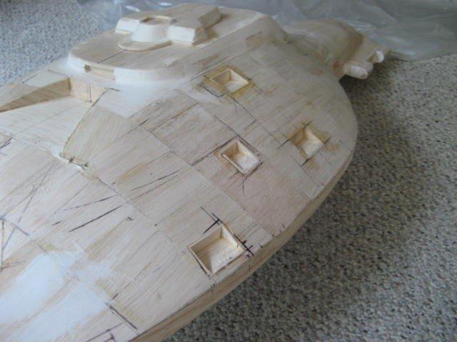

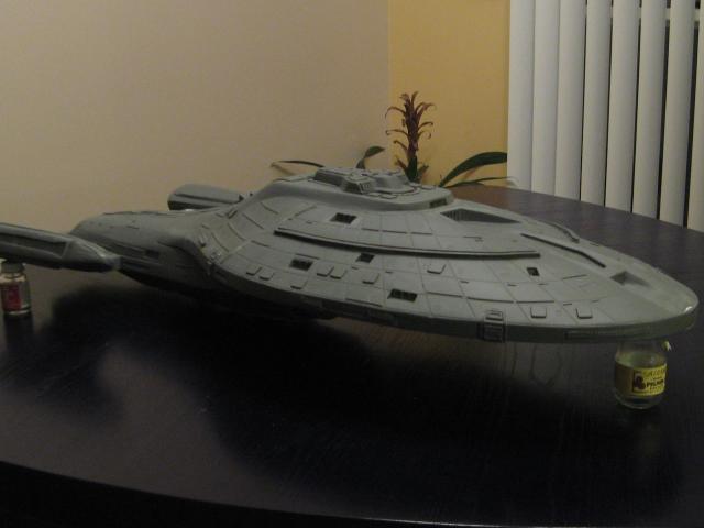

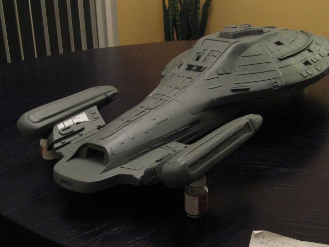

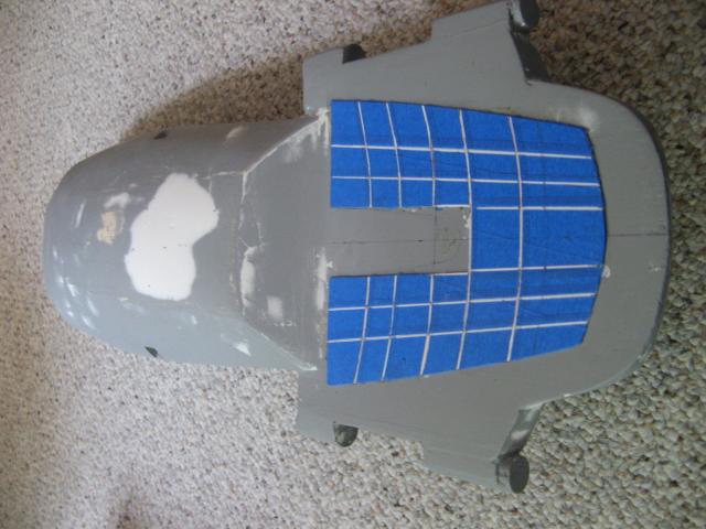

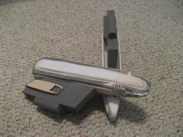

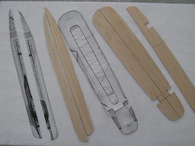

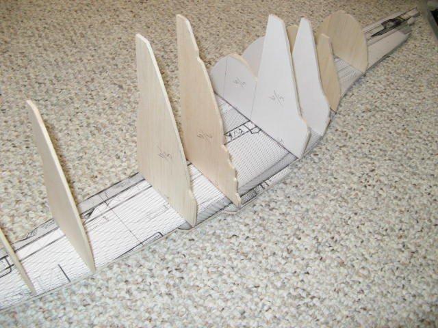

More photos. Im not really adding descriptions to each picture because it seems for the most part self explanatory.. If you have any questions.. just shoot Smile
[attachment=1840][attachment=1841]

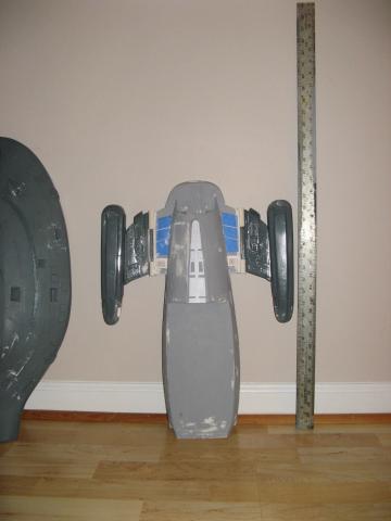

[attachment=1842][attachment=1843]
[attachment=1844][attachment=1845]
[attachment=1846][attachment=1847]
[attachment=1848][attachment=1849]
[attachment=1850][attachment=1851]

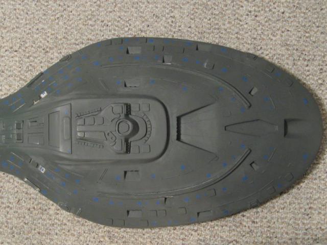

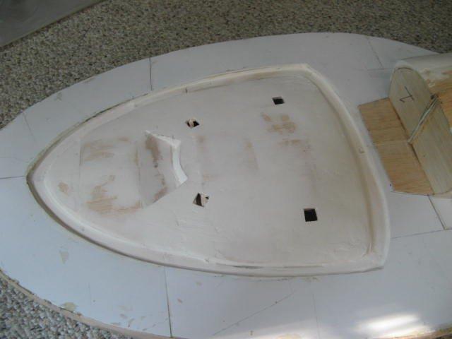

RE: 1/350 Scale Scratch Built Star Trek Voyager - erospawn - 12-30-2009

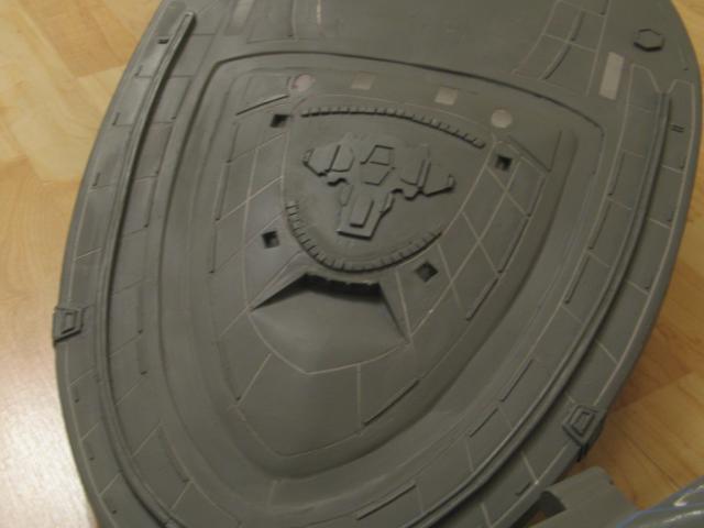

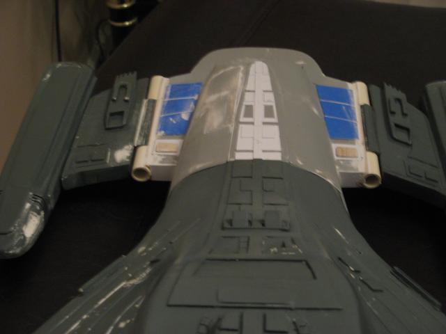

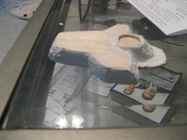

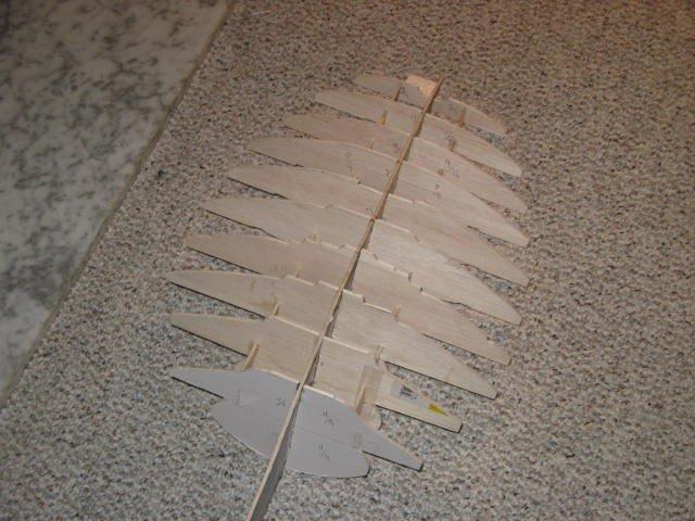

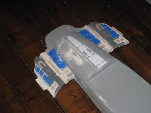

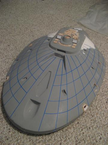

Here's a few more:
[attachment=1861][attachment=1862][attachment=1863][attachment=1864][attachment=1865][attachment=1866][attachment=1867][attachment=1868][attachment=1869][attachment=1870][attachment=1871][attachment=1872]

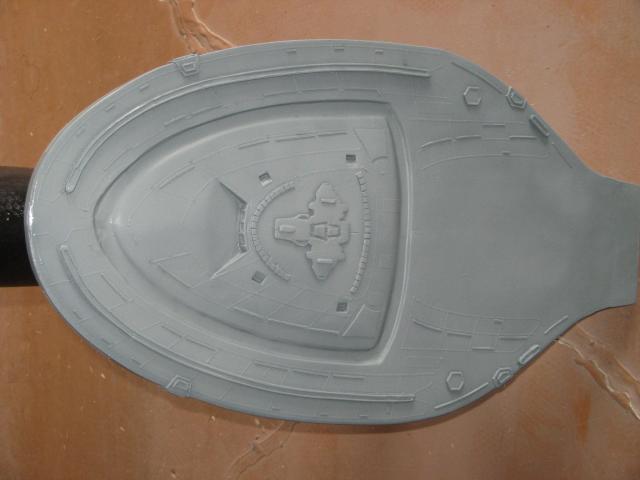

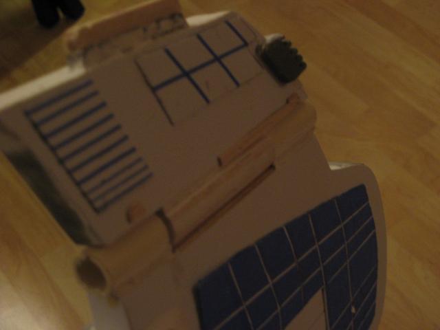

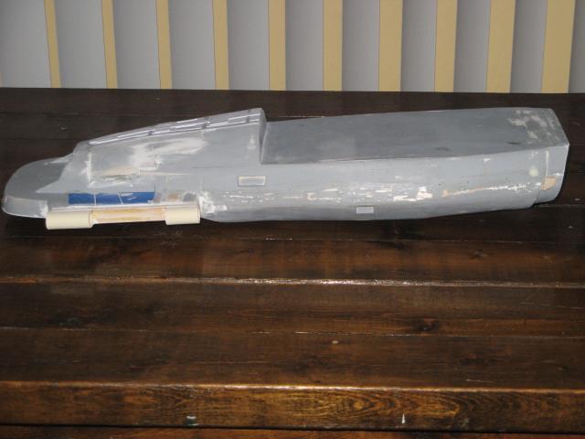

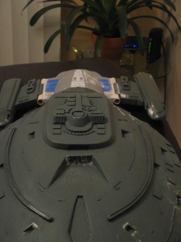

OK.. Here's a few more... remember, if there are any questions, just shoot.
[attachment=1873][attachment=1874][attachment=1875][attachment=1876][attachment=1877][attachment=1878]

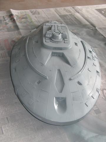

I work really really fast Tongue Here's some more Big Grin
[attachment=1879][attachment=1880][attachment=1881][attachment=1882][attachment=1883][attachment=1884][attachment=1885][attachment=1886][attachment=1887][attachment=1888][attachment=1889]

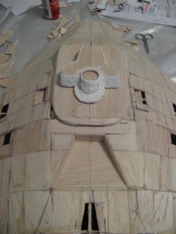

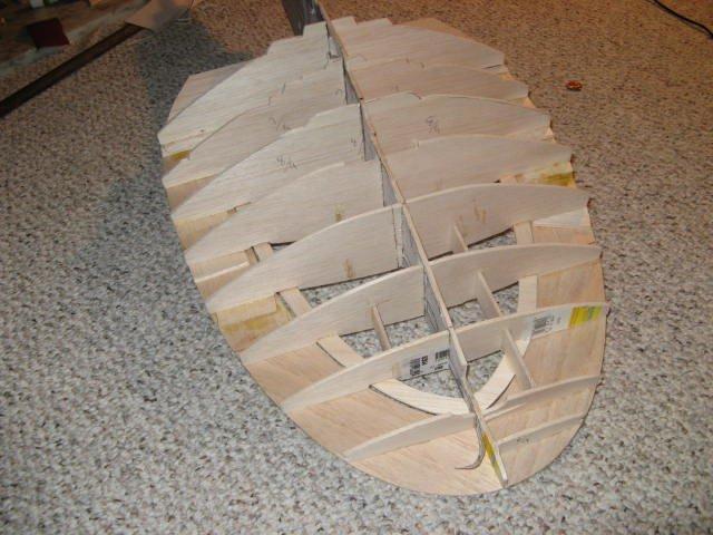

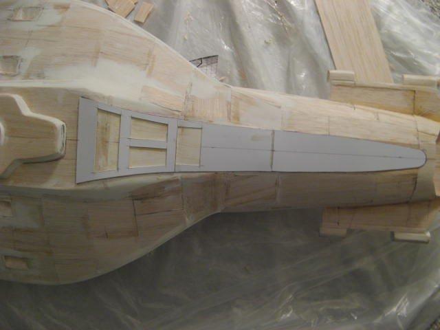

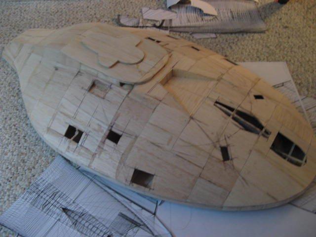

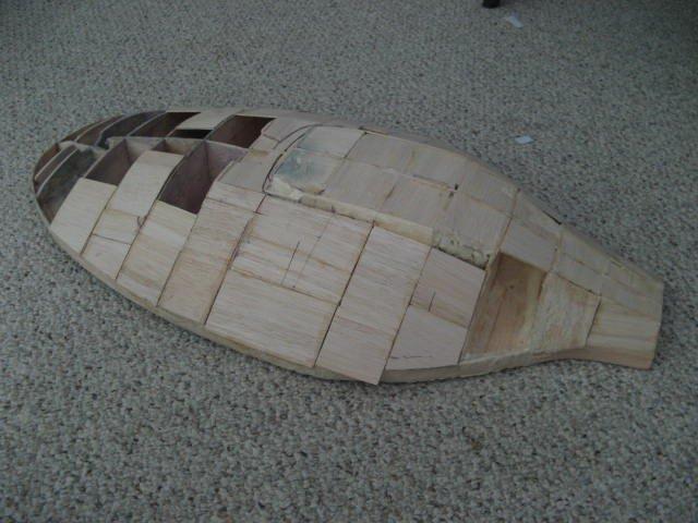

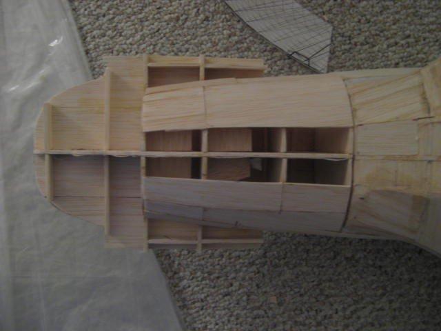

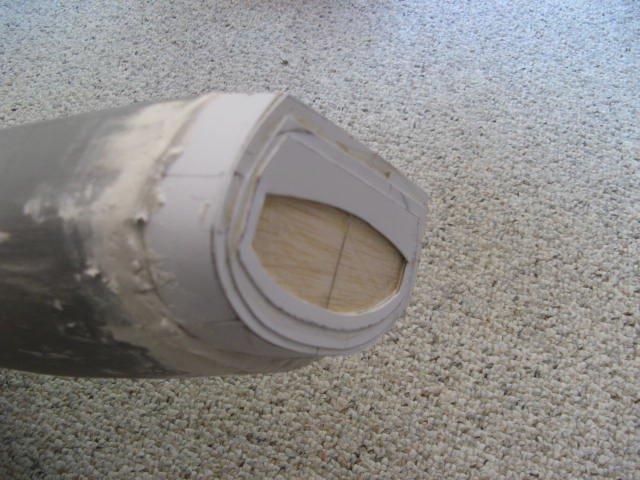

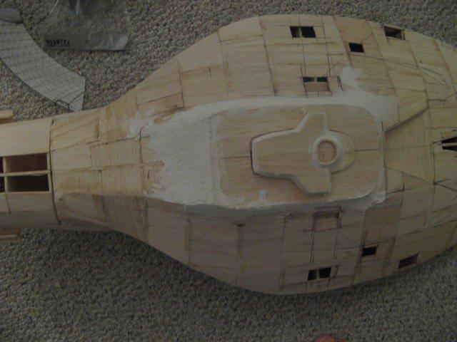

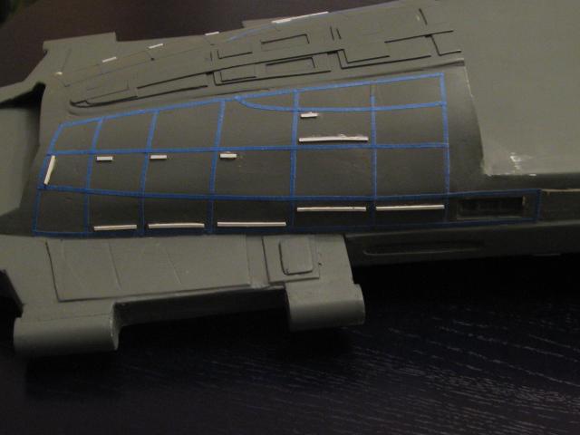

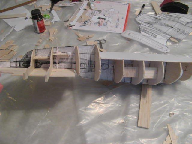

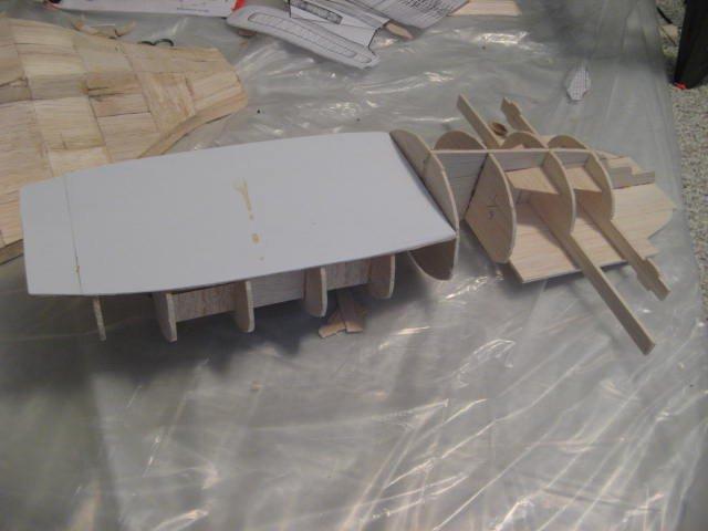

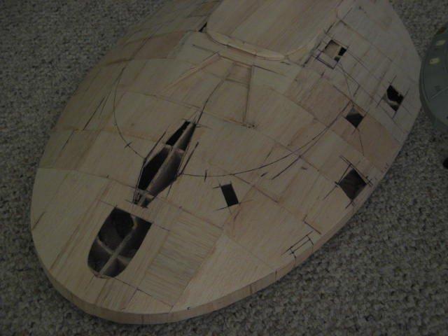

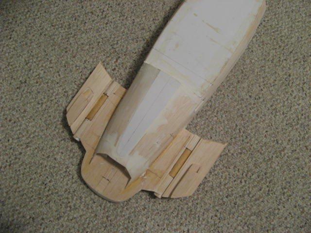

RE: 1/350 Scale Scratch Built Star Trek Voyager - dbhs - 12-30-2009

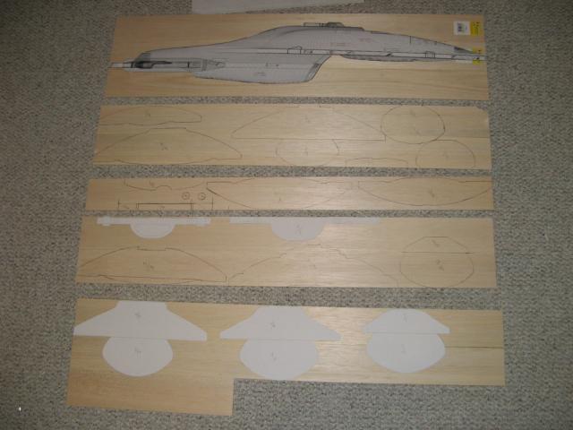

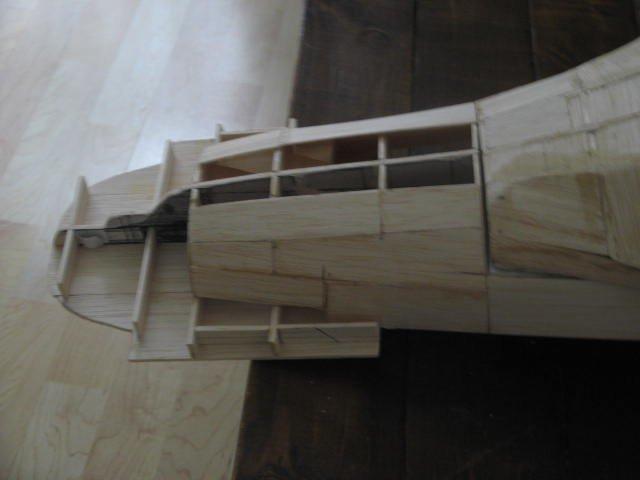

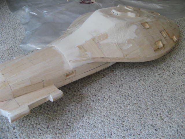

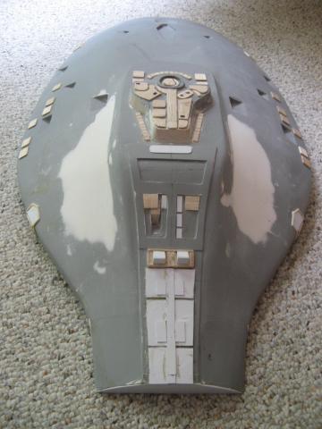

How did you get started using wood? Are you more comfortable using wood than styrene? I've used wood before making a remote control glider and found it a great material to use but I never tried it on a sci-fi build before.
I like the first couple where the texture is really rough and there's still some openings in the hull. I know that's part of the progress but those shots remind me of the ship during the 'Year of Hell' episodes.
What is the gray material you are using over the wood? How thick are you putting it on?

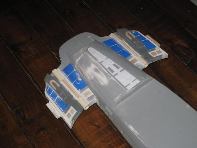

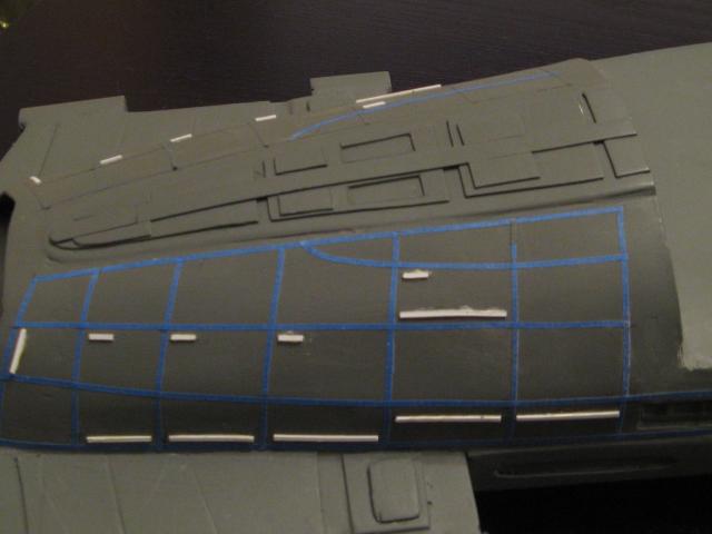

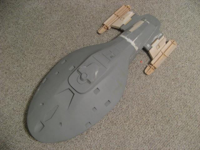

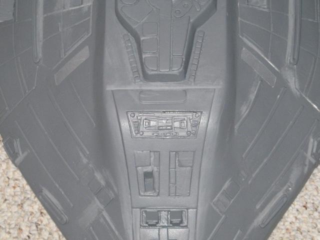

I am almost done.. here's some more pics...
[attachment=1890][attachment=1891][attachment=1892][attachment=1893][attachment=1894][attachment=1895][attachment=1896][attachment=1897][attachment=1898][attachment=1899][attachment=1900][attachment=1901]
[attachment=1902]

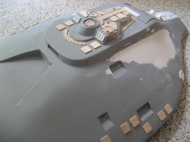

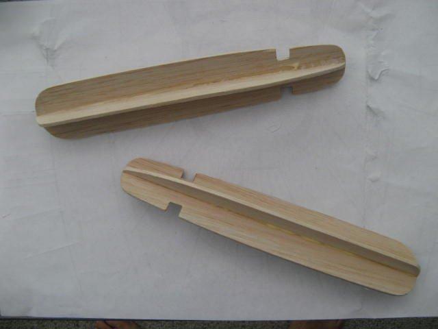

(12-30-2009, 12:57 PM)dbhs Wrote: How did you get started using wood? Are you more comfortable using wood than styrene? I've used wood before making a remote control glider and found it a great material to use but I never tried it on a sci-fi build before.
Well.. Wood just seemed the natural material to use.. easily sanded, durable etc etc.. But, to tell you the truth, I'll probably be doing something a little bit different next time..Modelnutz was telling me about a material that was like a combination of styrene and balsa..thats sounds pretty nice.
(12-30-2009, 12:57 PM)dbhs Wrote: I like the first couple where the texture is really rough and there's still some openings in the hull. I know that's part of the progress but those shots remind me of the ship during the 'Year of Hell' episodes.
The good news.. once it is cast into a kit, pretty much what ever can be done to it can be done Smile .. My goal here is to make a kit out of it.. and then build it and light it up.. and hopefully sell a few while I am at it.. who knows though.

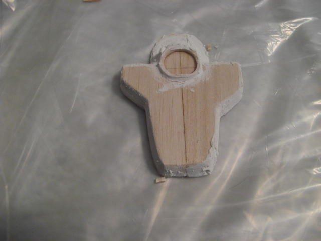

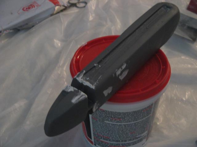

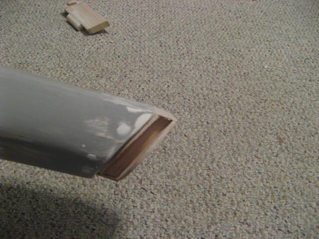

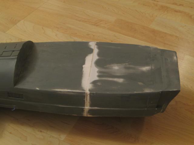

(12-30-2009, 12:57 PM)dbhs Wrote: What is the gray material you are using over the wood? How thick are you putting it on?
Basically, I built it out of wood.. and filled in the gaps and errors etc with spackling material.. I also tried a little bondo on the warp engines as well.. It works well, but not nearly as easily sanded as the spackle material. The rest of it is basically gray primer..

Thanks for the compliments man! It's 3 foot long and at its widest point is 14 inches wide. It'll go nicely next to you Polar lights Enterprise! Tongue Actually, its pretty suprising to realize that this ship is actually bigger than the PL 1/350 Enterprise..

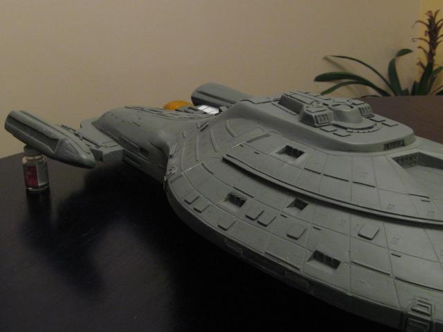

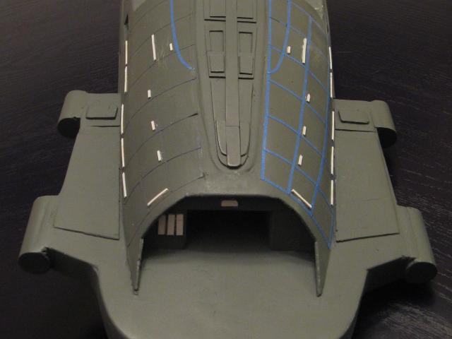

RE: 1/350 Scale Scratch Built Star Trek Voyager - erospawn - 12-31-2009

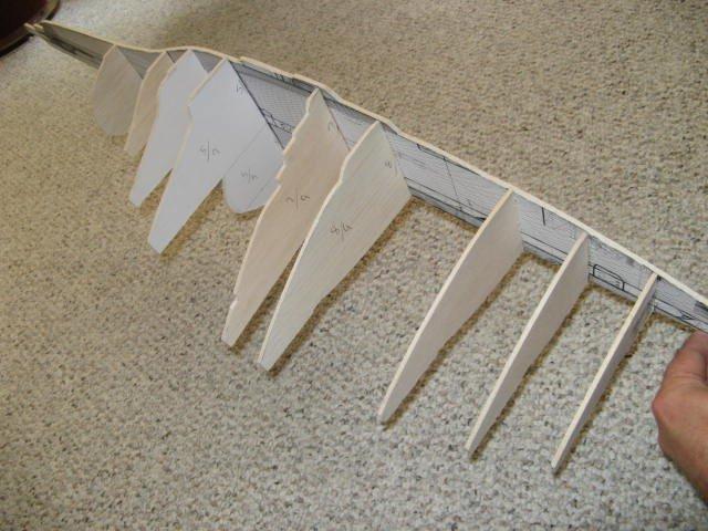

Alrighty... Here's some more pics Smile
[attachment=1966][attachment=1967][attachment=1968][attachment=1969][attachment=1970][attachment=1971][attachment=1972][attachment=1973][attachment=1974][attachment=1975][attachment=1976][attachment=1977][attachment=1978][attachment=1979]

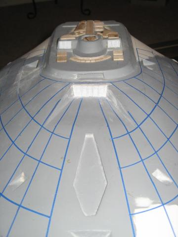

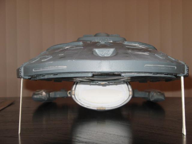

And I believe with the addition of these pics, we are all caught up to date Smile
[attachment=1994][attachment=1995][attachment=1996][attachment=1997][attachment=1998][attachment=1999][attachment=2000][attachment=2001][attachment=2002]
Here are the latest and most up to date pics! Gotta love 'em Tongue
[attachment=2003][attachment=2004][attachment=2005][attachment=2006][attachment=2007][attachment=2008]

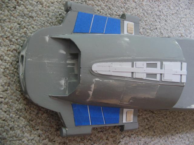

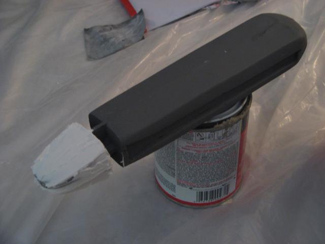

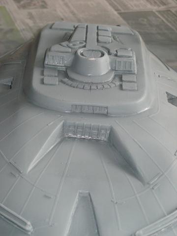

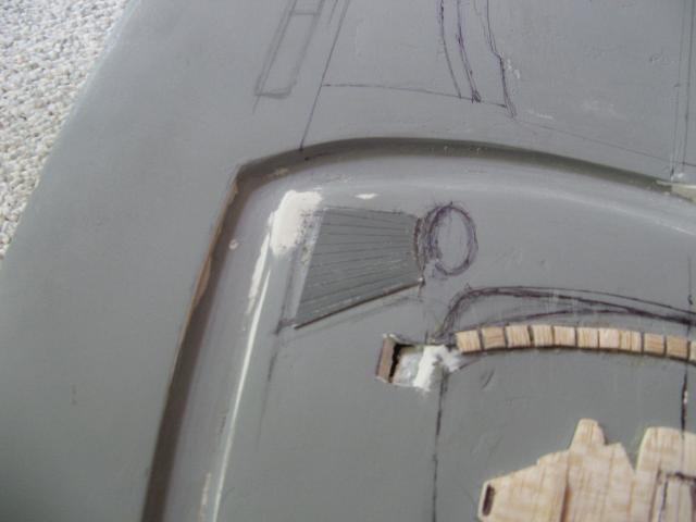

RE: 1/350 Scale Scratch Built Star Trek Voyager - 427 Cobra - 12-31-2009
I didn't know that you were having trouble with Bondo,Ron. I use Elmers brand woodfiller. I SWEAR by it! This stuff dries fast,it sands easily,and it fills the tiniest cracks,and gaps perfectly. It's waterbased,and it can be removed if you make is mistake without ruining your model. It's also very maleable (soft),so that you can sculpt with it. You'll have to add a little at a time to build up large areas,but it dries hard as a rock in a week,so you don't have to worry about it falling out. Best of all,it won't ruin soft plastic parts,and it can be painted with automotive acrylic,or lacquer,enamel,or waterbased acrylics.
thanks for the advice.. the stuff Im using works quite well too. and can be painted sanded etc...The bondo was ok.. but was not as easily sanded etc..

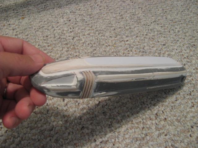

RE: 1/350 Scale Scratch Built Star Trek Voyager - erospawn - 01-06-2010

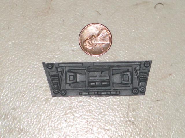

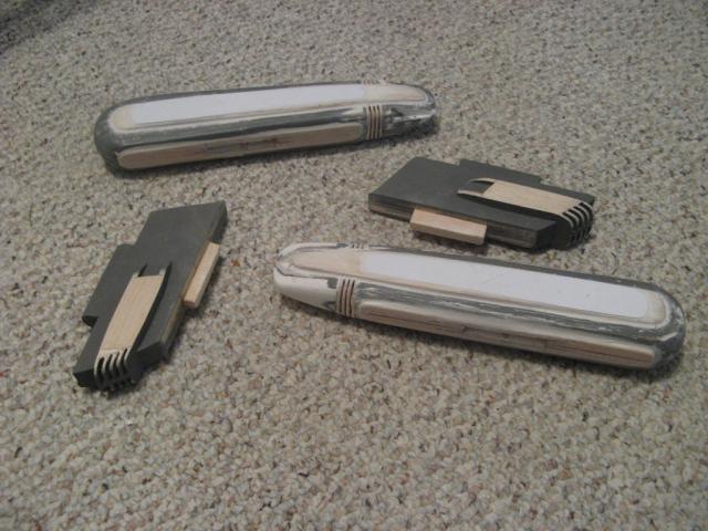

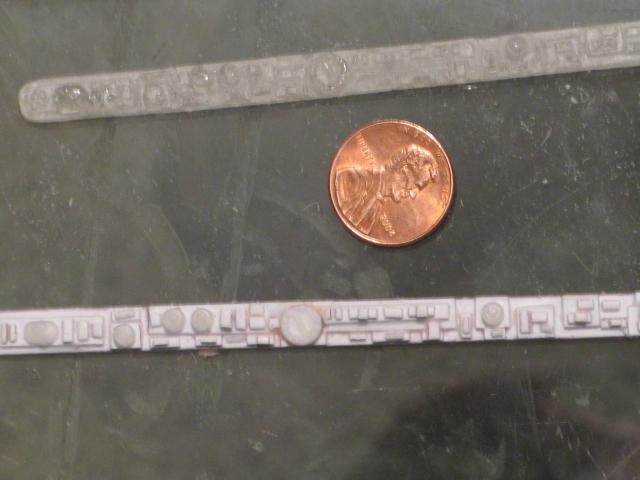

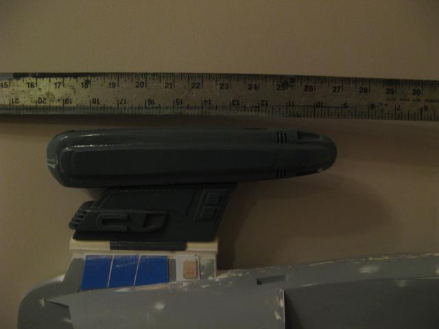

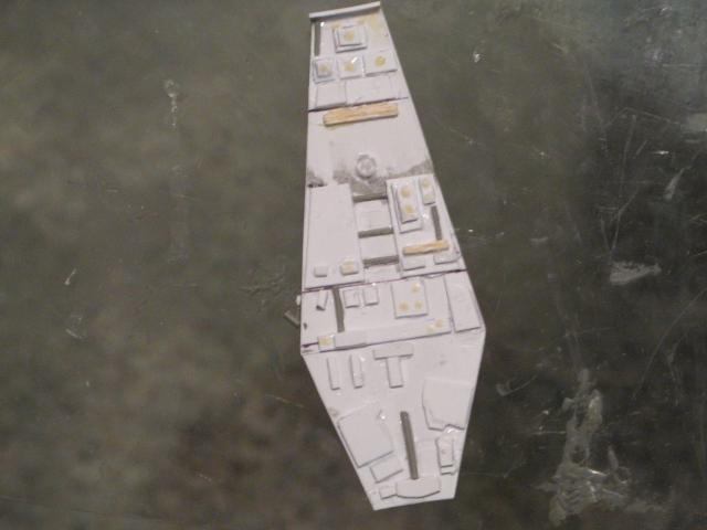

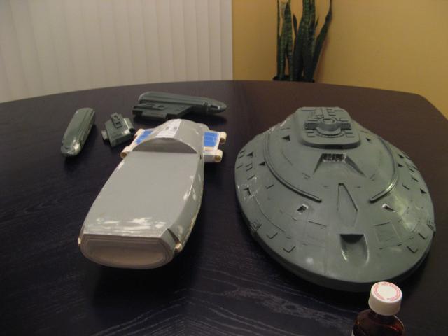

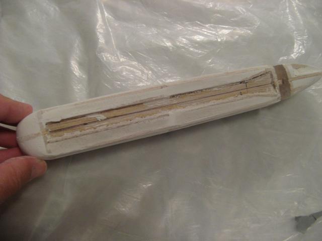

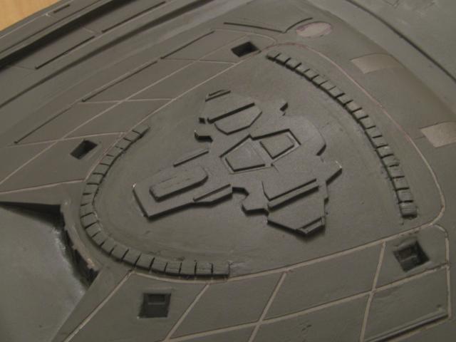

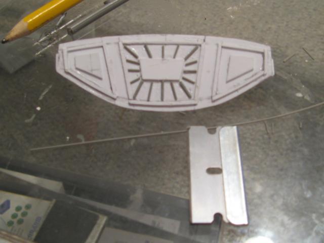

I haven't exacly had a lot of success id'ing the parts that make up the sensor arrays.. so I've been making them by scratch...
[attachment=2156][attachment=2157][attachment=2158]

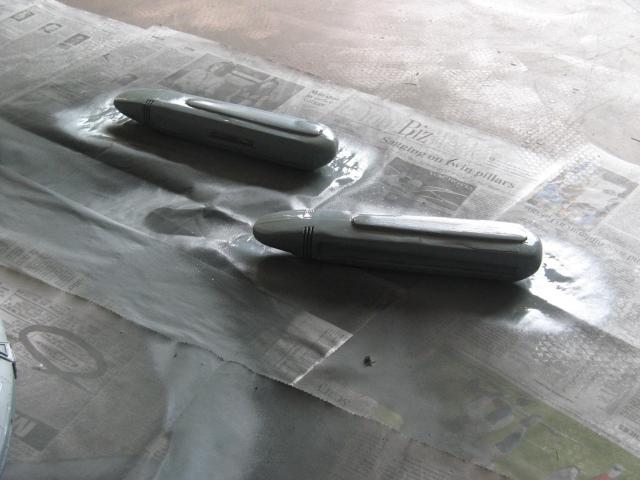

RE: 1/350 Scale Scratch Built Star Trek Voyager - erospawn - 01-16-2010

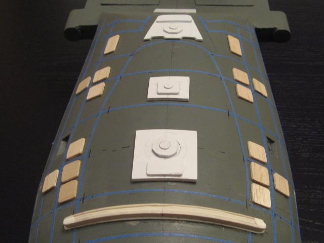

so, here's an update.. although almost done.. I decided to redo the sensor arrays on the side of the ship.. I ended up making the parts by hand. I designed one peice, molded it, and then cast several copies..
The pics below show the original along with a copy.
[attachment=2460]
