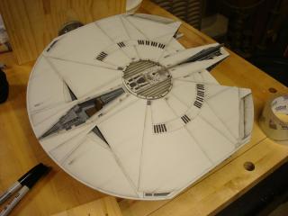

RE: Studio Scale McQuarrie Concept Raider - dbhs - 02-01-2010
Thanks for the feedback, guys. I got a lot done this weekend.
I sacrificed a couple of pens to build the guns. There's some additional parts from the pens that I can use on this as well.
[Image: ConceptRaider-20.JPG]
[Image: ConceptRaider-21.JPG]
[Image: ConceptRaider-22.JPG]
The first layer of plating is glued on.
[Image: ConceptRaider-23.JPG]
[Image: ConceptRaider-24.JPG]
[Image: ConceptRaider-25.JPG]
[Image: ConceptRaider-26.JPG]
Here is the projection under the engines under construction.
[Image: ConceptRaider-27.JPG]
Here it is with the rib detailing added on. The two flat areas directly forward of this will have big grilles placed in them. I'm going to use the grilles from the Centurion Tank Wink for these (used on the top part of the Studio Raider behind the cockpit). The details on that piece will look good there.
[Image: ConceptRaider-28.JPG]
[Image: ConceptRaider-29.JPG]
[Image: ConceptRaider-30.JPG]
Here's the top view of the same area. I need to finish up around the engine compartment and then start working on the ribs on the top side.
[Image: ConceptRaider-31.JPG]

I got the ribs on the top side done and finished up the sides of the engine compartments. I also started cutting out the top side plating but not far along enough for pics just yet.
[Image: ConceptRaider-32.JPG]
[Image: ConceptRaider-33.JPG]
RE: Studio Scale McQuarrie Concept Raider - JAWS - 02-08-2010
Ohhhh! Teaser.... Thats not nice! The builds looking good Doug.
RE: Studio Scale McQuarrie Concept Raider - dbhs - 02-08-2010
LOL !!
Uh, it's really not ready. You're just addicted to styrene, that's all.
RE: Studio Scale McQuarrie Concept Raider - Wombat - 02-08-2010
Well styrene in that form looks pretty addictive!
Wow,that looks bloody awesome,this thing looks extremely well engineered now that it's all coming together how it is.
It's gonna be a shame to hide all that with the skin's really!
Mate,thats looks absolutely fantastic!!
RE: Studio Scale McQuarrie Concept Raider - 427 Cobra - 02-09-2010
I love the open ribbed,industrial look that this has to it! Especially with all the little numbers,and letters denoting which part goes where. This looks like something Ames would've designed. This almost looks like a house in the begining stages. I wish I had one just like this. Very cool!
RE: Studio Scale McQuarrie Concept Raider - dbhs - 02-09-2010
Thanks, guys. The numbers on the ribs are necessary to keep them organized. The differences are just too subtle to see easily. That's really the easiest part of this build so far. I couldn't plan out every detail and every piece or I would have been drawing forever. I'm spending most of my time working on all the other details.
I noticed yesterday that the ring at the top looks too wide in the physical form even though it looked good on paper so I'm going to re-do that. The cockpit is an unknown at this point to and I'm going to make that up as I go.....got to have a little freedom here LOL !!
