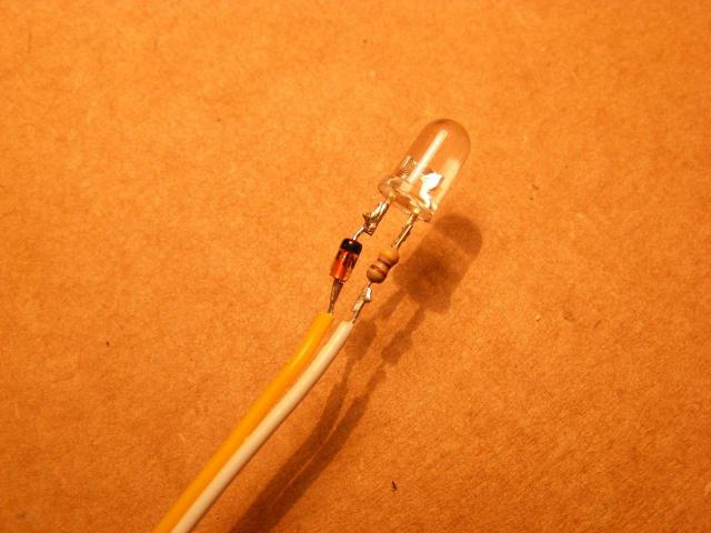

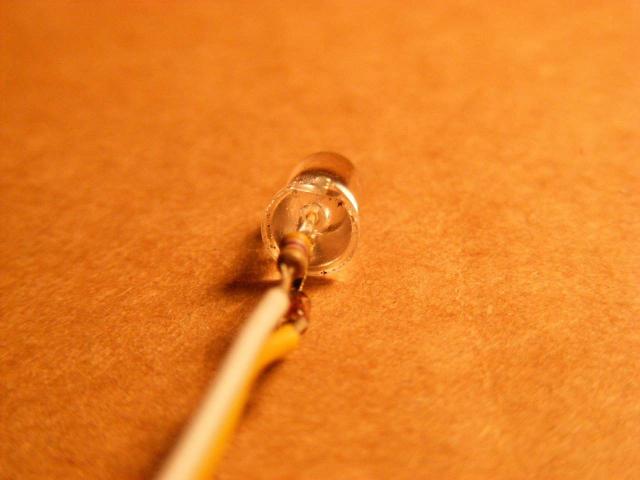

Hey Ron,nothing can be that easy mate.No documentation and i still haven't heard back from the seller.I was hoping to be able to tell from the length of the anodes but they have been cut back it seems.I had a couple of spares so i just removed the heat shrink covering and there is a resistor on one anode and someting else on the other anode.
Just looking at them more there is a flat edge at the base of the LED on the white wire side.So instead of it being round on the base section it has a D shape to it,if that makes sense.
Heres a picture of it unwrapped.
RE: Yellow and White - erospawn - 01-28-2010
Its Anode and Cathode.. The resistor should be on the Anode.. But, the other thing is a Diode, a one way gate... so what they've done here is made it so you can't hurt it if you connect it backwards. The diode acts as a one way gate, so if you hook the led up backwards, the current won't flow and you won't fry the led.

Anyway,it looks like i've had them wired up correctly as they worked.The only thing was i was taking it that the white wire was the negative and wired em up this way.But it looks like the resistor is on the white wire side so i'd have thought that was the positive side?Either that or i'm not reading my transformer correctly and what i thought was the positive was the negative pin.
Anyway,if they have the safe gaurd with the diode i guess even a wombat like myself can't really mess up too much??
I just tried wiring one up opposite and it doesn't light,the diode must be doing it's job.
Cheers again mate for your help Ron!!
