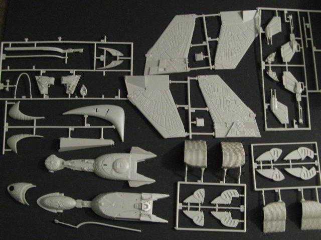

While I was waiting on the Voyager, which has been sent off, I decided to dig around in the closet full of models. I ended up deciding on building this. Its going to have all the lights etc...but Im doing something a little different which is building the baffles for the wing mounts..so the wings will be positional between attack mode and cruise mode. Talk about tedium!

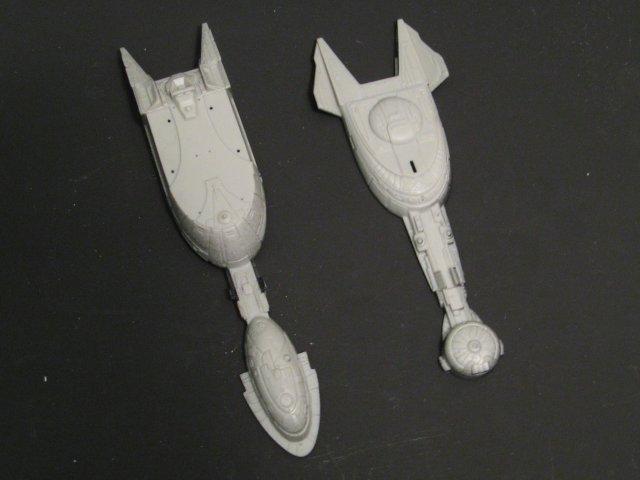

The general layout of the parts
[attachment=3409][attachment=3410]

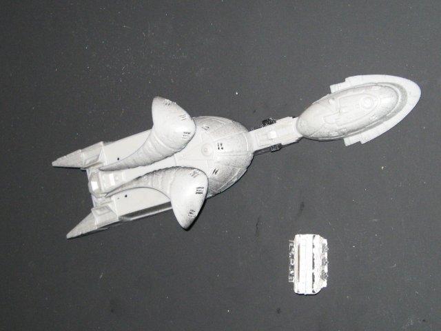

Painting the inside of the model black to cut down on the light leaks..
[attachment=3411][attachment=3412]

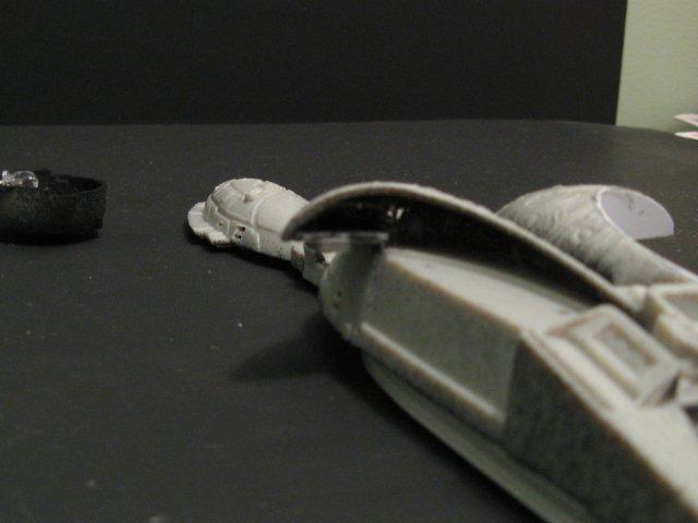

Here I took the dremel out and cut out the windows.
[attachment=3413][attachment=3414]

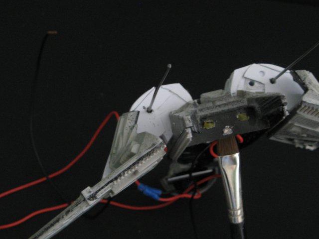

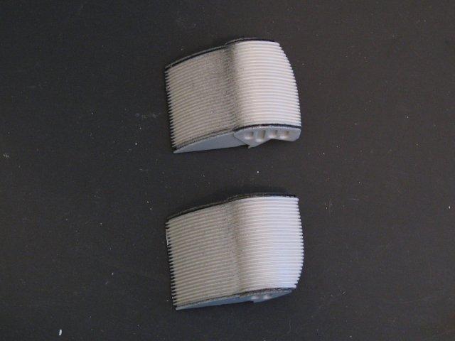

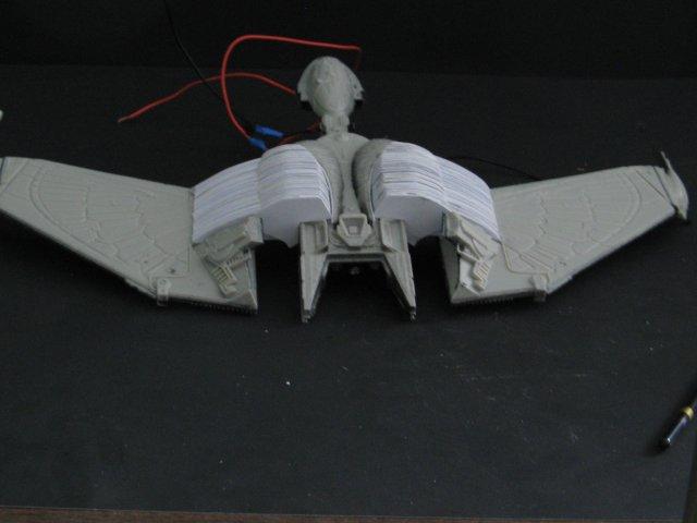

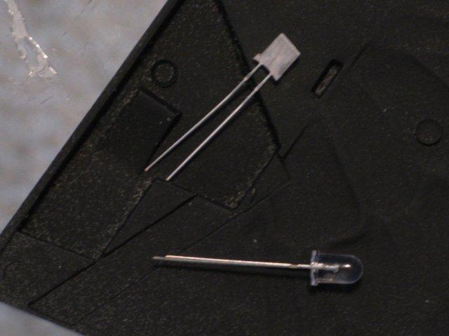

The first picture shows the original Baffles. Im basically taking styrene and cutting out the individual "ribs".. now thats tedium! The second pic basically shows the LED's being used. I had to shave down the LED's to fit inside the wing.. the problem now is how to hide the wiring inside the baffles and not interfere with the wing movement.
[attachment=3415][attachment=3416]

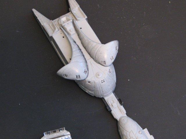

The pics here show the LED mounted in one of the wings.. and the next pic shows the lighting installed in the body.. Then I made a piece of plastic to separate the torpedo tube lighting from the bridge lighting. I plan to create a circuit that will pulse the torp led to make it look like a torpedo launching.. (as soon as I find a schematic).
[attachment=3417][attachment=3418]

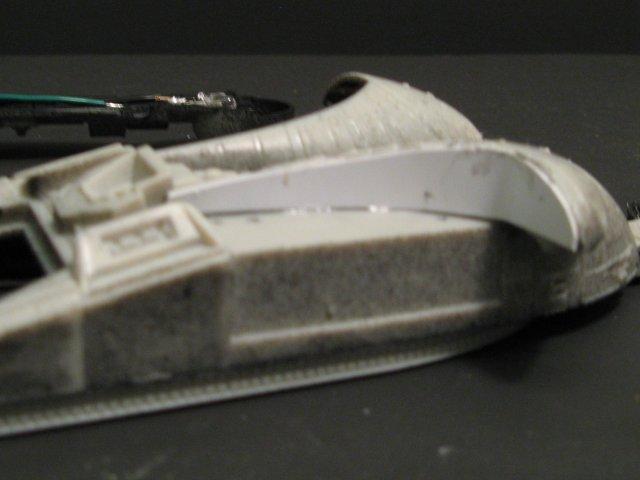

The pics below are close-ups of the lighting in the body.. The second picture shows a piece of styrene glue in place to keep the light from leaking through baffle areas.
[attachment=3419][attachment=3420]

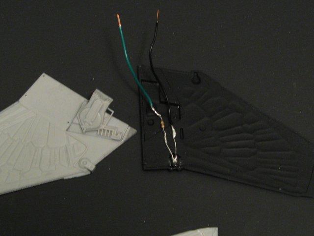

The 2nd pic here shows the LED mounted in the Torpedo tube..its basically a red LED being used.
[attachment=3427][attachment=3428]

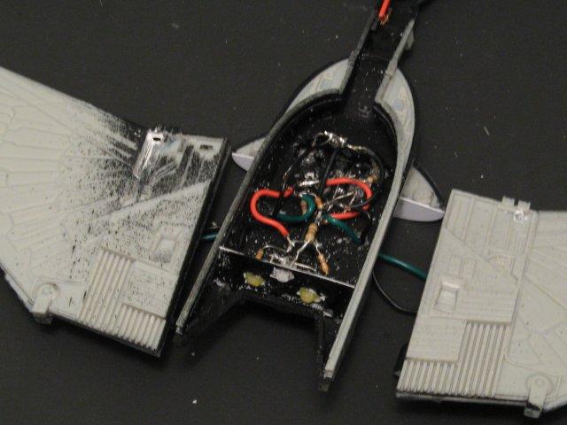

The 1st pic here shows basic wiring in the bottom half of the ship. The 2nd pic shows the wiring in the body again but with the engine lightes mounted as well. It's basically 2 red LED's with a single Yellow LED. The idea here is to make an orange light with a slightly redder tint.
[attachment=3430][attachment=3431]

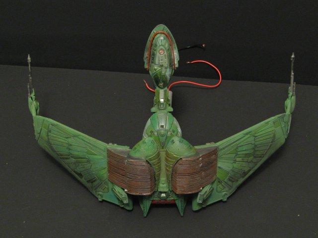

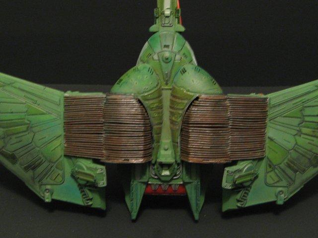

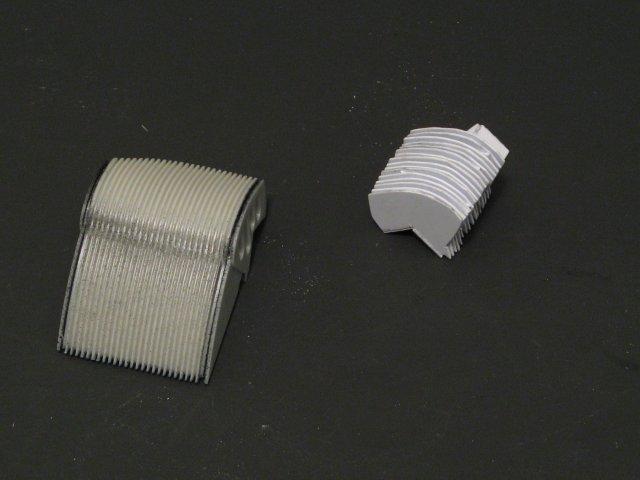

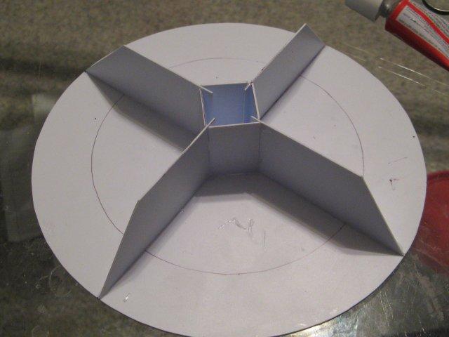

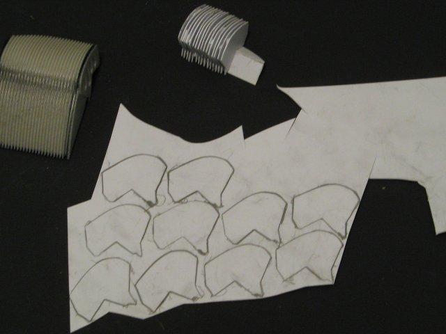

I've spent some time on making the baffles.. I believe about 26 X 2 for the upper.. and 26 X 2 for the bottom.. I think I've developed a nervous twitch from doing all that.. Tongue
[attachment=3494] [attachment=3495]
[attachment=3496] [attachment=3497]
RE: ERTL Klingon BOP - erospawn - 02-14-2010
I'm almost finished with right wing.. need to add a few parts..otherwise its done..worked on cutting out the wing "ribs" for the left wing tonight. Still have to glue them into place...
[attachment=3498][attachment=3499]
[attachment=3500][attachment=3501]

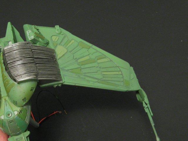

ALright...I finally finished the wing mounts.. well, one more peice and its done! Cutting out all those little peices about drove me crazy! So, now the wings are positional and thats pretty cool!
[attachment=3626][attachment=3627]
[attachment=3628][attachment=3629]
[attachment=3630][attachment=3631]

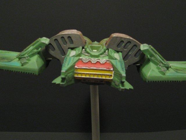

RE: Klingon Bird of Prey Hmmm !!! #@#@ - erospawn - 02-23-2010
Thanks Doug!
I used the references you supplied to paint the KBOP I'm working on now.. I added the pvc stand and got all that settled .. and am working on the painting of her now...
[attachment=3674]

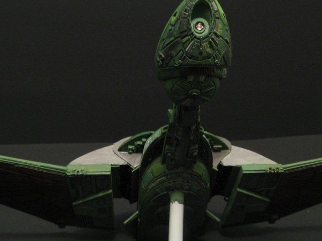

RE: Klingon Bird of Prey Hmmm !!! #@#@ - erospawn - 02-24-2010

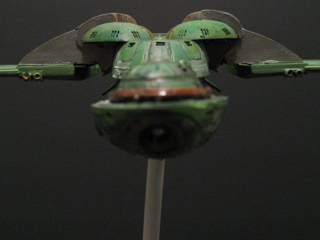

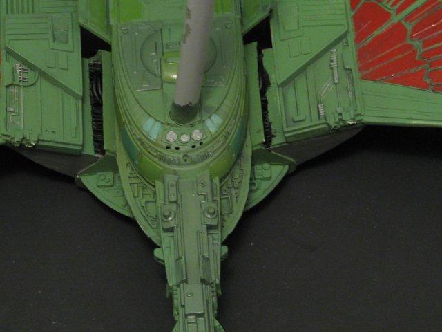

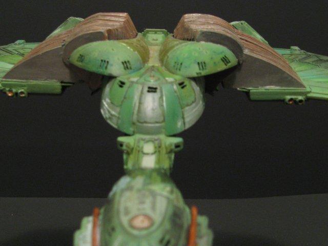

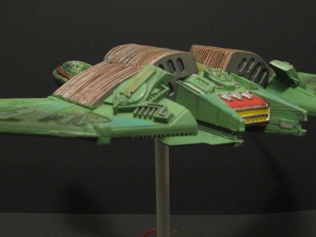

Hey Guys...
Here she is..painting and weathering done.. with the exception of the very front peice over the torpedo launcher .. You'll have to excuse the water glass I am using to hold the model up during the lighting... test?? ... I still need to make the base and wire up the circuit to pulse the torp light when a button is pushed.. I know its a lot of pics, but you're caught up to where I am Big Grin
[attachment=3694][attachment=3695][attachment=3696][attachment=3697][attachment=3698][attachment=3699]

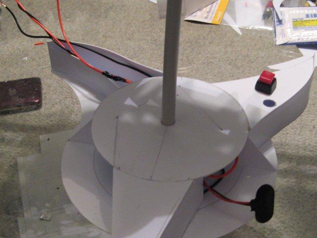

RE: Klingon Bird of Prey Hmmm !!! #@#@ - erospawn - 03-03-2010
Okay... I've been working on the base for the ship ..the idea here is to have the base look like a klingon symbol.. with the two arrows at the bottom switches to turn on the lights and fire the torpedo as well..
[attachment=3803]
[attachment=3802]
[attachment=3801]
[attachment=3800]
[attachment=3804]
[attachment=3805]
[attachment=3806]
