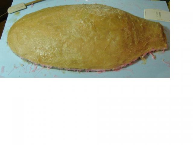

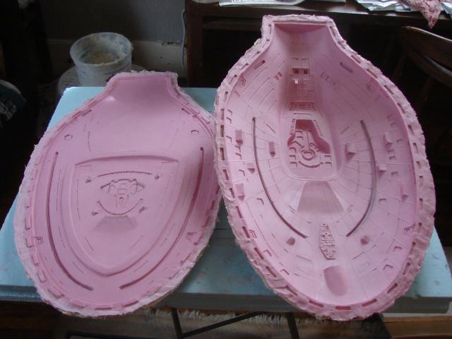

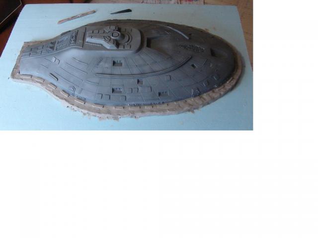

I just got some pictures of the Voyager molds.. its getting closer now! It feels pretty good to see someting you spent so much time on come to fruition! Big Grin

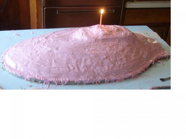

[Image: attachment.php?thumbnail=4050]
RE: Voyager Molds are almost here!!!!!! - JAWS - 04-01-2010
Wow happy birthday! So that was a brush on rubber reinforced with fibre glass? Looks good. Congratulation Ron.

Actually, to get all technical...
Mold Max 30 using fast catlyst and Thi-Vex
First 2 coats...straight Mold Max....to capture details
3rd coat...Mold max thickened with Thi-Vex to smooth out all pockets and build a 3/8 inch layer
When cured...a Plasti Paste jacket was troweled to 3/8 inch thickness and allowed to set for 24 hours
Master/Mold turned over...clay removed...vaseline thinned with mineral spirits brushed on to exposed silicone and above steps repeated for bottom half.
The plan is...Glass reenforced but using translucent urethane instead of polyester resin.....don't want brittle parts !

On the bottom portion of the mold...I decided to add keys to the silicone.
The bottom of the hull is kinda flat panel(ish) so I was concerned about getting the silicone to sit in the proper location on the jacket.
To solve this issue, I cut some strips from an old mold so I could make blocks... 1/4" x 3/16" x 1" ( or so )...then, while the last coat of silicone was still "wet", I placed the blocks in a random pattern all over the surface.
Then, when I applied the jacket material, I made sure there were no air pockets around these blocks.....when everything cured up, I pulled the jacket off and Ta-Da! locators ! Now the silicone skin "snaps" right in to it's proper location.
The top half of the mold was, in effect, a deep bowl....so this step was not required.
