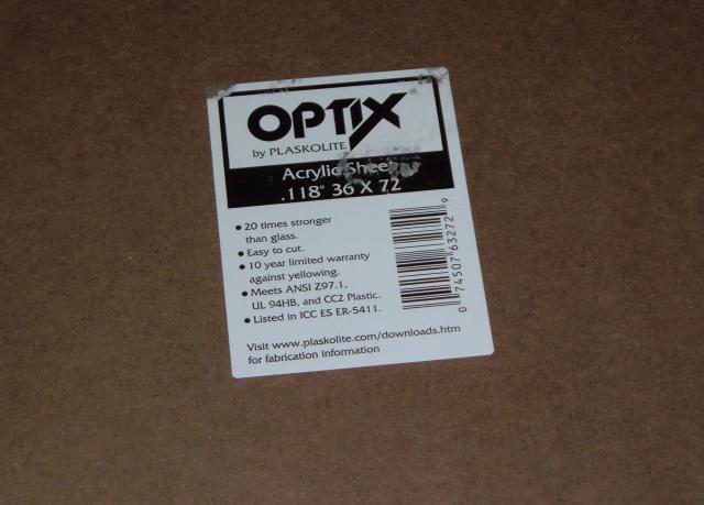

A big sheet of plexi Smile
[attachment=4389]
Had to get the .118 inch stuff, only a 64th smaller then 1/8, so should work alright.

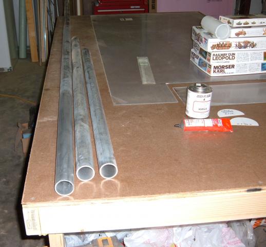

Here's the armature tubing, had to buy 20 ft of the stuff so I should have plenty, Smile
[attachment=4391]
More stuff

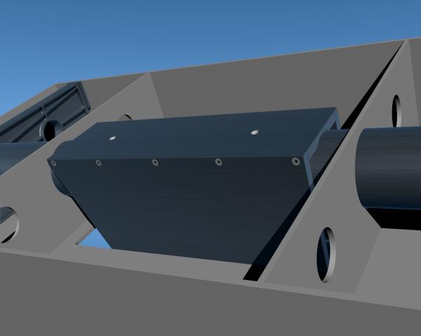

Hi Guys,
Sorry I haven't had anything to post. I've been real busy with real world stuff, Smile Still waiting for material for the armature. I did have a chance to do a few renders of my armature design. There's a render of my fancy Aluminum Formers. There will be two of these, to support the bay arms. That's if I can get them cast and machined. I have the design, I can throw them in later if I can't do them right now. I hope to have something real to show soon. Just been swamped here. Cheers,

Holy crap Joe! Thats seriously wicked work. So jelous of your abillity to draw this stuff up in 3D like this. i gotta do a course or something in this stuff. That is some extremely fancy work your putting into this build mate.
RE: Joe's Big "G" - bwayne64 - 05-18-2010
Jase, thanks a lot man. Glad you like it, Smile I had a lot of fun making those bulkheads in 3D. I just hope I can get them machined the way I want them. I want to be able to bolt the Bay support arms to the outside of the body. And not have to weld or connect them to the center tube. I also didn't want to have a hole though the center tube for a top mount. That's what the two threaded hole's in the center box are for. I'll be able to pop off the two dome's on the top, and attach a top mount through there. I'll be making the top mount in 3D first as well, In my over engineering fashion, LOL. When ever I can't build on the real thing, I go into Lightwave, and make something I can see. As for learning this stuff, Newtek has a great forum on Lightwave. If you ever decide to get a copy, there's a ton of info on there. And I'll be glad to share anything I know. I'm no expert, by a long stretch. But I can fake it with the best of em, Wink Cheers,

Holy shit there Joe!!
Mate that thing looks bloody incredible,a bit to fancy to be skinning with a Battlestar body don't ya think?You betta make two so you can display one on it's own. LOLThat looks ta be a piece of work right there bud!!
Wow,it looks very impressive Joe,but it also looks and sounds like it could be a lil expensive still although you'll have more of an idea about that than me.Honestly,it looks very impressive mate,but you should in my book get a quote to have your pipe welded up still.It might not be that expensive to get done,but it needs to be right and you don't need the head fucks i had with mine either.Whatever is cheapest and works is the way to go in my book.
But Joe that really looks impressive that design mate!!
I'll be looking forward to seeing you finally get a backbone built up and for you starting the actually building of the body section.It's been way too long in the planning stages and you'll be loving it once you start putting it all together!Big Grin
RE: Joe's Big "G" - JAWS - 05-19-2010
Joe I tend to agree with Phil on the costs involved. I honestly think you'll be financially better off getting your pipe welded up as we did. As awsome & professional as your design is I think its going to be more costly. Its your build mate & we totally love what your doing so just throwin our two bobs worth in the mix.
RE: Joe's Big "G" - bwayne64 - 05-19-2010
Hey Guys, Thanks for the kind words. The fancy formers are just an idea, not sure is I'll be putting those in. I do want the ole girl to look pretty on the inside too, when I pop the hood, Smile As for welding, I really want to be able to take this thing apart, when and if it needs remodeling. And the aluminum tubing is a bear to weld, without warping. I'll get it done, either way. I'm not fast, but I am precise, Smile Cheers,

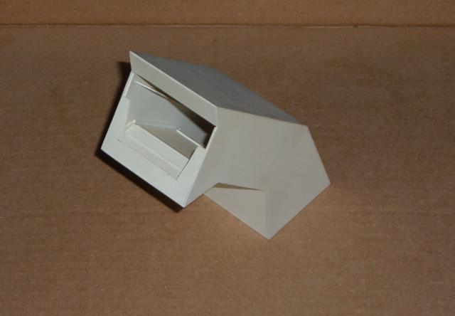

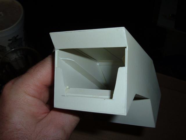

Had a small, and I do mean small update, Smile I found an part I built a while ago. I'll probably redo it in thicker plastic. It looks OK, but could be a little beefier. Even though they don't actually hold the bays up, they do need to resist flexing, that might pop off a kit part. Anyhoo, just so you guys don't think I might never build this thing, Smile Cheers,
[attachment=4781]
[attachment=4782]
[attachment=4783]
[attachment=4784]
[attachment=4785]
RE: Joe's Big "G" - Wombat - 05-26-2010
We'd never think that you was being slack over there,Joe!Would we guy's? Guy's??Tongue
Gee mate,that looks great and i hear you about the flexing an all as well.That looks pretty beefy in the picture's though.I don't think you'd have too much of a problem really.Myself,i'd probably hold off building up anymore till you get the body and bay's done,then just build the arm's to fit whatever you end up with there.I know the way you plan thing's out it should all fit but to me it'd be betta to be able to check em on your build as you are building em up,just to be sure.Wink
That does look good though,although as you and everyone else know's already,i really don't know what is right or wrong.To me that looks sweet!!Cool
RE: Joe's Big "G" - JAWS - 05-26-2010
Good to see you playin around but I agree with Phil & wait til you get the guts all built upo before worrying to much about this stuff. I rekon your going to be rebuilding stuff all the time on this project. Just like us idiots.
RE: Joe's Big "G" - bwayne64 - 05-27-2010
Yea I hear ya. I built this after I got the first Adam's prints. I never intended it to used, just a mock up. I agree the bays need to be built first. So I can get the connection angle right. I think I'm goin to use at least 1/16 thick styrene for all the parts. I used some .030 inch stuff on that arm, and it's feels a little weak. Oh well thats what mock ups are for. Cheers,
RE: Joe's Big "G" - Richard_2001 - 05-27-2010
(05-27-2010, 07:43 AM)bwayne64 Wrote: Yea I hear ya. I built this after I got the first Adam's prints. I never intended it to used, just a mock up. I agree the bays need to be built first. So I can get the connection angle right. I think I'm goin to use at least 1/16 thick styrene for all the parts. I used some .030 inch stuff on that arm, and it's feels a little weak. Oh well thats what mock ups are for. Cheers,
Joe,
The construction method looks good I think it will be much better with .060 or .080 styrene sheet as well, you want these to be heavy enough to resist flexing to prevent kit parts from popping off during a move for construction or display.
Yeah mock ups really help finding trouble spots Wink
Richard
Thanks Richard,
I got 3 big sheets of .060 just for this build. I might get some .080 for the large panels, if I don't use plexi for them. I don't really like sticking dissimilar stuff together. They might expand at different rates and come apart. I thought about using VHB tape to connect my formers to the skin. That stuff is super strong, but flexible. I figure things can move around and not break lose. Cheers,
Joe,
Your welcome! I have been trying to build my 3D mock up with as few different sizes of skin as possible to economize on material purchases.
So far I have limited it to .125 .060 and a small amount of .080 in the chin area, sticking to the 2 sizes means you can buy in bulk of those and small amounts for the odd size or two. Smile I am not too concerned over the acrylic - styrene expansion rate differences as my replica has a pretty constant temp basement to reside in, but I have considered an all styrene skin to save on laser cutting charges.

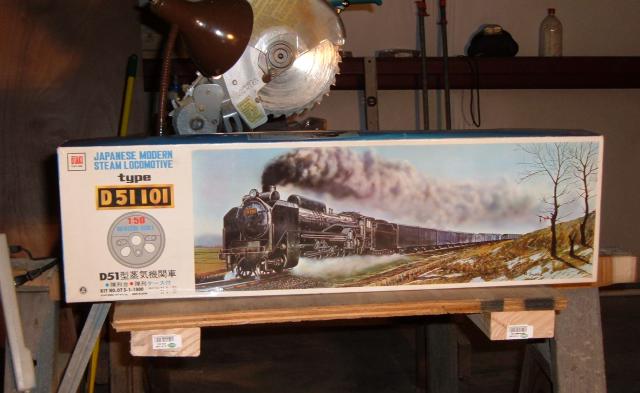

Looky what I just got. I feel like I'm getting some Wombat luck, Smile And for only 37 dollars ! I almost didn't bid on it, cause the kit number was OT 5-1-1800 not 2800. It looks right part wise, and at that price I couldn't resist. I hope to get jumpin soon. My health issues just won't go away. Most days I don't feel up to doin anything. I'm still trying to get a room built in the shop. I need some AC ! It's been getting to over 100 degrees F, with 80 and 90 % humidity. I guess a lot like Australia, Smile And feeling bad at the same time is just too much. I do as much as I'm able too right now. I really want to finish this thing, I've been working on it since 1985. I'm enjoying the builds here though. I'm living vicariously through you guys. I'll be right there with you soon I hope. Cheers,
[attachment=5496]
RE: Joe's Big "G" - darkimmitator - 08-07-2010
Excellent score there Joe .Excellent price as well !! Hope you feel better soon and hope to see some battlestar updates soon as well .Congrats on the d51 find !!!
RE: Joe's Big "G" - JAWS - 08-07-2010
NIIICE score Joe. Its amazing how rare these things are but we're pickin em up cheap! Congratulations & welcome to the club.
RE: Joe's Big "G" - Wombat - 08-07-2010
Joe,the most important thing is you get yourself well again there.You can't do much if ya feeling crook,that is priority number one mate!Once ya good again I,like the rest of us,look forward to you starting that dream finally.You are another a long time in the planning and it's about time ta show off some of that in the practical build.
Not sure you got my current luck with that score,if ya had it at present you wouldn't have got it.But that is a good score and for that price you should be buying a lotto ticket also.You might just be on a roll!
RE: Joe's Big "G" - bwayne64 - 08-08-2010
Thanks Guys, I never thought I would get one of these babies, certainly not at this price. I actually bid 70 dollars max . I was shocked when it went through so low, Smile I picked up a 1/12 Tamiya JPS for around the same price a few weeks ago too. Phil, I should try the lottery ticket, who knows, I might get lucky. Now if I can just find a decent doctor, Smile cheers,
