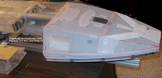

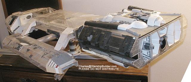

I guess you could say this is the "father" of the Custom Replicas Galactica project.
Long story with this one. It all started when I met Jim Creveling in 1998 and saw his AMAZING build (not even yet completed at the time, but still jaw-dropping incredible to behold). I was inspired to start down the path that eventually led to my designing CR Galactica. I do have to say I am very proud of how that turned out. It took nearly 12 years to reach the end of that road. Smile
Some details of my own build were posted on my site years ago before it was taken offline. Most of the pics being shared here in this thread have never been posted online before. Only a handful of people have seen them. Mike, I know you have asked to see these for years and I hope you won't be disappointed.
I decided to post here because you guys are really digging into this project and seem to be really enjoying it. I thought this might be encouraging to those just starting out. This is a VERY challenging subject to tackle and it can take a lot of time, money, and effort to succeed. All I can say is STAY AT IT and you will get there eventually.

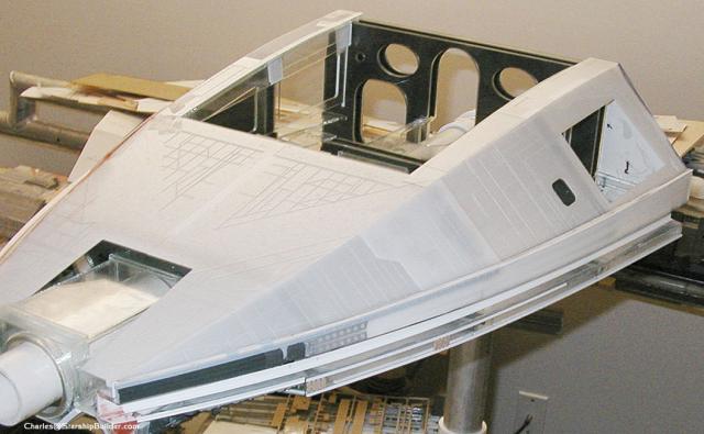

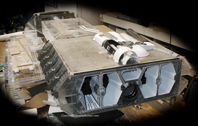

This has been a really long journey. It was actually my first major scratchbuild so I was learning as I went along. Being somewhat of a perfectionist, I took things slowly and worked at it over time (a LONG time), trying to perfect my skills as I went along.
Rather than just build it and get it done, I wanted to do it once and do it right. I spent years figuring the patterns out for this build (about 5 years altogether). Once construction started, I spent about another year getting it to the point you see here.
As I mentioned in another thread, I continued working on it until I made the decision to leave my full-time job back in '05. That was a tough time, as the business I was working for (that I helped get off the ground) was starting to blossom but they were taking advantage of me in a big way and I had to put a stop to it. Unfortunately, that move severely curtailed my income for some time. Shortly after that, I started my own publishing business. While all that was going on, my model got put on hold since I couldn't justify spending money on it.
After letting it sit untouched for years, the opportunity came about to start designing model projects for other people professionally. This led to my designing (and helping to actually build) the CR Galactica. I went back to the drawing board and started over, using my new 3D tools to take things to the next level.
Like I said, I am a bit of a perfectionist, so seeing an even better version took away any desire to keep working on my original model -- even though there is nothing at all wrong with it really. It's a very decent effort and has received a lot of nice compliments. But, I now have patterns for something even more refined, so it makes sense that I'd want to build that version for myself to take full advantage of the many years of work I've put into all this.
I offered this model for sale to a friend as-is in its uncompleted state. He agreed to buy it and finish it, but he has not yet taken delivery. Once he gets it, he'll probably want to post some pics of the finishing work. As you will see, the structure is nearly complete and the detailing has already been started. Overall, it looks pretty good so far, and it's actually very similar to the CR version unless you look really, really close.

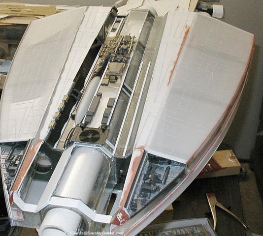

This is what the model looks like now. It has not been worked on in some time. The reason I have hesitated posting all these images is I didn't really want the model to be seen until it was sufficiently completed. (I was really hoping to get it fully detailed and at least covered in primer first.) I just didn't feel it was presentable yet. Again, being a bit of a perfectionist, I wanted it to look good before I presented it to the world.
With that in mind, please know I am not a very good photographer, and these pictures were taken with a crappy digicam. Honestly, the model looks much better in person than it does in these pics.
RE: StarshipBuilder's Galactica Replica - Wombat - 07-17-2010
OMG!!
Charles,that is just awesome!!
Thank you for posting some pictures of it for us to see,enjoy,and for myself,add to the motivation of building something that will hopefully look something like that beautiful looking piece.Jeepers mate,she's stunning!!Even in the state she is she looks awesome!Damn,those refined plans must be something real special to not continue with this one,the lucky guy that has agreed to buy it from you has got one hell of a head start with it all,no question about that.To my eye she looks perfect,and i see some well thought out engineering has gone into it,right from the begining with the armature design.To say your work looks outstanding would be a huge understatement!I can only say i hope you can get stuck into your own CR Galactica pretty soon and not have to wait till you build the other one for someone else that you mentioned was about to begin.For all your hard work you really should be sitting back admiring one for yourself!The first one there looked just fine but i also understand wanting to have the revised one,who wouldn't afterall.Enjoy the building mate,just make sure theres a little for yourself as well as others.
Thanks again for posting her along with the motivating and encouraging words you speak in our threads.

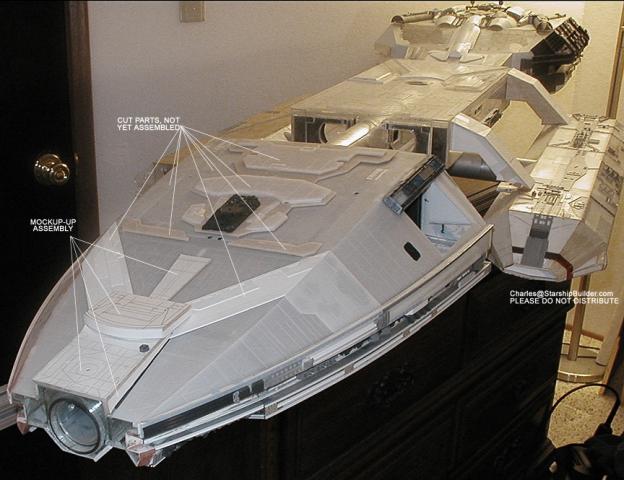

Here we go again. A very large and heavy box of laser-cut parts arrived Friday with all the pieces needed to build the head section. (Last time I built one, the completed module packed in its shipping crate weighed 30 pounds!) It took me half the day yesterday just to sort through everything. A couple more days and I'll be building again. . .

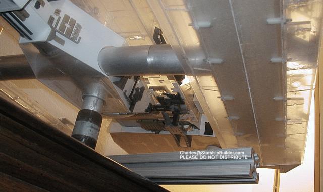

Hey Charles is that some T8 Plastruct you got at the back to hold the Lid in place?

Jason, do you mean the back of the engine lid? There is nothing there as it has not been trimmed out yet. The lid ends short of the rear plate and the large gap gets filled in by various strips of tiny Plastruct Tee. EDIT. I think you mean what's under the lid? That is 3/16 black Gatorboard. It's very dimensionally stable, more stable than plywood, yet it weighs almost nothing. I seem to be the only model maker doing these kinds of builds that uses it (though Jim C. did become a convert). I glued it under the lid to help keep the lid from warping. Even then, it has bowed ever so slightly over the years. As a result, I recommend thoroughly supporting both the main body and engine lids.
I plan to post progress on the new build. The CR Galactica head section will never be available as a kit though. We have an agreement that it will only be provided as a built piece. For one thing, the amount of work that went into designing it was just unreal. It is quite honestly too complicated for most people to tackle. Even for someone with a lot of experience, it is a very difficult build. This thing looks like a Swiss clock on the inside. . . Exclamation

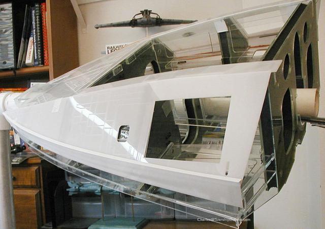

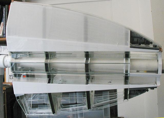

There were literally hundreds of parts in the first one. The second one is simplified somewhat, but still very complicated. I can't even imagine how hard it would be to make sure someone got all the parts and also any replacements needed if they screwed something up while building it. It was deemed too impractical to even consider.
As for the head skins, I quickly learned plex is not the way to go. It was a real b*tch to get the skins in place. Acrylic glues real strong face-to-face, but not so when edge-to-edge. With laser-cut parts, the edges have a slight bevel, making it even worse. After building this thing several times, I decided I would not do a head skinned in plex again. Thus, my revised patterns now feature styrene skins over an acrylic frame. Not only is this easier to build, it is also easier to detail, paint, and finish.

Ok,so thats real interesting that the head pieces will not be available to build up by someone for there own build.I dread to think what it would cost to have someone build even just this section but it appears to be the only way then.You make it sound a lil scary really desribing it like the inards of a swiss clock though.I guess well see what is involved once you start posting?Another small thing also.I take it then if you buy the kit from CR,then by what you are saying is the head is already completed in that price?
On the head panels,well that all makes sense to use styrene.It is how i intend to build my head section also,styrene over acrylic bulkheads.I was thinking acrylic would be just as you descibed and that the styrene is the best option in this section.I also thank you for that info on th estregths of gluing the acrylics.Some of my engine section side panels are just that,glued on end,with a beveled edge also.I actually was pretty messy with that glue,i even tried to just fill the valley behind where two panels meet with glue to give it some more structual strength.So far it's holding together alright.I still need to do to my lid some supporting.i'm seeing plenty of sagging in it but don't see it being too hard to support,i just havent got to that yet.

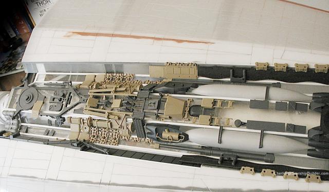

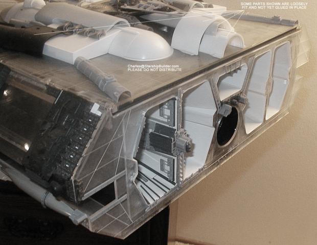

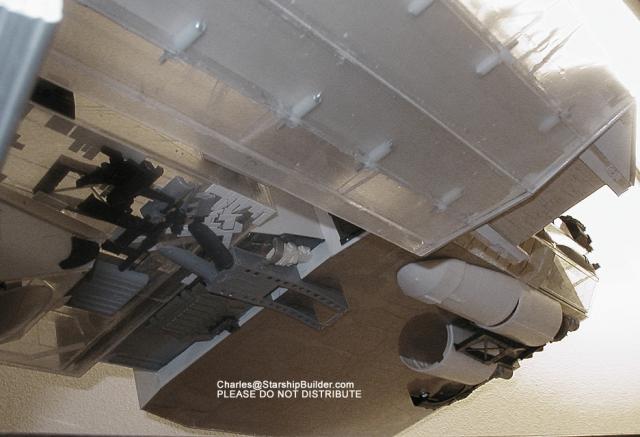

I'm surprised no one else noticed those rollers. It's for a unique design element I came up with. My entire bay is a hollow tube for a full interior. The armature is cut away to make room as well. The rear end cap is attached to a long "tray" that slides all the way inside the bay, almost to the very front. This tray is the interior. The whole thing slides out so it can be built separately. The wiring plugs in up front, behind the front cap. To remove, pop off the front cap, unplug the harness, then slide the entire assembly out from behind. This way, I can take my time building an interior and it doesn't have to interfere with completing the rest of the ship.
RE: StarshipBuilder's Galactica Replica - Wombat - 07-21-2010
I seen them rollers as well,but didn't actually know what they were.OK,so they let the whole bay interior be removeable.Interesting idea that one!I am just planning on doing it with the painting like the original,but in both bays obviously rather than just the one.That was a good idea there Charles,one just the things you could do in there but also the fact as you mentioned it was something that could be done once the rest was built up.Good thinking on that!
