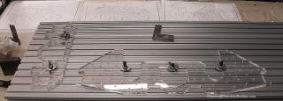

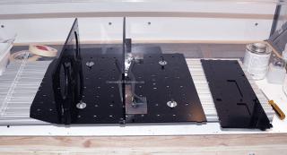

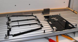

Special Jigs/Tooling

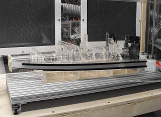

As an aid in assembling the parts as precisely as possible, I developed a special jig made of machined aluminum. This provided a perfectly level work surface with multiple slots to facilitate bolting parts to the table. Unfortunately, the “T-slots” were too small for standard 5/16 threaded T-slot bolts. Thus, I had to fashion my own hardware using 1/4-20 threaded set screws (i.e. headless bolts) in various lengths plus T-nuts to accomplish the same functionality.
The final table was 15 inches deep by 30 inches wide. It includes four leveling feet at the corners. Overall, it works brilliantly. . .

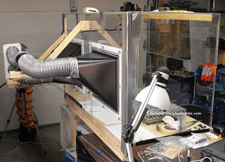

Ventilated Work Area
The second challenge I had to deal with is one we have discussed here before. The glues and solvents needed for working with both styrene and acrylic are quite toxic. Many modelers routinely use these solvents without being concerned about how it might affect their health. Being short-sighted here, however, can cost you big time in the long run.
I had been using WeldOn solvents for gluing acrylic for years. In fact, I had even used this stuff indoors which, it turns out, was a big mistake. The only safe way to use these chemicals is outdoors. Even then, special protection is required. Although it is not widely known, the manufacturer actually states that a regular paint/chemical respirator will not protect you. An air-supplied respirator is required. These can cost a lot of money.
One solution I had in mind was fashioning some sort of ventilated work booth in a corner of the shop. I searched and searched online but the only examples I could find were custom built for industrial/factory settings. These setups cost many thousands of dollars. It took a LOT of research to come up with a DIY setup that I could use in my small shop. But, after a lot of time and effort, I finally put together something that worked.
As with most projects, there are multiple challenges to overcome. The fan that provides the ventilation must be spark-proof. Since this fan is venting air containing flammable fumes, a standard fan simply will not do. Many people make the mistake of using ordinary fans in their home-brew spray booths because they think the filter will provide some protection. Filters, however, only trap particulate matter in the air. They do not remove solvents. Thus, any ordinary fan can provide a source for ignition and can potentially cause a fire. If you are concentrating the fumes from the solvents in a small area such as a spray booth, the risk intensifies.
Unfortunately, a truly spark-proof fan is an industrial item. I discovered the prices started at about $700 US for such fans. This was WAY out of my budget for this project. In the end, I discovered an online post where someone recommended the use of marine bilge blowers. These are specifically designed to ventilate the engine compartments on a boat where gasoline vapor may be present in the air. Since gasoline is about as flammable as you can get, anything rated for use in such an environment would be more than sufficient for my needs. But, these blowers run on 12V so that presented new challenges in terms of wiring (see below).
I wanted a booth that I could work inside while gluing and have the fumes safely carried away. This meant I would be using it for hours at a time (unlike a typical spray booth). I chose to make it out of clear acrylic to let all available light in and not require any extra lights. The final dimensions were 4 feet wide, about 3 feet tall, and 2 feet deep. This is what was needed to accommodate any major section of the Galactica.
With the booth itself designed, I opted to use dust removal gear for extracting the fumes. I found the largest dust collection port available -- called the “Big Gulp” -- and designed it into the back of the cabinet. (In fact, I used two of them.) I then created custom brackets and hose connections to the bilge blowers. Each blower uses a standard 4 inch hose. To route the air outside, I came up with a custom adapter that combined the two 4-inch hoses into one large 8-inch ventilator hose. All this was mocked up in 3D using Rhino as the final design ended up being rather complex.
The final step was the wiring. Again, the idea was to create a spark-free environment. This meant adding anti-spark measures to the electrical circuitry. (Isn’t it amazing how complicated projects can get? All this just to suck out some fumes. . .) I wired in diodes as needed to keep the relays and switches from arcing. Even though I studied electrical engineering in college and I had a good bit of experience with 12 volt wiring, I had gotten quite rusty over the years, so it took a good bit of research to figure out all the specs that were needed for this project.
The final step was a heavy-duty power supply. I ordered a 20-amp unit and hooked everything up. The test occurred on a hot summer day. Each blower is rated at 240 cubic feet per minute and draws a hefty 6 amps. With a 20-amp supply, I figured there was more than enough capacity. But, the power supply got way too warm to be safe. This was because I used a traditional linear power supply with heatsinks. Since everything is made so cheaply these days, they did not include a fan to keep it cool.
I did some further research to find a quality power supply and learned about Astron Corporation. These supplies are rated for continuous use and are favored by amateur radio operators. They are not cheap, but you definitely get what you pay for. I ordered a 30-amp switching power supply with a built-in fan and both volt and amp meters. This one works perfectly and powers the booth for hours on end without getting over-taxed. In fact, the booth is so powerful, I often just use it with one fan at a time.
To make the booth even more efficient, I designed a flip-up front that reduces the front opening by about 1/3. With the door in the down position, the ventilation is increased for greater air flow. With the door up, I get more access through a wider front opening, but less air is drawn across the work surface because the opening is larger.

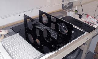

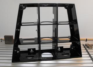

Like I said, it took a LOT of prep work just so I could start construction on this project. With a safe work environment, I am able to spend hours at a time in the shop in relative comfort. I no longer get headaches from the fumes and I don’t have to take frequent breaks to get fresh air. The work booth works great for gluing, soldering, and even painting. All that’s needed to turn it into a spray booth are furnace filters over the air intakes (plus something to protect the inside from overspray).

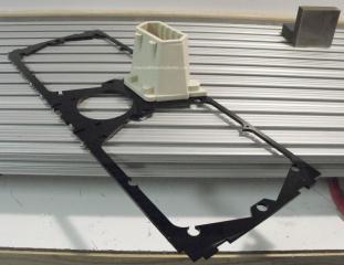

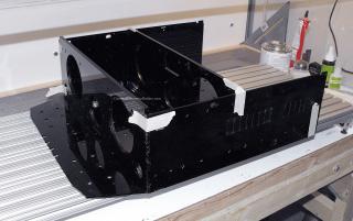

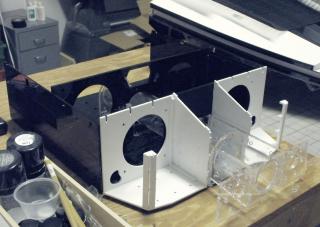

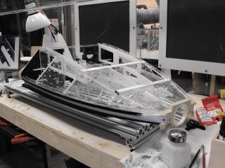

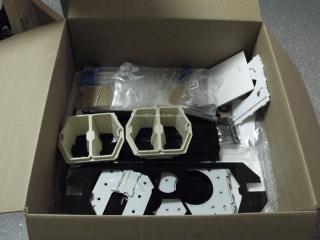

Construction commenced when a very large box arrived containing all the parts for both the head and neck sections. I started by assembling a custom-designed jig, then I started building the core portions of the head structure. A pipe sleeve fits over the round pipe and provides a means for attaching the bulkheads. This part has been streamlined from last time. The mouth trenches, however, are still complex because they are tricky to build no matter what. The mouth is not straight but crooked to match the character of the original. I had to find a way to build it on a flat surface, yet maintain the correct curvature. Also, the vertical wall inside each trench has to be drilled through for routing fiber optics. I chose to make this from styrene as acrylic would be too hard to drill. But, styrene transmits some light. This meant I had to paint the back side of the entire mouth trench to prevent potential light leaks.
Like I said, there are a LOT of little details in this project!

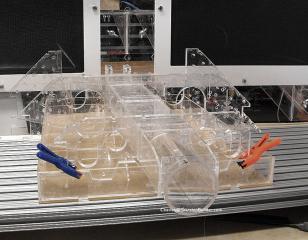

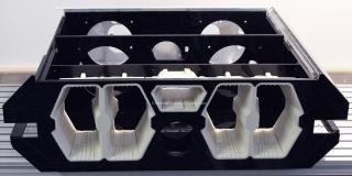

The last step in building the core structure was making the removable top hatch. This is a rather complicated but effective design that integrates the fiber optics into the hatch. Thus, when you lift off the hatch, the fibers are not in your way and it can be completely removed from the rest of the head section (unlike the original). A separate LED bulb and wire harness are hidden inside. To remove the hatch, all you have to do is unplug a 2-wire harness.

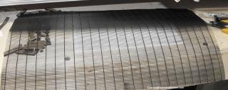

Once the core structure was complete, I could begin test fitting the skins. This is where I am at right now. The top skin is being fitted as we speak. Even though the top is divided into four separate sections, I am taping all the skins together to fit them as a unit. Once fitted, they will be carefully glued in place. Then, it will be time to start work on the bottom.

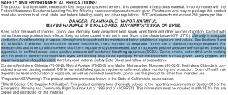

PS I located one of the warnings from the manufacturer. I am assuming this applies to the "classic" formulation. See attached.

I think we've now pretty much covered it. Smile My ventilated work booth pretty much solves all these problems for me. With just one fan on (i.e. half power) I can glue without wearing any sort of respirator and I can't smell a thing. The fumes are directed outside and well away from the shop.
Same goes for soldering. Normally, the solder smoke/fumes aim straight for my face no matter which way I move, now they go away from me. I can also paint using brushes as well as clean brushes in paint thinner without getting any of the fumes.
It's really great when applying putty as both the 2-part polyester stuff I use (recommended by the pros) and my air-dry lacquer-based touch-up putty are both rather nasty smelling and pretty toxic to breathe.
All this may be a bit of an "extreme" solution, sure, but it works great! Would I recommend this for everyone? Maybe not, as it was a lot of trouble and not a small expense to build. But, I use it nearly every day and it's become one of the most valuable pieces of equipment in my shop. Smile

Believe me - a paint booth is the way to go! If I had my choice, I wouldn't hesitate to use that over putting something on my face! The paint booth I was describing is only for spraying things you don't want to get dust, dirt, etc. in. It's just a cheap temporary alternative to buying something to use all the time. I'd only wear a respirator for that, since it doesn't allow for ventilation. It would do for spraying a smooth finish over something until the paint dries enough to hang dry in a shed, or garage.
On the soldering iron thing - why does it ALWAYS have to fume towards your face, and right into your eyes?!! Been there - done that! Even if I was outside it would blow right into my face as if it had radar! Undecided I just don't get it....
That booth is rocking, and I just wish I had somewhere to put something like it, but I don't have a garage, or a basement. Sad This makes my life a lot more difficult than you guys realise. I need a new home - this one's too small! I have a card table that I work on -other than working in my friends' garage, but that's just not feasable. This only adds to the dreariness of my work situation. It's also why I can't become motivated to get anything done. I'll figure it out later. Just keep rocking on with the paint booth, and show us what you've been doing with it. I'll definately be watching even if I don't leave any more comments - I need the inspiration.

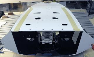

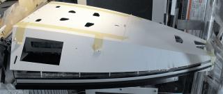

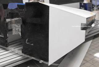

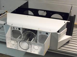

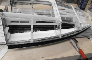

Thanks! Smile With the core structure now complete, skinning commenced today. The bottom trench (redesigned) went together very smoothly and is done except for the KoolShade vent. This is the only major section of the skin to be made from acrylic. Most of the rest of the head will now be skinned in styrene. That will make it easier to apply the skins, as well as reduce costs.
The top skin is already test-fitted and is ready for gluing. I still need to build the forward lower trench and install the upper and lower "lips" to finish the mouth trenches. Lots still left to do, but I should have most of it wrapped up within a week or so. I'll see if I can take some pics tomorrow. . .

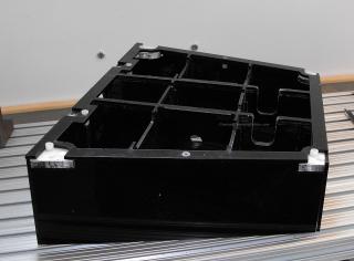

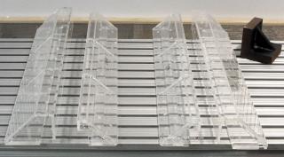

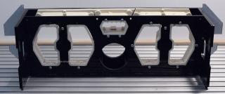

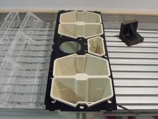

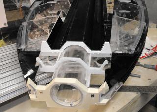

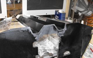

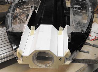

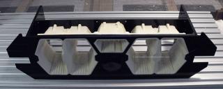

Here are the latest pics of my progress on the head section. Today I polished up the bottom trench. It is done minus the KoolShade vent on the port underside. These panels are solid 1/8 inch plex with beveled edges for near perfect seams. Little or no putty should be required and it will be further trimmed out with Plastruct extruded rails. By making this in acrylic, it helps tie the bulkheads together in order to provide extra rigidity. It is rock solid and should hold up well.
The forward lower trench (in 0625 styrene) has also been fabricated and test fit in place. The sub-structure (plex) is complete and I am ready to install the trench panels themselves.

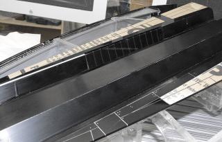

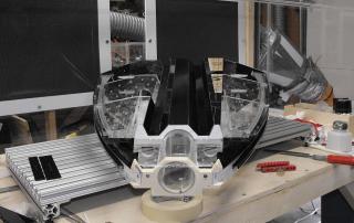

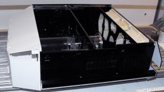

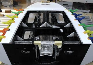

Lots of progress to report. The head is being skinned and it is going very smoothly. I am extremely pleased with how well the styrene panels are working out. They are much easier to deal with than the plex skins used on the first build.
The head is nearly complete at this point. The bottom is completely done. I started there as this is probably the hardest part. First, I finished up the bottom forward trench. Then, I fabricated and installed the KoolShade vent using authentic vintage stock (extremely rare and expensive today!).
With the trenches done, I could put the large "chin" panels on the bottom of the head. These are quite tricky to install. The styrene is not nearly as stiff as plex, so a good bit of structural reinforcement is necessary. I designed backer panels that get laminated to the inside surface of each chin panel. Whenever you do this, it's a good idea to add weep holes to the part to ensure an even glue bond. (You'll notice I do that sort of thing a lot to enhance structural integrity throughout the build.) They are further stiffened by the addition of internal stringers and they also get welded securely to each bulkhead using 1/4" square plex rods.
With the bottom skinned, I then machined the ends of the lower trench flush with the back of the head and installed the bottom forward trench rear walls followed by styrene cladding for the "cheek" panels on the very back of the head. I finished up by installing the "lower lips" to trim out the mouth trenches on either side.
At this point, it was time to start working on the top. I pieced the entire top skin together (already test-fitted from before) and installed it as a unit. The front section has to remain unattached for now in order to install the fiber optics inside the head. The rear center portion is part of the removable top hatch. So, the only parts of the top skin that can be glued down right now are the two rear pieces on either side of the hatch.
With those in place, I could finish up the hatch assembly itself. The clearance was very tight and the fit was perfect. (The hatch sub-structure even has little levelers all around so it can be made to sit perfectly flush with the top skin! I tried to think of everything. . .)

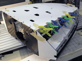

Next, it was time to start installing the side skins. I got the starboard skin in place using special clips I designed to make the process easier. The bottom of the skin was stiffened by adding plex bar stock on the inside of the lower edge. It was all quite solid and went together well.

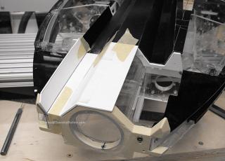

The final touch will be the eye sockets. These are a royal PITA to build with this design, so I saved them for last. The top hatch, one of the coolest features of this particular version, has one drawback -- the structure blocks access to the inside of the head where the eye sockets go. Thus, there is no way to get at the underside of the skin when building them.
The skin itself starts out flat but it's curved when installed so you can't really pre-build the eye sockets on the back side of the skin before it goes on (well, maybe you could but that would be real tricky). Putting in the chin panels on the bottom requires full internal access, so the chin gets put on before the side skin. This means there's no access from below. Bottom line: Once the side skin goes on, all you have is a hole for the eye socket and no other significant access. This requires installing the sockets from the outside. Talk about a challenge!
The only way to proceed is with a lot of patience. I'm not really sure how I did this before, but somehow I figured it out. So far, I've fabricated the starboard eye socket (no pictures yet) and I'll polish it up over the weekend. With luck, the rest of the head should be complete very soon.

RE: StarshipBuilder's CR Galactica Build #2 - 427 Cobra - 10-02-2010
I see you use those little clips for projects too. I use them for holding convex shapes while the glue dries. I used these when I was making a Terminator endoskeleton arm. I wish I could get myself motivated to get my projects as far as you have. This looks very scientific, almost like a NASA model. Very cool - thanks for sharing these pics.

The Gal head looks really sharp Charles, nice job. I hear you on the eye boxes: they are incredibly hard to build in. I still didn't get mine quite right (the rear walls don't lean out enough), but was surprised at the difficulty. Good idea on the lid/lighting module. I'm not planning the lighting stuff yet, but did envisage a plug-in harness for it. The engineering challenges are immense on this project and it's cool to see the different ways we all tackle them for the same end result.

Thanks! Keep in mind, soldering fumes/smoke reportedly contains acids that can attack surfaces. These fumes should be filtered before they enter the airstream. Same goes for particulates such as paint sprays. To use a booth like this one for spraying or soldering, install something like furnace filters over the openings. I have not yet done this but I will before I do any extensive soldering work in it. If I use it for painting, I'll cut and fit some white panels to the inside to protect the clear acrylic from getting paint on it. (If that were to happen, I would lose some of the light coming into the booth.)

As I'm going along, I am remembering just how long it took me to build the last one. There are many details to attend to everywhere. Plus, I am juggling two battlestar projects at the same time right now.
The neck section is actually very tricky to build -- much more so than it looks. A surprising amount of engineering had to go into what on the outside appears to be just a simple box. Yet, every intersection is at an angle, and almost nothing meets at 90 degrees. This requires taking it very slow and triple checking everything at each step along the way.
There are probably more fiber optics in this module than anywhere else on the ship so gaps and holes had to be included in order to run them later. This required plotting out every single fiber run in the 3D computer model before the first part could be cut. Plus, the top is removable and so there is a need for some sort of support shelf for it plus screws to hold it down and some way to ensure it's all level. To make things even more difficult, two screws for securing the top hatch of the head are also present in the lid for the neck. It is surprisingly complex inside there.
It turned out very well though and this section is now ready to go on the armature for test fitting with the head and main body. Next up, I'll be building the engine section. I'm waiting on the arrival of a few key parts so I can get that started.
PS What looks like curvature or warping in the pics is barrel distortion from the camera lens. Everything is straight and flat!

I'm juggling two major builds so I'm going back and forth between them. I've been busy working on another head section build that can be seen here. This is the most complicated part of the entire ship and takes a lot of time and effort to complete.
The engine section, however, is a close second in terms of complexity. While the outer shape appears far more simple, on the inside this structure includes a removable lid, built-in ventilation system, and high-tech lighting. In addition, to make the detailing process easier, the rear thruster openings are built as a removable module. All this complicates the design quite a bit.
I got started on the engine section for this build over the weekend and this is the progress so far. Before getting too far along, I wanted to pre-install the vintage KoolShade vents on the sides. This stuff is a bit of a pain to work with. It's very tricky to cut, it likes to unravel like loose threads on a garment after it's cut, and there's really no satisfactory way of attaching it to anything.
The only option in this circumstance is to use drops of CA glue to secure it in place. Unfortunately, that cannot be done without making a bit of a mess. Also, for some reason, when the CA cures it turns white! I don't know why, but it must be a reaction with the finish on the KoolShade.
The only way I could get this to work was to touch up the KoolShade with flat black paint after it was glued in. While this does not look absolutely perfect, I have to remember this entire area will be hidden in deep shadow and visible only if you were to shine a flashlight into the engine trench. Also, parts will be covering these vents and some paint may get in there as well during finishing. So, in the end it will look just fine.
BTW, the vent as it appears here is not exactly like the original. Back then, they put KoolShade on the inside of the engine box to block light from getting through the holes in the sides. They cut giant pieces that covered the entire side panels on the inside. This simply is not practical today since vintage KoolShade is so hard to find and it now costs $50 per sq ft.
My replica engine section does not have working vents in the sides anyway. Rather, it draws air through the waist vent and out the thruster openings. Thus, the side vents were not needed. But, in the interest of making it look as authentic as possible, I created "dummy vents" in the side panels. These will be visible when you look into the engine trenches to appear very much like the original.
My side panels are made from two layers of 1/8 black acrylic laminated together. I cut holes in the outer layer but not the inner layer. This creates the impression of a vent. To complete the illusion, I installed KoolShade in each opening.
Like I said, it's not a 100% match to the original. Once it's trimmed out, however, it really looks the part.
RE: StarshipBuilder's CR Galactica Build #2 - star-art - 07-30-2011
Moving along. A huge box arrived yesterday with parts for another engine section build (in addition to this one) and included a few missing pieces for this build. Most notably, the resin thruster openings for the back end are finally here. While I designed these for the model now on display in the Science Fiction Museum, I've never actually had the raw castings in my possession before.
I did a quick test fit just to see how they went together. The resin parts need some cleaning up, and there is minor distortion typical of such castings that needs adjusting. But, overall, they look like parts that were manufactured in a factory. I'm very pleased with how they turned out.
I took the main engine box off the jig and secured the acrylic pipe sleeve permanently in place. Work has also started on the front end. Finally, I built the sub-structures for the side boxes. These will get skinned in 1/16" black acrylic prior to final installation.

RE: StarshipBuilder's CR Galactica Build #2 - star-art - 08-03-2011
Thanks! Phil, I got your missing head parts in so I will soon be back on that and I will also be starting your engine box shortly.
All in all, this section really gives the head section a run for its money in terms of complexity of construction. It is taking me almost as long to build. The hardest part is the sloping front section with all the angles, and the thruster module in the rear.
In fact, I just got the resin castings for the engine openings for the first time and they are proving to be a bit of a challenge. It is standard for resin parts to shrink a bit and also warp. This has nothing to do with the quality, it's just par for the course when working with resin.
Well, this build is so precise that the tolerances are really tight. I've been wrestling with the engine thruster castings to get everything to fit. Even being off 1/32 of an inch can cause issues and when you have resin castings this big, they will tend to be out a good bit more than that.
The biggest challenge is the fact you really need to assemble these castings to get them lined up and fitted. But, they are designed to be split into pieces as this makes detailing the inside of each engine opening as easy as possible. So, I am trying to get them lined up and test fitted without permanently assembling them. It's proving to be really tricky. But, I think I have it figured out. So, there will be another update soon.
RE: StarshipBuilder's CR Galactica Build #2 - star-art - 08-04-2011
After a bit of a wrestling match with some massive resin parts, I have completed the thruster module. This is a removable assembly containing all the engine openings for the ship. It is removable to make the job of detailing the inside of the openings much easier. Some details are already molded into the castings.
What makes this a challenge? First, the thruster openings are cast resin. As a result, they tend to shrink and warp (typical for resin parts). The tolerances on this build are very tight (about 15 thousandths of an inch or 015). Not having had these castings in my hands until now, I had no way of knowing how well they would fit. As it turned out, they were off maybe 1/16. Not too bad. In addition, the warping/twisting caused a misalignment of about 1/8 inch on top of that.
Now that I am aware of this, I probably should have added more clearance to my laser-cut parts. As it is, they were very tight and so I had to do some hand cutting and machining to allow room for a proper fit. That took quite a bit of time.
Next, the thrusters are split into parts to allow you to get at the inside surfaces to glue in the details. In order to test fit everything and correct any warpage, they needed to be glued together. But, permanently assembling them would negate the advantage of having them split into sections for detailing.
The solution was to tack them together with CA and then heat and coax the parts into alignment. I then did some minor machining of the resin parts to achieve a near perfect fit. The finished assembly looks more like something made in a factory than anything I might have built by hand. So, there is a bit of a "cool" factor for me when I look at the final results. Smile
BTW, I don't like to rely on glue when joining dissimilar materials. It's fine when gluing acrylic or styrene to itself as those materials achieve a molecular bond when using the proper solvent. This creates a very strong joint that will stand up to stress.
When bonding dissimilar materials, however, you need to take things into account like expansion and contraction that can cause a glue joint to fail over time. While I could have used CA to glue the resin parts to the acrylic structure, that would've resulted in a brittle joint that could snap if flexed. Just getting all this to go together required quite a bit of handling and I would have been popping glue joints right and left (I already ran into this problem because I tacked the thruster castings together).
I solved this issue by using screws to secure the thruster castings to the structure. No glue was required at all. The castings were specifically designed for this by way of screw bosses and pilot holes that line up with matching holes in the acrylic structure. All I had to do was drill out the pilot holes and install self-tapping #4 screws.
This module is still not completely finished, but this is about as far as I can go for now since the client will need to disassemble everything in order to detail each opening. But, I can still install the diffusers and honeycomb mesh. My design allows light to shine through while also permitting air to flow for ventilation. I'll tackle that next.
For now, I put the thruster module into the engine box just to see how it looks. The lower side boxes (now skinned) are loosely attached at this point. The front sloping section is also still under construction.

RE: StarshipBuilder's CR Galactica Build #2 - star-art - 08-14-2011
With things going on around the house and some construction in the shop, progress has been a bit slow. But, with that said, this engine section is very close to complete.
The front sloping section is currently being built from laser-cut styrene and the bottom portion of that is complete. The lower side boxes are permanently installed. (The upper side boxes remain removable for now to help facilitate detailing and they were removed when the attached photos were taken.)
The waist assembly has been fitted and only the top panel remains to be installed. Other than that, about all that's left is to build the upper sloping sections on either side at the front, install the main sloping front panel, and build the "light tunnel" for the center engine outlet. Then, I will install the ventilation fans and set this section aside until the main body is completed.
