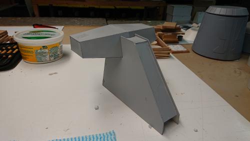

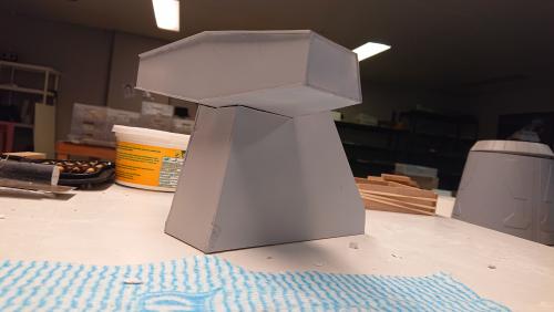

Started working on the Bridge this afternoon.
I have to thank Julien for being a massive influesnce.
Eric Ckwanwoo, Isel & all the guys at the RPF for what they have done working on there projects.
Without there work I would not attempt this project.
I have started mocking it up in 1mm Styrene that I went & got from the storage shed.
I only have one kit that got delivered the other day for sizing which is the Fujimi M4A1 Sherman.
Looks like theres at least 3-4 of them used on the Bridge.
I am waiting for the Scharnhorst & Ticonderoga to arrive hopefully any day which will help with the scaling.
I hope to have my printer set up soon & will do as Isel did by printing the picture up until I can sit the pieces on flush. That should make it very accurate.
im just bored & need something to do.
Im relatively happy with what I did today & will just refine it over the next weeks until its right.
I will then post Templates for other modelers to use if they choose to have a crack at building this model.
Its currently held together with sticky tape so is a wonky & unsecured.

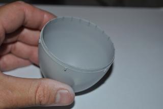

Just ordered my 30mm Crystal door Knobs from here thanks to Pharchivast at the RPF.
http://www.myknobs.com/calcryscrysk5.html
Can't wait to get these!

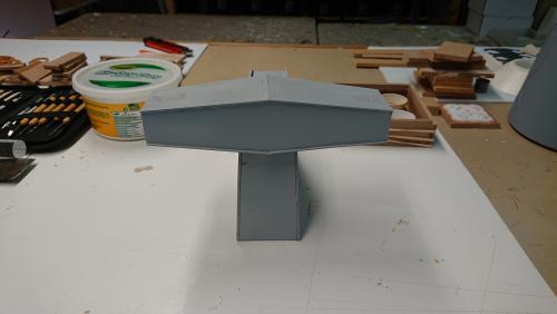

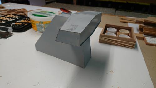

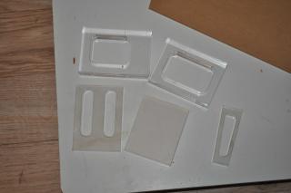

RE: SS ANH ISD DEVESTATOR - JAWS - 12-26-2010
Thanks Julien & Isel.

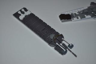

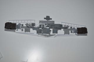

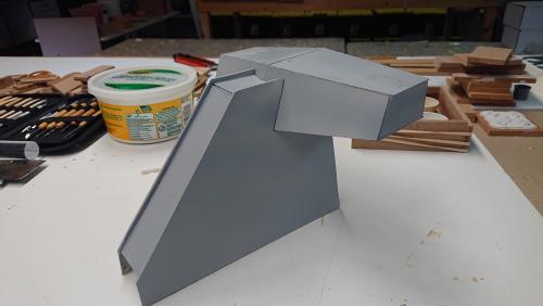

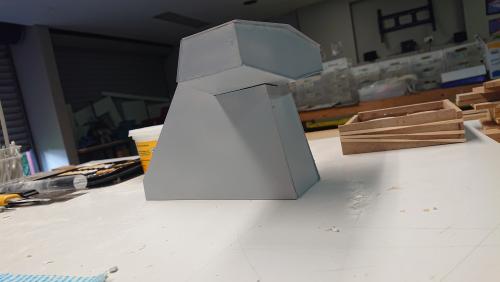

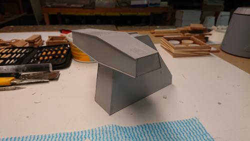

Did a little more today.
Working on the neck now.
These are just rough ups done with some spare 1mm Styrene.
I'll work with this until Im happy with the scaling & dimensions.
Its very challenging for someone like myself thats not very good at maths.
So Im learning alot as I go in rega5rds to 'extrapolation'.
Found a good site & got some very cheap Fujimi M4A1 Shermans.
$8.00 each + $16.00 shipping.
Can't wait to cut the little suckers up....

RE: SS ANH ISD DEVESTATOR - darkimmitator - 12-26-2010
Looks like a star destroyer bridge to me . lookin pretty darn good in fact !!! Nice job Jase !!!

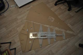

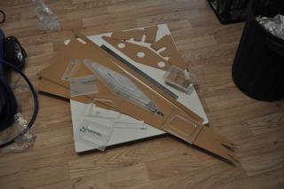

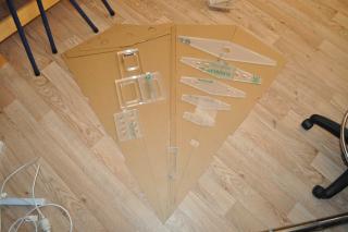

RE: SS ANH ISD DEVESTATOR - JAWS - 02-13-2011
Hey everyone I finally got a computer to get back into it. Ive printed up a front on picture of the Bridge face to measure up for the plans. I will use this method to draw up the plans for the whole ship & cross ref with extrapolation of parts measurements.
I have a few parts to size up & will slowly accumulate the rest.
I need to concentrate on bying a house so my expenditure on models has to decrease considerabley.
My Domes never arrived either so have to reorder some....
Any way heres some pics of this slow project.

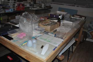

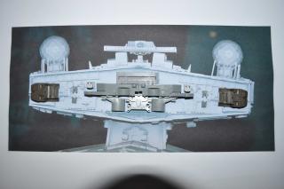

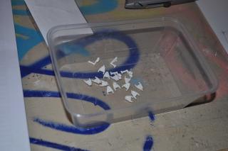

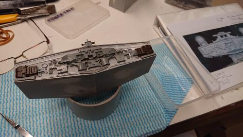

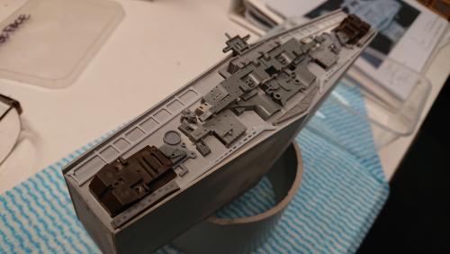

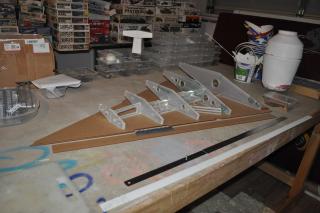

RE: SS ANH ISD DEVESTATOR - JAWS - 03-07-2011

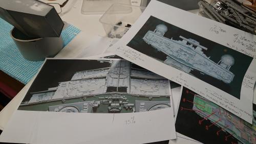

Ok have been back at this aswell as a coupleof other projects.
Have developed a system of sizing up reference pictures to actual scale of studio models.
This relieves alot of guess work & stress obviously.
I have started with the Head & moved on to the neck & rear structure sections.
I will move around as I go.
So have used kit parts & measurements in Adobe Photoshop to produce printouts of scaled copies of studio model sections.
Its not perfect & every photo has its own requirements.
I have so far successfully scaled up the Bridge face, Port & Starborad sides, Portside & starboard side Neck Panels.
I am furiously working on the manin Hull Structure & Upper Body Structures.
I will now use the print outs as templates to cut & scribe the panels.

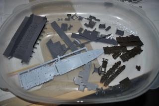

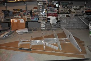

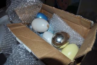

Heres some pics of whats been going on inbetween.
RE: SS ANH ISD DEVESTATOR - star-art - 03-08-2011
This is looking great! I had started working on one of these before the G way back in 1996 or so but I gave up due to lack of reference. Since then, I was lucky to actually see this model in person at one of the exhibits. It is a glorious miniature, that's for sure. This was the ship that I liked the most in SW.
When I first started making drawings, I assumed the "three foot" figure as did most people based on the information available at the time. I concentrated on building a 1/2-size mockup which just happened to be about the same size as the ERTL kit of the ESB model. Later I scaled up the plans to what I thought was full size and then started laying parts on it. I was shocked to find my drawings were WAY too small.
My best guess has this model about 54 inches long and nearly three feet ACROSS at the back end! That's as far as I got with the plans as Galactica took over all my time after that.
RE: SS ANH ISD DEVESTATOR - JAWS - 03-08-2011
Thanks Charles.
Since yourve got the G wrapped up maybe you can spend a little time with me on this?
Using Erics method of measuring with the 8 Radd piece we get pretty much 1216mm Length & around 760mm Width.
Outer front edges around 1109mm from nose to back point & bottom trailing edges around 456mm from side point to end point.
Thats rough right now.
Im actually trying to scale a picture up to lay a few parts on.
Have also been working on the upperstructure measurements & hope to cut some mock ups this week.
I haven't looked at this model since at least 2005. The only thing I could do is build a quick and dirty mockup in 3D to try and nail the shape. From that, plans can be generated that can be used to confirm dimensions. I don't recall exactly how I came up with a length, but I believe it was by measuring the large notch where the 8RAD part sits. Since that part is recessed inside, it's easy to misinterpret the exact dimensions of that notch. Everything else is based on that.
Yep thats the part I used.
The first picture was taken from a Thread at the RPF.
[attachment=7408]
The next picture is the total length of the 8 rad part
[attachment=7410]
The next picture is the inner measurement of the 8 Rad part which is what Eric used to scale his build.
[attachment=7409]
These are the best reference I can locate for now.
We can clearly see in the Portside 8 Rad piece that one end of the 8 Rad part has been removed.
This reduces the length of the 8 Rad part from 16.2cm(162mm) to 15.7cm(157mm).
We should be able to us that length to measure up the centre dimension, outer edges & tip to tip to give us a pretty accurate scale.

Dont suppose you have any Leggs Eggs you can give me the diameters of?
Jason,
Sorry. No I don't have any Leggs eggs to measure for you, and you are most welcome as well as always Smile
Richard

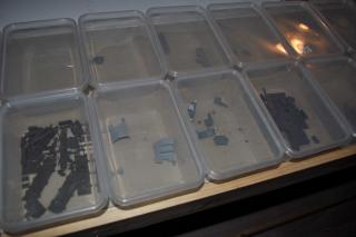

RE: SS ANH ISD DEVESTATOR - JAWS - 04-04-2011
All good. I scored 14 of the buggers luckilly so I think Im covered for a few builds.
Thanks Richard.
Ive been so submerged in iding parts I haven't had much structural progress.
Its my day off today so hopefully can get something done.

After cleaning up the work shop & moving away from the ever frustrating Battlestar build moved over to check out these famous L'eggz Eggs.
I was lucky to score 14 of them so have a good stock for some SS builds.
I decided to clean one up & give a coate of primer.
I then wanted to check out the construction of the engine bells on the studio model.
Looking at the reference I have it looks to be T Strip running down the outside & C Strip used on the inside.
The thing is Im unsure as some pics it looks like T Strip on the inside...
My vision is just not as good as it once was.
Might have to get my eyes checked(yes I have not done that yet...)
Anyway I have determined the inside strips need to be 0.875mm apart to fit 24 ribs around the L'eggz Eggs evenly.

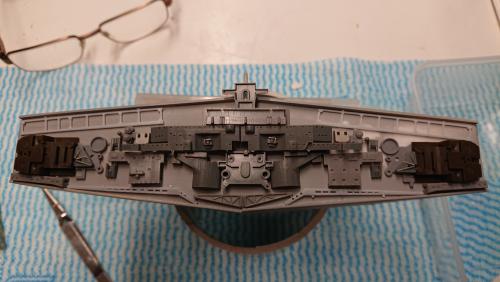

Well I wanted to start seeing some fruits for my labour so decided to start cutting up a second go at the templates for the Bridge.
Ive cut the face 3 times already. The angles are slight so its hard to get nice sharp points in the centres.
Again this maodel is not totally symetrical.
It was apparently one of the last models to be built for A New Hope. Only missing the 4 parts from the Le Seine Fueler.

I have my own thoughts on the wedge hull dimensions, which I am planning to build my third model to. You learn a lot about this filming model when you build it multiple times based on the countless photos of it, then referring back to those photos to see where you are off and by how much. When I built my second destroyer, I improved on many of the things I did wrong on the first, but then found new areas to improve.
The bridge and all the structures that proceed it on the real thing come to a length of about 23-1/2" to 24". The real thing is between 13-3/4" to 14" at its wides point. This is based on what I have been able to build so far. Mine is 23-1/2" long by 13-3/4" wide. I am giving a margin of error, as I can't say this is exactly what the real thing is, but it is very, very close. Knowing this much gives you an advantage in more closely figuring out the length and width of the wedge.
In my experience building two and a half star destroyers, I believe the length of the filming model to be between 48" and 50", and the width to be between 28" and 30". I am leaning in the direction of 48" x 30". I've already built a very accurately proportioned hull in my second replica. Even though it is at 3' long, when I go into the computer and scale it up to 48" (or 4' long), it closely matches what I have already built for the third. Any larger and it would look way off (to me, I should add). Even if it is a bit too short, it will still look right. When it is too long, that's when it becomes painfully obvious.
Anyway, There are other reasons why I believe it to be so. Actually, one of them was pictured in this thread. The one of the frame of the model on the work bench. Perhaps it was always called the 3 footer because maybe that's how long the frame is (give or take, it's not much longer)? Adding how much the nose and tail extend fore and aft from that and what do you get? I'm not saying it definitely IS 48" long. The only way to know for sure is to measure the real thing, or ask one of the ILM guys who worked on it. I plan to do one of these.
So, if you are still reading my ramblings to this point, then you are as interested in finding out as I am. At any rate, I hope this helps, or at least gives you something new to think about.

Rick thanks. Im still reading & will continue to follow whatever you have to say. The only reason haven't started constructing the suoer structure is to make sure I get it as close as possible. Youve done a great job & this build is definately going to be between the 50 & 51" inch mark. I also wanted to Id & collect as many kits as I could before starting. These to use help get the dims right also. Im sure with us all helping each other we'll come up with the most accurate builds we can.
I recieved a package from my new friend Alan Anderson last night. He sent me some draw pulls. Their tiny.. Always imagine this stuff in real scale & when you get down to the basics the reality kicks in Big Grin Thanks Alan.
RE: SS ANH ISD DEVESTATOR - JAWS - 04-11-2011

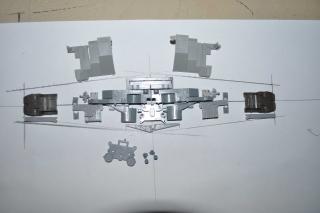

In between making some moulds that should have got done yesterday Confused
I decided it was time to get the Panther G chasis shaped up.
In getting the part to be whats need the sides had to be removed.
That was easy enugh with some clipper.
Then it had to have what was left of the walls sanded away so it just left the little knobby bits on the inside.
I statted to do the sanding on the sanding belt & quickly stopped when Isaw the plastic start to melt & warp!
No short cuts for this stuff....
Its to valuable toi make a mistake that would render the part unuseable Sad
So sanded it back the old fashion way.
Slowly Dodgy
It took almost an hour to remove the sides & just leave the inside mounts attached Big Grin
This will be a 'Master' as is needed twice for the neck & twice for the bay.

RE: SS ANH ISD DEVESTATOR - JAWS - 04-22-2011
Har ha ha! Funny French man.

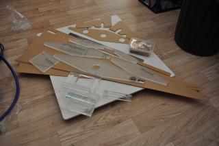

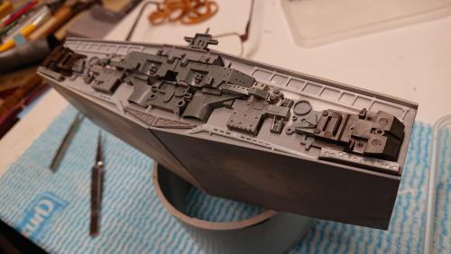

I bought a sheet of 2mm styrene to start mocking up.
I believe the hulls & syructures are 2mm acrylic on the studio model. This will be a rsearch run to get the dims sorted. I may build 2 replicas.
RE: SS ANH ISD DEVESTATOR - scratchy - 04-22-2011
Nice looking work Jase, the Devastor really is coming together nicely. Sweet score on the "L'Eggs"!
Thanks Jay. Im having alot of fin with this build when i get time for it. Was hoping my kits with the last parts i needed for the head, neck & rear structure walls would arrive yesterday though didn't. With the long weekend for Easter there won't be any deliveries until next Tuesday. So it will definately be a loooong weeeekend.....

The hull thickness is critical on the edges (i.e. brim trenches). Word has it they used a brass "U" channel to trim the edges and it looks like a pretty tight fit. Some really thin strip styrene was then glued onto that. I don't recommend using any styrene here as it will warp over time. Better to use metal if you can find a practical way to put notches in it.
RE: SS ANH ISD DEVESTATOR - JAWS - 04-28-2011
My package arrived yesterday. The last 10 kits needed to have all the correct details for the head, neck & rear structure walls. I can now finally move around to the portside structure walls that I have(with some help) got about 80% identified. If not a little more. Update soon.
