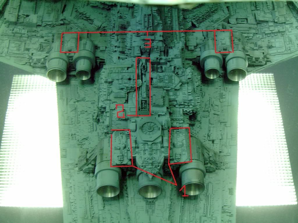

After a long time, I study executor. I will try to build Executor, studioscale dimensions. I don't know if it's possible to build a perfect studioscale, because too much parts : plasticard cut, kit parts... But I will try...
Executor measures 280x90x30cm, but a friend say measures in the book "Chronicle" are fake...
Thanks at man to the Executor pictures place in web and here with kits scan. About kits used by ILM, on the top, I indentified at this time battleship Tamiya 1/700 scale :
http://www.studioscalemodelers.com/forums/showthread.php?tid=1244
Tamiya-(1/700)-U.S Aircraft Carrier Enterprise(AT-AT per Monsieur Tox)
Tamiya-(1/700)-U.S Aircraft Carrier Hornet(Millennium Falcon per Monsieur Tox)
Tamiya-(1/700)-HMS Rodney(ISD:ESB per Monsieur Tox)
Tamiya-(1/700)-Hood(Millennium Falcon per Monsieur Tox)
Tamiya-(1/700)-King George V(ISD:ESB per Monsieur Tox)
Tamiya-(1/700)-Nelson(ISD:ESB per Monsieur Tox)
Tamiya-(1/700)-Prince Of Wales(AT-ST per Monsieur Tox)
Tamiya-(1/700)-Taiho(AT-ST per qcfoundry)
Tamiya-(1/700)-Gneisenau(TIE Bomber per Monsieur Tox)
Tamiya-(1/700)-Scharnhorst(TIE Bomber per Monsieur Tox)
Tamiya-(1/700)-Junyo(TIE Bomber per Monsieur Tox)
Tamiya-(1/700)-Kumano(Millennium Falcon per Monsieur Tox)
Tamiya-(1/700)-Shinano(vintage) (AT-AT per Monsieur Tox)
Tamiya-(1/700)-Yamato (vintage)(ISD:ESB per Monsieur Tox)
- Tamiya SDKFZ 223 1/35
- Tamiya 88mmGunFlak36/37 1/35
- Roco Flagpanzer gepard 1/87
To underside, some tank kit 1/87 scale :
1 : marder 1A2
3 : jagdpanzer kanone
and Flagpanzer gepard
Tamiya 1/35 scale :
2 : SDKFZ 232
jagdpanzerV jagdpanther
1/144 Saturn V

RE: Executor - leukirix - 03-05-2012
ThanksSmile
I see marder 1A2 1/35 scale Tamiya... About part n°1 picture above, it would marder 1A2 but 1/72 scale, but what model ? Revell ? Italery ? I don't search in web... Confused
What do you think ?
RE: Executor - MonsieurTox - 03-05-2012
This is really a cool model to ID and it's not that hard because most of the models are common to the Star Destroyer.
You'll need several Revell Midway carriers (1/542), unfortunatly it's OOP (and I bought them all for my Star Destroyer TongueP).
You also need several 1/87 Roco Gepard (easy to find).
The big problem on this one is the lack of reference :/ And all styrene strips with cutout that were cut by a machine, I would use a vinyl plotter, draw several pattern in illustrator or corel draw then get thousand of strips cut !
Best of luck for this one Franck ! Smile
RE: Executor - leukirix - 03-06-2012
Thanks Julien,
I ask me what are the long parts, I had seen several boats, but I don't find Revell Midway 1/542 scale, thank you. I correct gepar flakpanzer 1/35 Tamiya > 1/87 Roco Gepard. I drew the plans, I have Gepar flak turret 1/35, and I didn't check... Mdrr !
I search marder 1A2 1/72 (1/76) scale, but I find Revel marder 1A3 l/72 scale... May be 1/87 Herpa/Roco ??
But Roco model are kits with parts or die cast ??
I find Big Grin part n°3 : jagdpanzerkanone 1/87 Roco...Tongue
