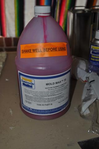

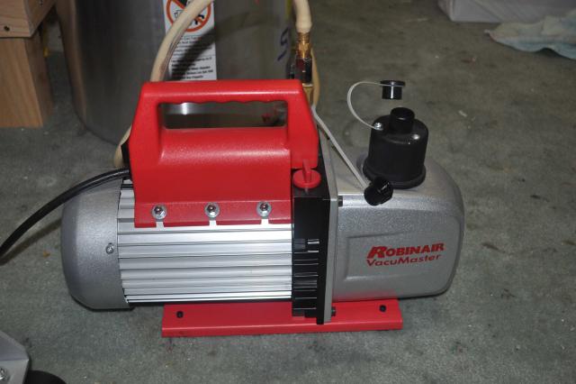

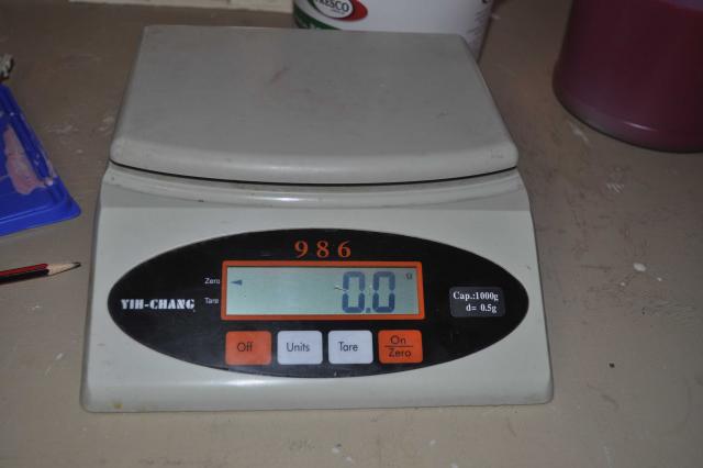

Equipment - JAWS - 12-14-2009 Ok heres the equipment I bought to mainly stop expensive kits having to be sacrificed. Spend money to save money was the idea & I just thought this looked like a lot of fun that had rewards. Vaccuum Chamber on left & Pressure Chamber on right. Both were bought through Sooth-On. [attachment=1204] The Vaccuum chamber requires a Vaccuum Pump. A Vaccuum Pump is used by Refrigirator & Air Conditioniner technicians to suck out harmful gasses etc. It is recommeneded that the Vaccuum Pump pulls 29"mercury & has a minimum flow rating of 8cfm. [attachment=1205] The next thing you need for Moulds is rubber. I use Mold Max 30 from Smooth-On. Soft but firm. Part A [attachment=1206] Part B [attachment=1207] You need digital scales as you have a mix ratio of 100A to 10B [attachment=1208] You will also need plenty of these. Lucky I have an unlimited supply from work. [attachment=1209] RE: Equipment - kbilly - 12-14-2009 Wow that's a pretty mean setup you've got there... you must be pretty stoked. RE: Equipment - JAWS - 12-14-2009 Its great. I invested in something thats rewading & fun. Got some big projects that are personal builds but am also going to get a couple of 'good masters' to produce hopefully. No rush. RE: Equipment - treker2557 - 03-16-2010 That's a nice setup you have. I just purchased a 5 and 10 gallon pressure pot and then just making lids from Lexan for the vacuum chambers. I was wondering if you know what is the size vacuum pumps I need for a 5 and 10 gallon pot. I was hoping to be able to just buy a 6 cfm pump for now to use with the 5 gallon pot and get a larger one later since they are so expensive. RE: Equipment - DarthDuck - 03-16-2010 Jase, Not only is that always cool but Jeez man- you could really get something going since there are so many hardcore modelers down under and you can cut out some big shipping for them! Who knows- maybe someday the US (and elsewhere?) kit makers will co-op with you and send a master your way for just that reason. To reach the Pacific rim market at a lower overall cost???? Just thinking out loud? But no matter what it is certainly cool!
