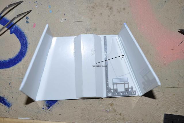

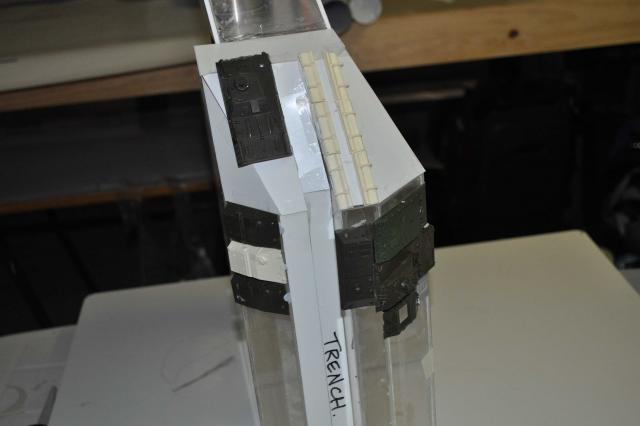

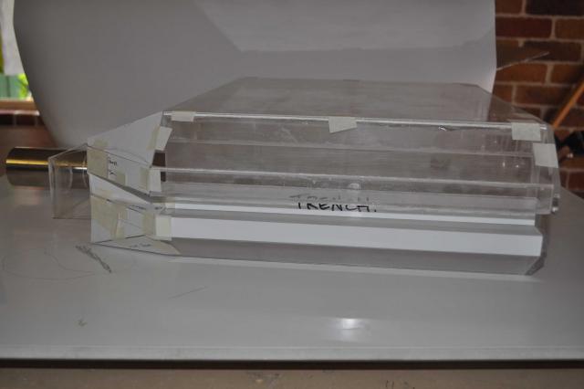

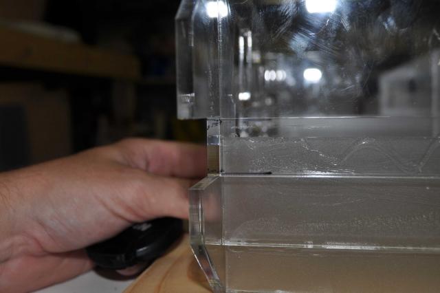

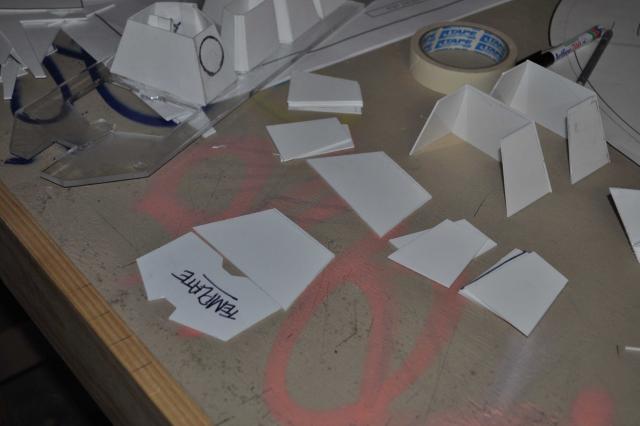

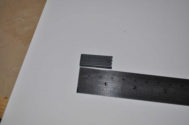

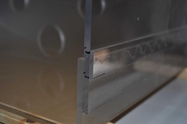

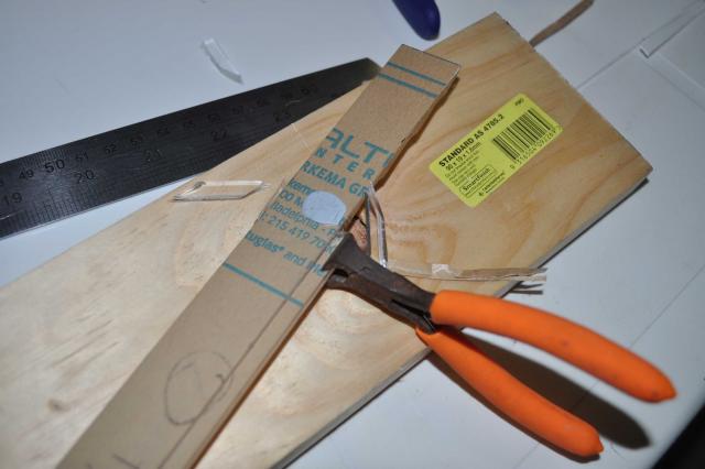

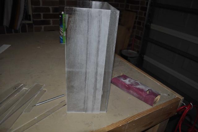

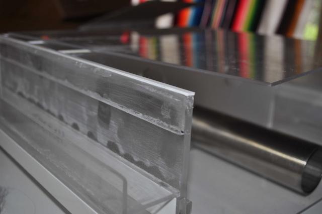

So amoungst the C Channel & T Strip I grabbed 2 sizes of T Strip that I thought may be right for the wall. I got 4.8mm& 6.4mm T Strip & they have the long section thats the same as on the original Battlestar. Im thinking its the 4.8mm that was used but would like to know if any of you guys know for sure. I also picked up an assortment of C Channel. I also would like to know which C Channel you guys think or know was used in the edges of the ports & which one? Theres the deep C Channel then theres the C Channel with the short sides 'Fine line Styrene Channels'. Looking at the picture I think its the 2.4mm 'Fine line Styrene Channel'. But Ive been wrong before.
PLEASE READ PREVIOUS POST FOR QUESTIONS

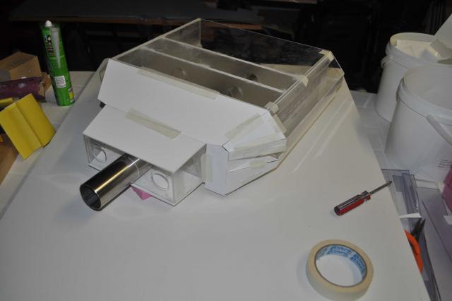

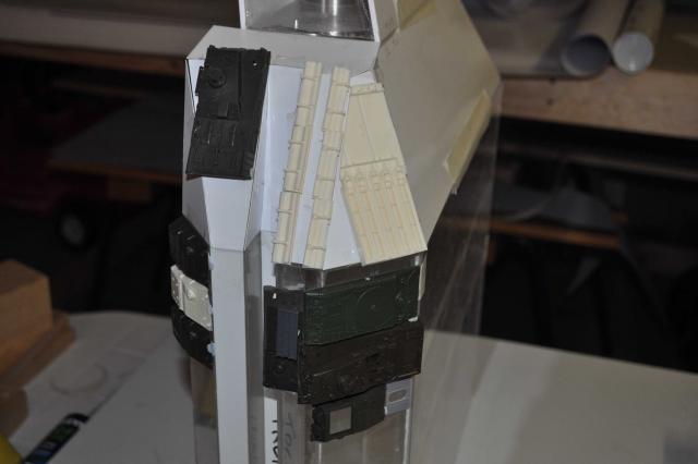

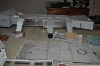

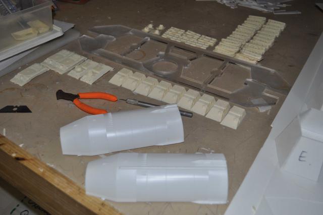

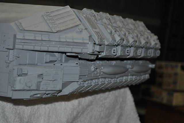

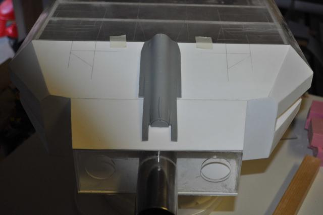

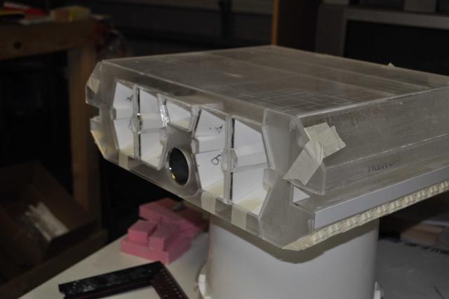

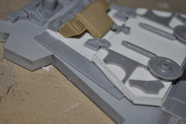

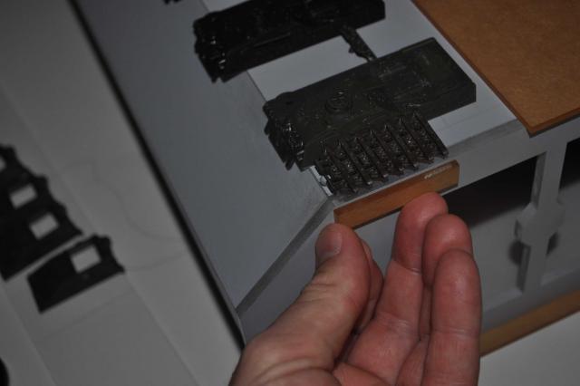

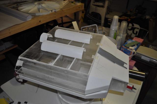

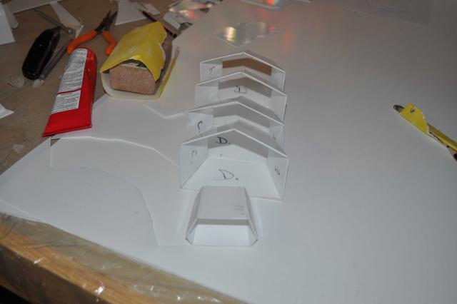

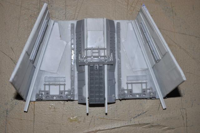

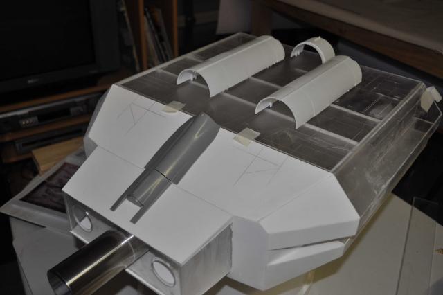

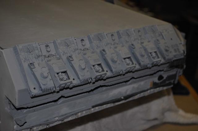

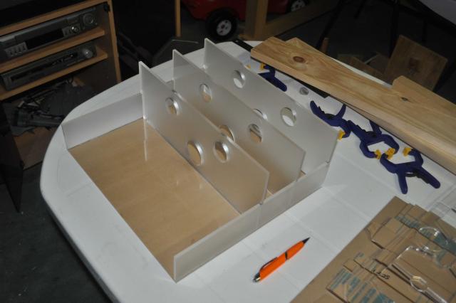

Ok finishing off my big day with some expensive test fits. Nothings cut exact except the Saturn V parts. Some other parts to get fitted soon ![]() On the paerts maps for the top deck #13? Do we know what that is???
05-26-2010, 09:46 PM

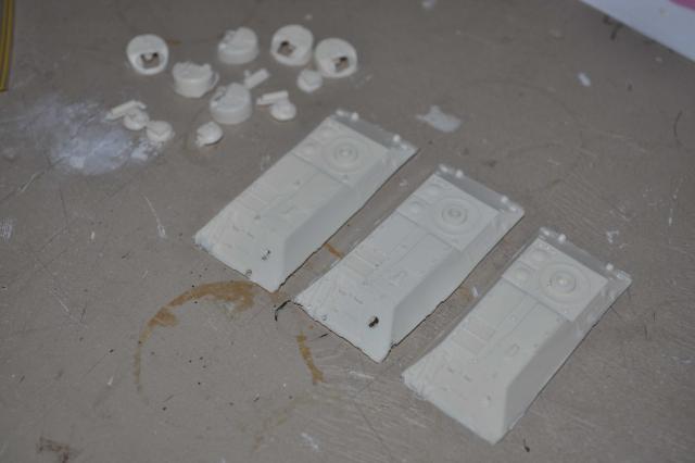

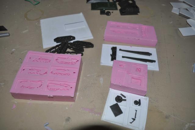

Jason,

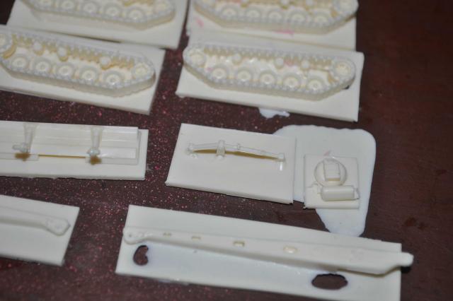

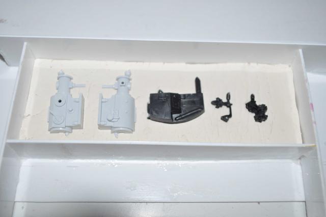

Have you molded the big 1/8 Entex JPS parts? Please do so before you glue them down. I would like to have a set made as soon as I figure out what parts are needed. Thanks Richard
05-27-2010, 12:34 AM
Lookin Good there Jase !!!! And if you are making castings of the 1:8 Jps lotus ,You could put me down for the front steering rack ,located on the engine top between the two saturn v halves ,and has the two antenae or dishes on it.
Fear gets you killed
05-27-2010, 06:32 AM
No problem boys. That is one part that is getting moulded pretty soon so don't worry. The 1/12 JPS fits in the Saturn V part perfect with the 1/8 over the top. I have a Phantom engine that Phil sent & will also be moulded as soon as possible. Theres only couple of small parts I really need for the top. Phils sent everything he had & together pretty much covers it.
05-27-2010, 07:22 AM
I like the look of that very much!!
Man that really does look good,even just layed outI'm lLooking forward to getting to that area real soon myself. Nice work there my fellow G builder!!

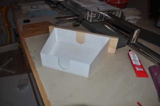

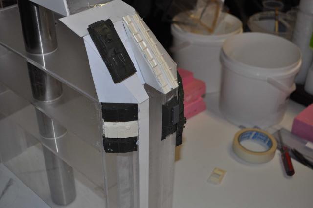

(05-26-2010, 09:17 PM)jasonwright.1972 Wrote: PLEASE READ PREVIOUS POST FOR QUESTIONS Jase I think the consensus on # 13 is that it's a scratch built box. At least thats what everybody told me. I don't see any detail on it, that would say kit part. Cheers, Joe
05-27-2010, 08:04 AM
(05-27-2010, 07:36 AM)bwayne64 Wrote:(05-26-2010, 09:17 PM)jasonwright.1972 Wrote: PLEASE READ PREVIOUS POST FOR QUESTIONS (05-27-2010, 08:04 AM)jasonwright.1972 Wrote: Ok Joe I couldn't make anything out either. Maybe if Ken speaks with Jason again he could ask what they did. Jase I know there was a thread at the RI on the trench tee. I think I asked about it before. But can't find the darn thing, LOL. Here's a pic I did on this question. It's from the public domain pics # 52. If you know which part that is with the arrow, the tee strip is just a bit less tall than that part. I don't know the part, so this might be of no help, I'm leaning toward the 1/4 inch base, I guess that would be the 4.8 mm ,Cheers,Joe
05-27-2010, 09:19 AM
Jason,
That T-bar is the dark gray T-8 ABS 1/4" Tee from Plastruct. Richard
05-27-2010, 09:24 AM
Oops, what he said, that would be 6.4 mm. I should have paid attention in math class, LOL
Sweet. Thanks Richard your the Battlestar Wiki!
Sorry, also thanks Joe!

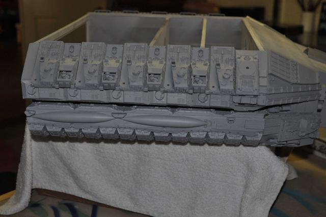

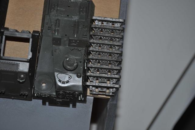

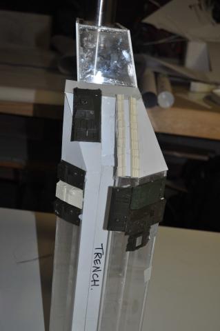

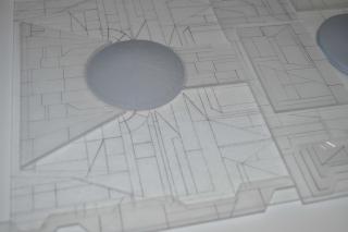

Are there 215 tracks behind the lower 211's? So question is are the 215 tracks on the trench ceiling & floor or just the ceiling?
(05-27-2010, 09:24 AM)jasonwright.1972 Wrote: Sweet. Thanks Richard your the Battlestar Wiki! No problem man. Richard is the Battlestar Wiki. I'm just a mini Wiki, ![]() Jase I don't think there are any tracks on the floor. As you probably know the floor and ceiling don't go all the way in. There is a gap there, probably for cooling. The Ceiling is wider than the floor also, so there was room for the tracks, on the ceiling. I think it's too narrow on the floor, the way they built it. I tried to find a good picture of this, but couldn't find one that shows the trench floor. Hope this helps, Joe
05-29-2010, 05:45 PM
(05-29-2010, 03:40 PM)jasonwright.1972 Wrote: Are there 215 tracks behind the lower 211's? So question is are the 215 tracks on the trench ceiling & floor or just the ceiling? Jason, The lower trench floor part stops short at the inner half of the 254, (it is just as wide as half the 254) this means there is no room for them on the original. Just put them on the upper one and you are finished with it. ![]() Richard

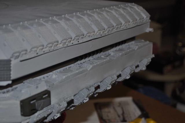

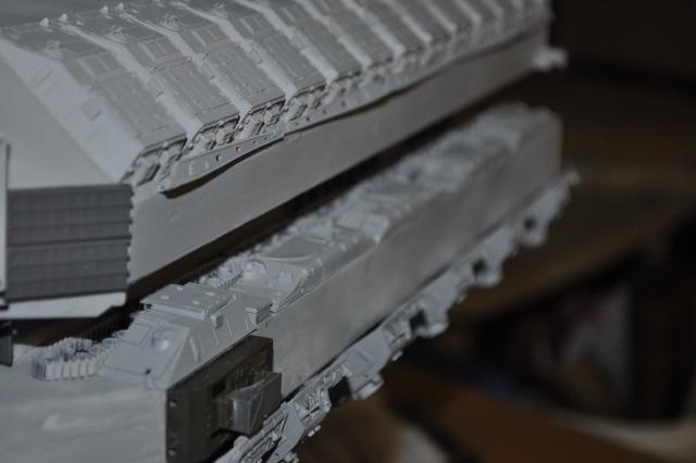

Looks pretty sharp Jase. Let us know when you find an alternative to the Tamiya primer. I've been using, wait for it, DULUX grey metal primer on most of my builds! Comes in a big 325g can, goes on pretty heavy but dries down very nicely to a finish halfway between satin and gloss, a very hard enamel finish. So far no reaction issues with styrene, filler or kit parts, but things are a little tricky to glue onto it. Scribes without cracking, but man does it stink when it's going off!

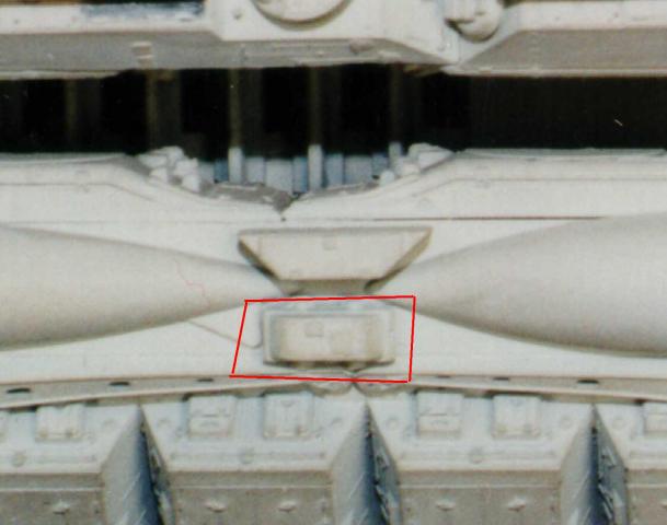

(05-27-2010, 09:07 AM)bwayne64 Wrote:Does anyone know what the part with the arrow is? Also the part above it?(05-27-2010, 08:04 AM)jasonwright.1972 Wrote: Ok Joe I couldn't make anything out either. Maybe if Ken speaks with Jason again he could ask what they did.
06-01-2010, 10:34 AM
Jason,
I have no clue! I am not even sure there is a good picture of that part even. I will search through my kitlist notes and get back to you on it. Richard

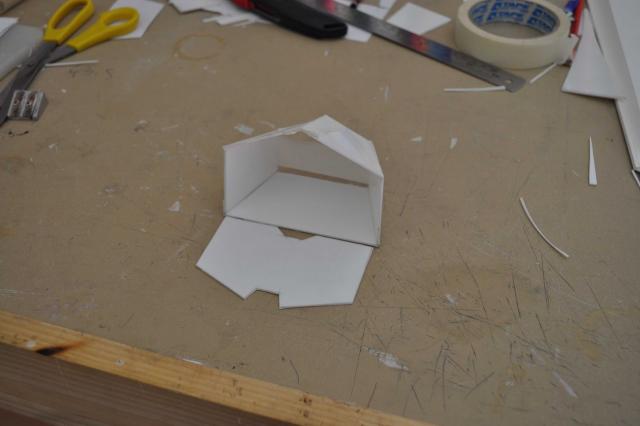

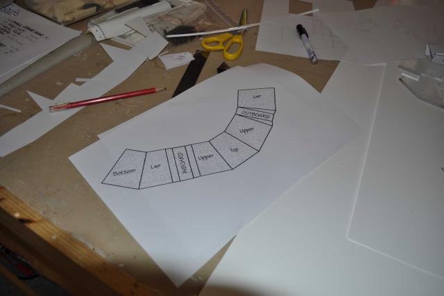

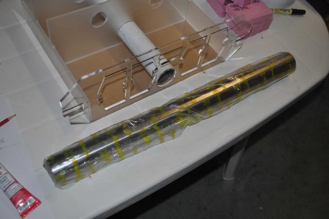

Ok how many Engine Ports can we do with a 2ft sheet? im thinking just off my head at the size of the openings a rectangled piece 250mm x 120mm divided by 2ftsq should give us like 6 pieces? So what about $83 each.... Oh & my maths skills are basic to say the least.

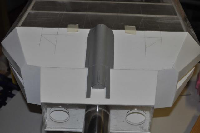

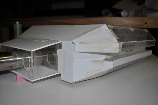

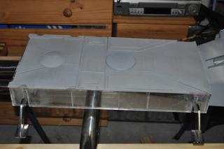

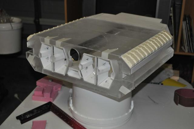

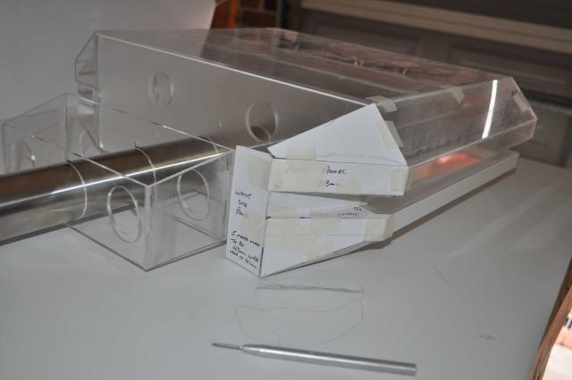

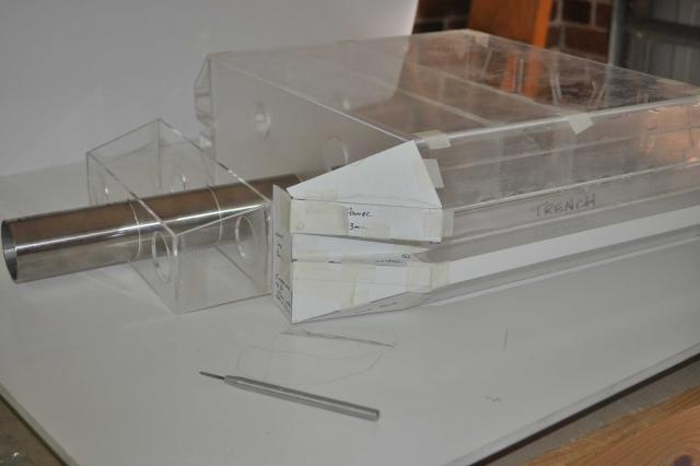

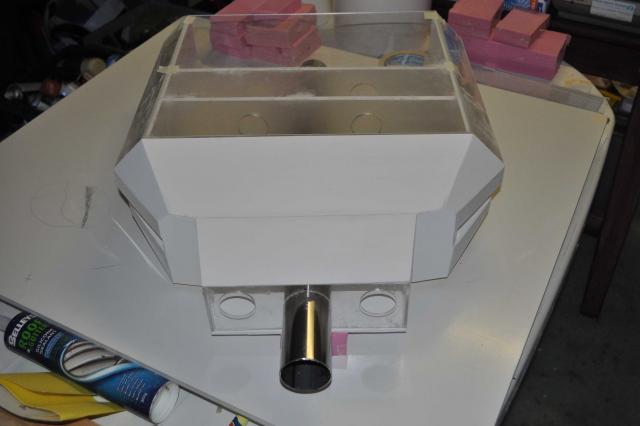

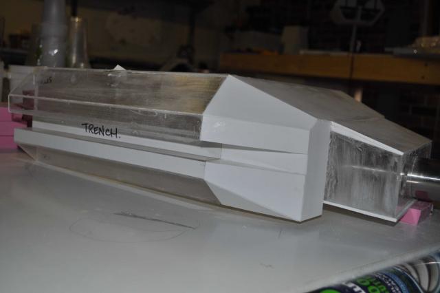

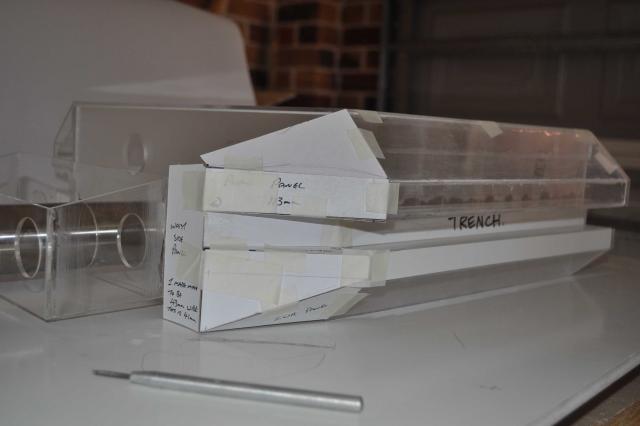

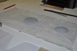

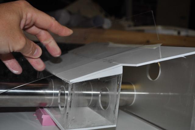

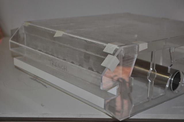

Not much to show this week. Ive just discovered the engine box is between 15-25mm to short... Oh well thought Id try setching up my port plating patern to keep my occupied & away from the heavy tools that can do lots of destructive damage

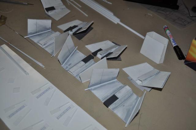

Its just a rough to get the main plates fit inside my ports. I'll add the small chips once Ive got these large parts down. There far from 'accurate' but should look ok once cut & glued in.
Oh they'll they look great,trust me!
![]() Well mate,i've been pretty bumbed out over that bit of news.I was almost ready just to give it up for a bit infact.I really just don't wanna start again!So it's do just that or extend the whole section by what it is short.Now i think your 15-25mm is a bit more than it actually is.From measuring it up and taking in the backplate allowance it's more like 9mm.Least thats what i'm working out here.now that is still a lot but i think we can just extend the end really.There will be no load on it as we can have the backplate mount blocks attached the the sections we have already got built.Thus the backplate is held by that section,not the 9mm extension.That extension will be pretty much covered all over by part's so nothing is really gonna show.Infact it'll only need putty in certain places that will be visable. We will have to scribe another top lid though. ![]() Anyway fuck it,i've come too far to give up with it now and will get some acrylic tomorrow cut into 9mm strips that i'll use to make up that shortage. Hopefully it'll all work out!
06-03-2010, 06:12 AM
Yeah Im hearin ya mate. I was lookin at it last night & sayin "I am not rebuildin that basdard!"....... I had the same thoughts for the extensions & a new lid. So guess I'll make some measurements with some extras for joining supports & get ready for another putty run.
06-03-2010, 09:04 AM
(06-03-2010, 06:12 AM)jasonwright.1972 Wrote: Yeah Im hearin ya mate. I was lookin at it last night & sayin "I am not rebuildin that basdard!"....... I had the same thoughts for the extensions & a new lid. So guess I'll make some measurements with some extras for joining supports & get ready for another putty run. Jason, Make it 352.5 mm or 13 7/8" and it will be the correct length. Richard
06-03-2010, 09:46 AM
I hear you guys and your pain .I have to make a new top plate as well because of having to shorten the front slope and fixing the side slopes to be more square .

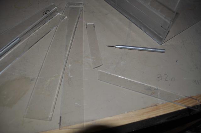

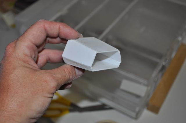

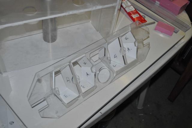

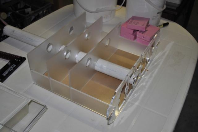

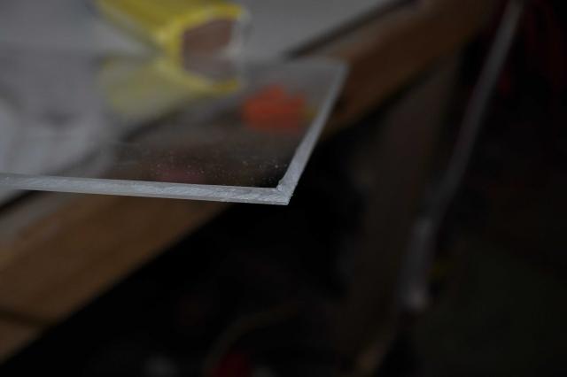

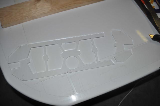

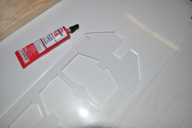

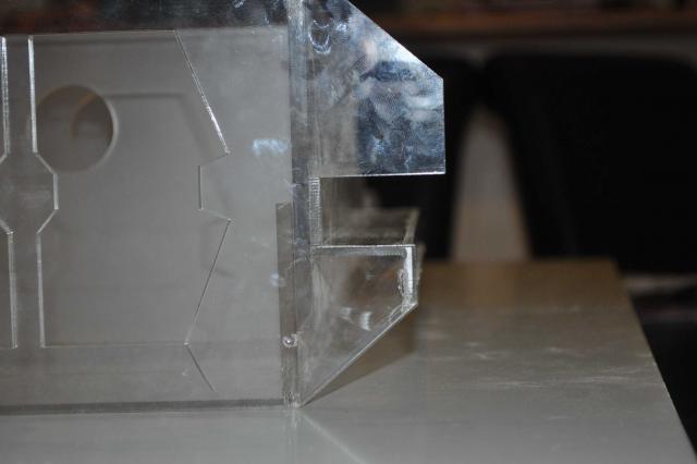

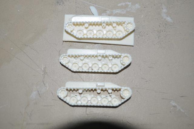

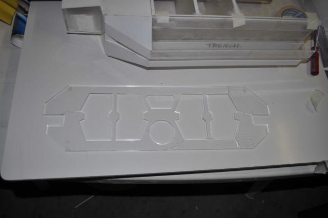

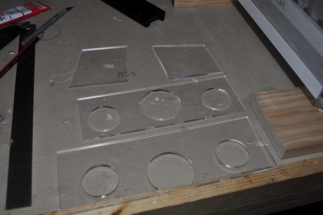

Thanks Ken but things will be better very shortly! Just got back from the plastic supplier who laser cut my extension pieces & new lid
Very happy as he laser cut them for complete accuracy. These guys have been lookin after me very well which is really kool. Anyway new lid, extension pieces for botton & sides & the rest of my Roco's arrived also. The Rocos arrived at the right time to get this all sorted. Its funny how these hitches pop up but things always work out for the better in the end. Check out these kool old school boxes they came in with my favourite all time Military Vehicle on the top.

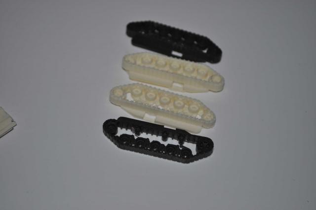

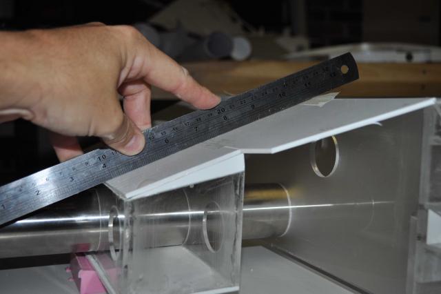

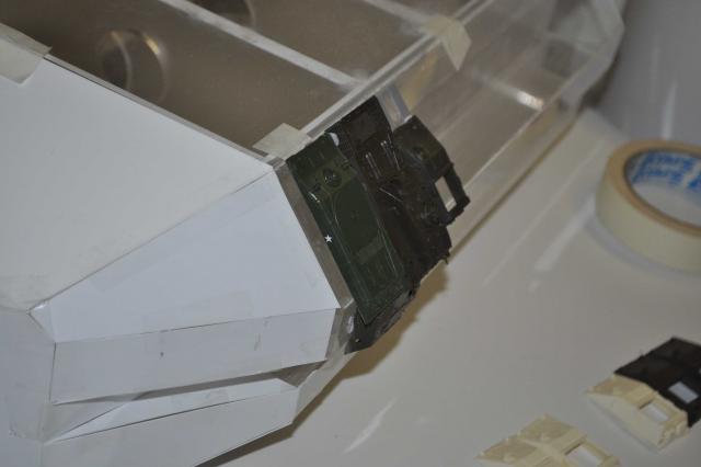

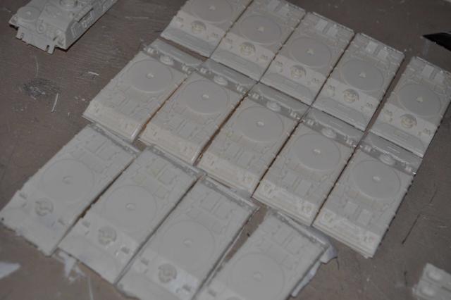

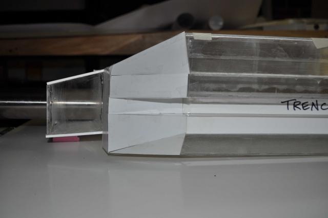

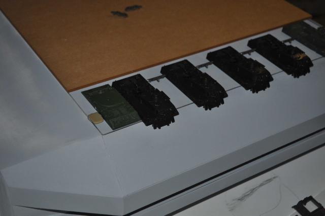

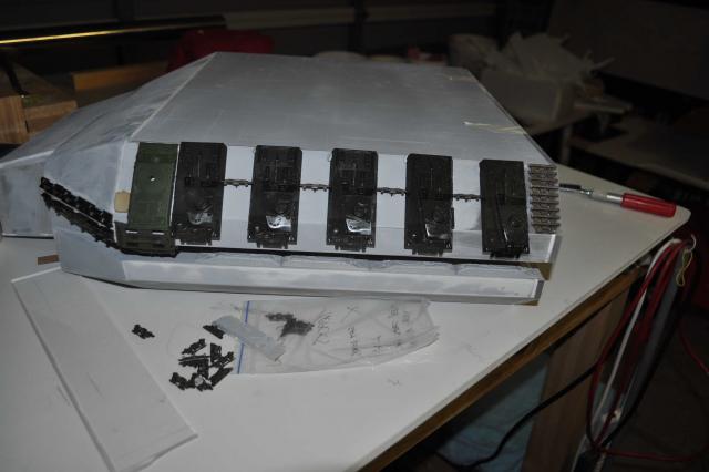

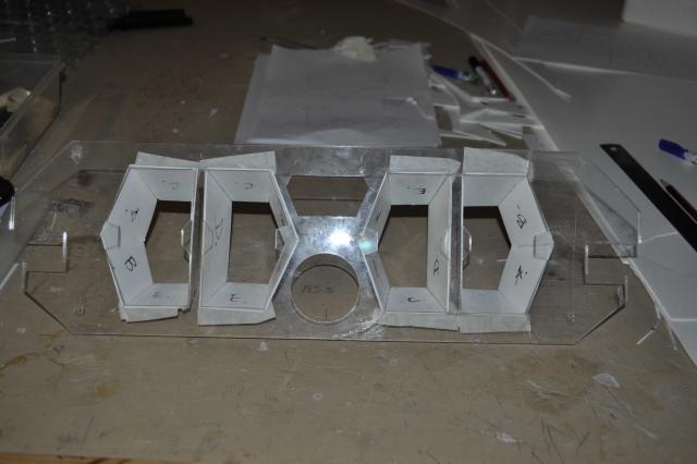

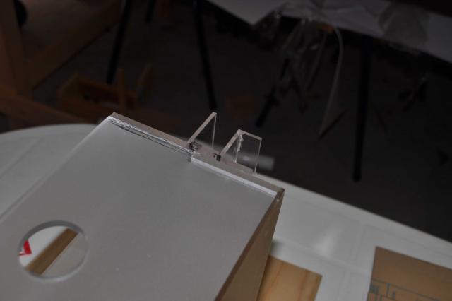

Yeah half my luck. Ok got the Roco's lined up for test fit. I went with what Phil said but added 1mm & got 10mm extensions. After fitting the pieces Richard would be spot on with 352.5mm. So Im 2.5mm off which would take in the lil bits of Centurion track & move the Quad Gun Tractor seat over just a smidge to be accurate.
I have to wait til next week when I get paid to get another set cut.
06-03-2010, 07:11 PM

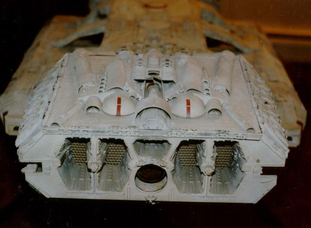

Ok a revision from last post. I went back to the Pappas pictures & if you look at GalRes682 you can see the Centurion tracks are raised off the slop & right up close to the 257 hull. This brings it in almost perfect
Unfortunately this makes Richards estimate incorrect. My Back plate is 5mm thick. The new lid is cut at 350mm. The lid at 350mm + 5mm plate is exactly 355mm. Also remember the Centurion seat at the front of the slope was moved over 1-2mm to try & fit all the parts on. Phil I would get yours cut at 356-357mm & that will be spot on buddy. I can live with what I have which is maybe a little over a 1mm shortness

Jason,
Don't forget that there is overlap of the 215's and the 257's to account for too. You might come out too long at 357 mm. I gave you just under an 1/8th inch wiggle room at 352.5 mine is tighter at 349.5 mm exactly overall. Richard
06-03-2010, 08:08 PM
Ok. That is correct they do sit up a little on the 257's. Damn these buggers. Im happier having a little more rather than a little less though.
